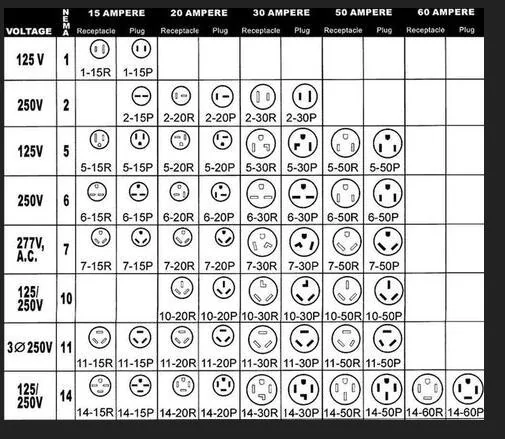

This is absolutely false, please be careful when making assumptions about electrical standards, it can be dangerous. The NEMA standard numbers tell us a lot, so at a glance, you can know that "14" is 240v and a certain layout, with ground, two hots, and a neutral.
14-30 can be either 240 or 120 volts.
RV parks tend to have 14-30 wired as 120 volts
Of course, they all can be. The "14" standard allows for both.
Never seen it, but of course that doesn't mean it can't happen. It should not be stated as a blanket assumption which can be dangerous.

14-30 is 120 volts so half the power of 14-50
No, it’s 240volt. NEMA 14-30 is actually same pin configuration and voltage as a NEMA 14-50. Both are single phase 240 volt.… (two hots, a neutral and a ground). At 80% for continuous draw, the NEMA 14-50 is rated up to 50amp*0.8 * 240v = 9.6kW. NEMA 14-30 is rated 30amp*0.8*240v=5.8kW.
