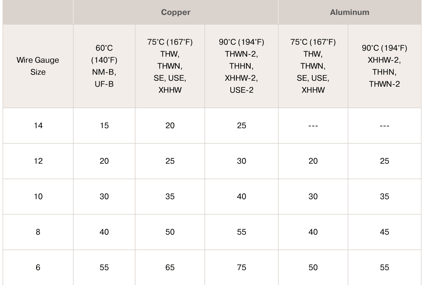

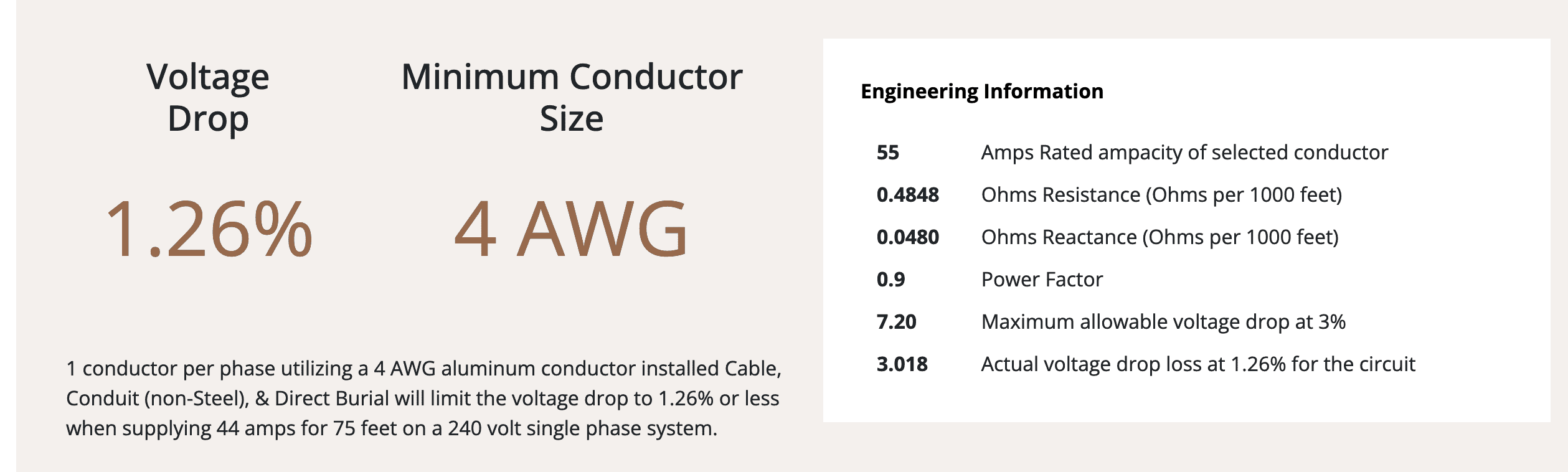

Aluminum has lower ampacity than copper. 6 gauge aluminum THHN is rated at 55 amps, so your max charge rate will be 44 amps with the 80% rule. Aluminum also had a high voltage drop rating. #6 Aluminum is not the right thing to use here. To meet voltage drop specs at 75 feet, you would use #4.
