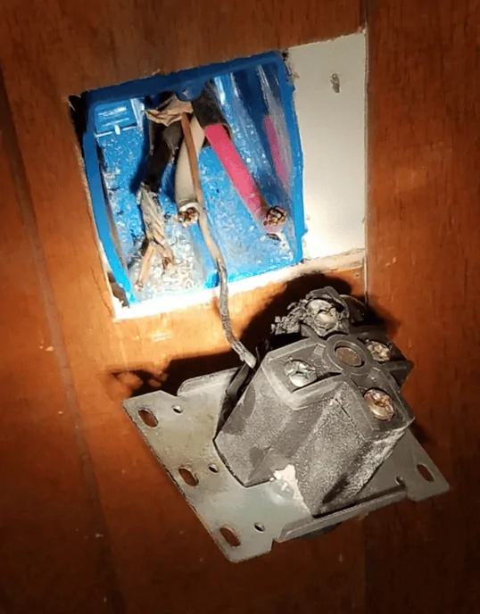

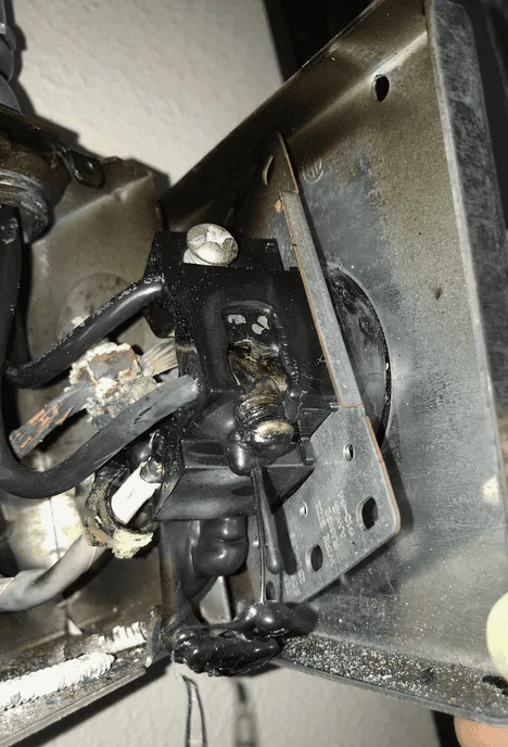

Just because you can do it, it doesn’t make it safe. I wouldnt charge at 48 amps on a 50 amp breaker. Just playing with fate.
Yeah, NEC establishes the codes based on extensive test data and science. Sometimes it seems overly conservative. But sooner or later an edge case occurs, and that's where it makes the difference between safety and a fire. Pictures like this should be enough to prove the point.
