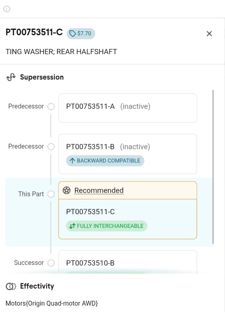

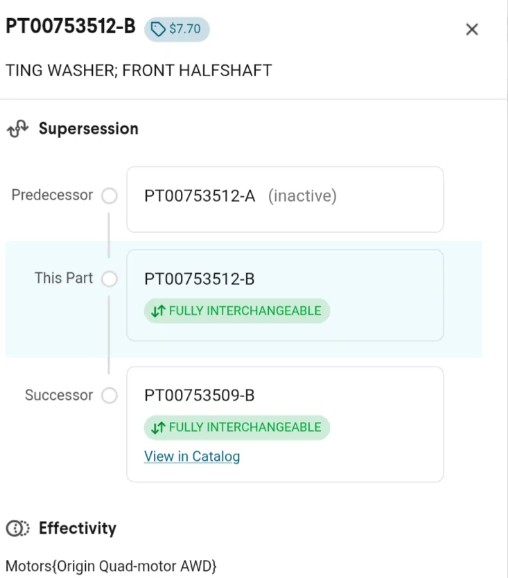

Ting: Friction-fit washer that add tension to remove driveshaft slop/play. Similar function to more commonly known split or star washer. Mechanically it's not a problem. It's more of a end-user experience issue. Once the washer loses tension, the "issue" could return and willing to bet it's a one-time-use item.
$7 part? I may try this out when I swap tires. If it's easy enough, I'll order a stack of them and make it a twice annual consumable.
