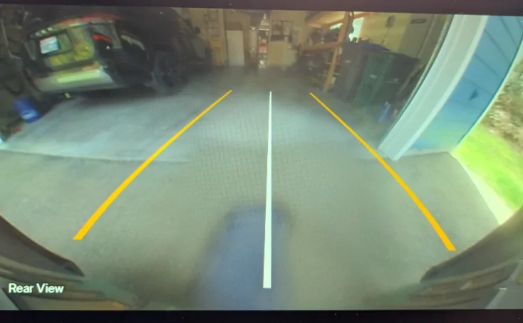

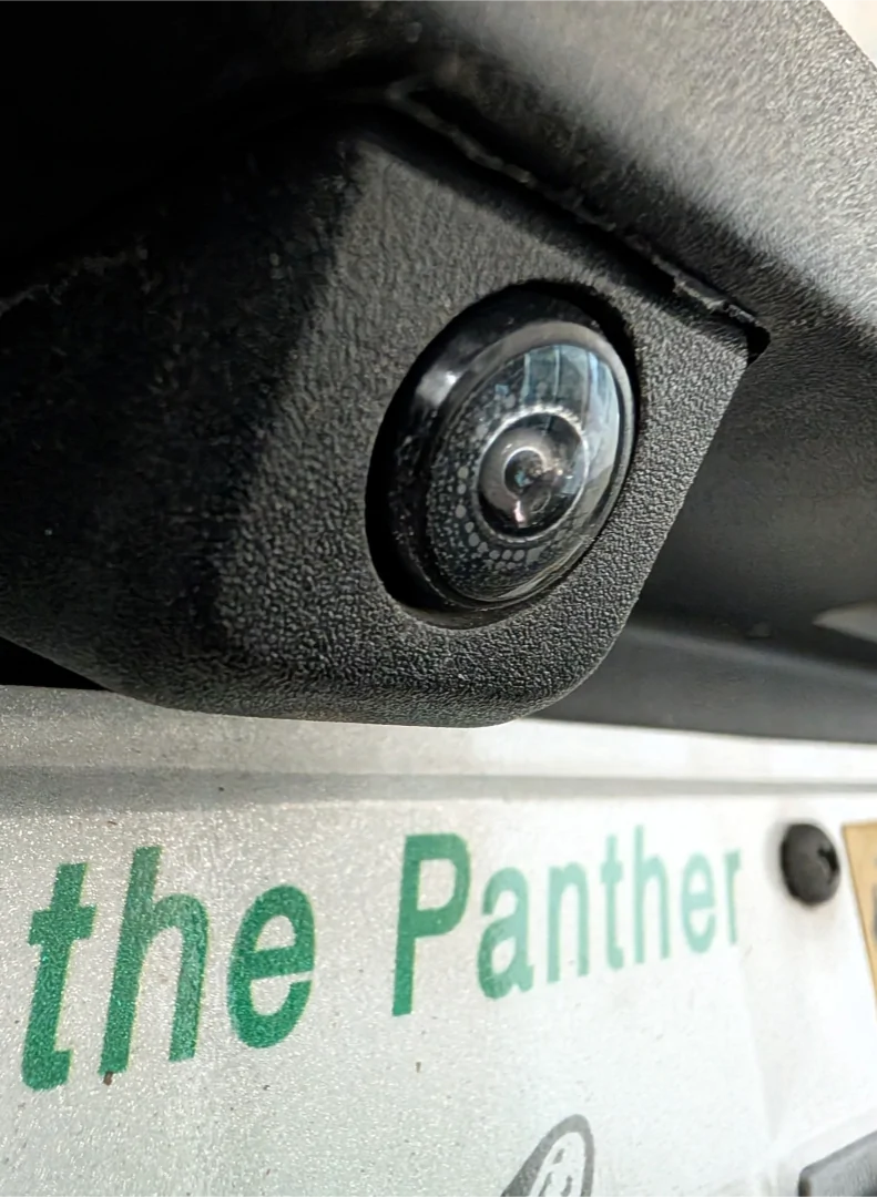

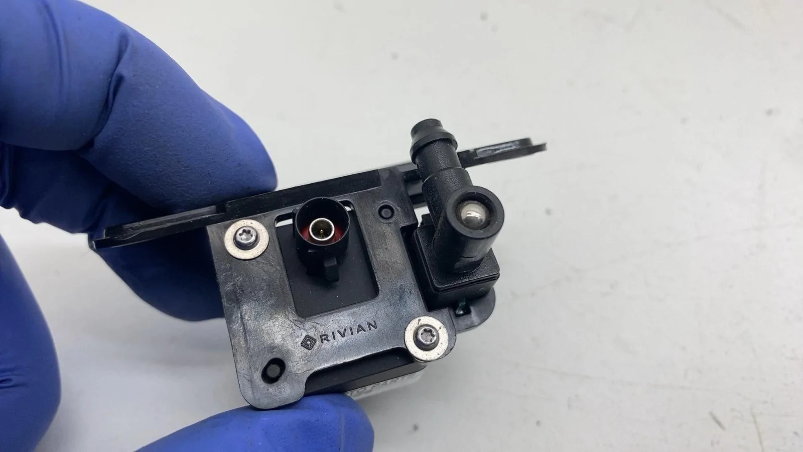

My rear bumper camera has gotten progressively worse, unsure if it was the lens or water or what, but I'm out of warranty and over the terrible view. So I decided to do it myself.
Here's the old cam:
Rivian R1T R1S DIY Gen1 R1T rear bumper camera replacement 1000008528
I can see a water droplet that would never evaporate.
Rivian R1T R1S DIY Gen1 R1T rear bumper camera replacement 1000008527
Fun fact: side cameras are identical to the front and rear bumper cameras. Rivian wants $400-450 new for those cameras with the mounts already attached, I couldn't find the rear for less than $300 used in eBay, so after comparing the backs of a few online I rolled the dice on a new $100 side mirror camera. Spoiler: IT WORKS!

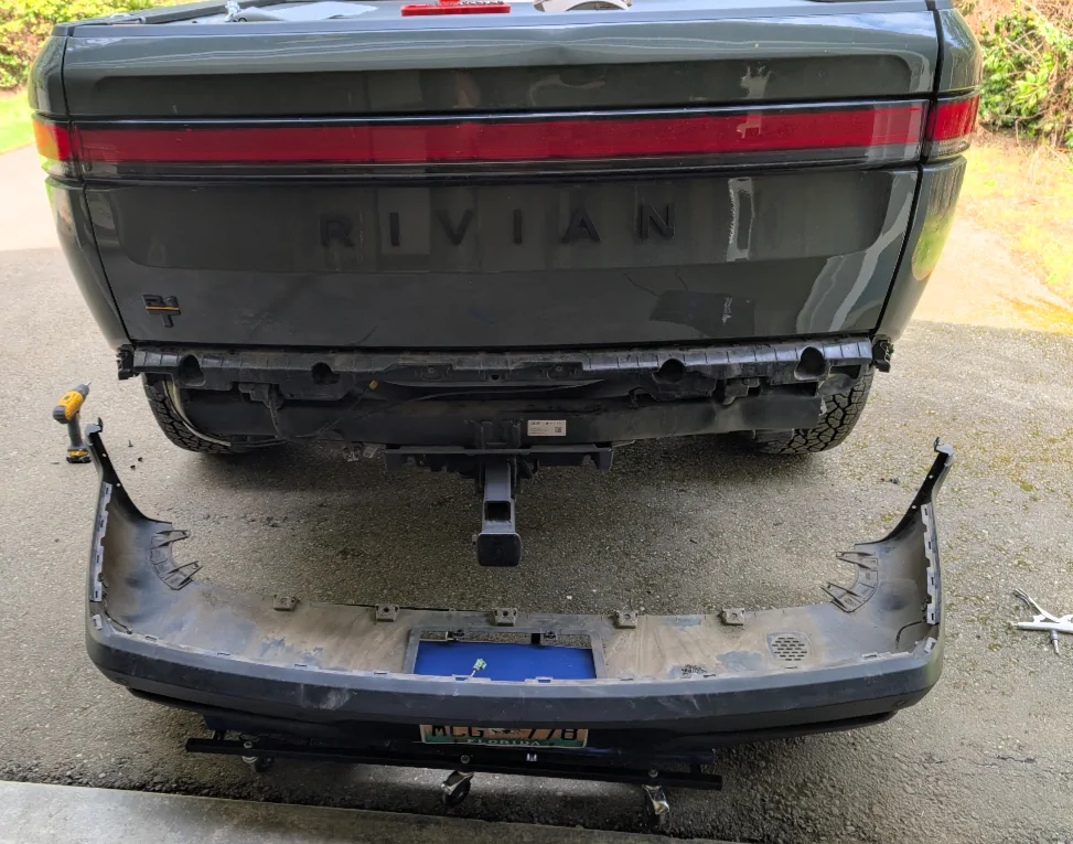

I followed instructions in the collision center that I cannot share because the @RivianRat ratted me out before. You have to take off the hitch cover then bumper, there's 9 10mm bolts attached along the bottom, 2 T20 torx on the sides behind each rear wheel, and 1 10mm bolt above those behind the trim. Pro tip: put painters tape on that part when you pull it off to prevent scratching paint.
Start prying it off with a non-marring tool and disconnect the camera and sensor connector on the right side.
Rivian R1T R1S DIY Gen1 R1T rear bumper camera replacement 1000008529
Then you disconnect the camera plug and use a T20 to remove the camera.
To swap the camera, it's an itty bitty Torx, smaller than 8, don't know the size but I happened to have it in my watch repair kit!
Rivian R1T R1S DIY Gen1 R1T rear bumper camera replacement 1000008530
Do everything in reverse, with a beer, and little patience. It'll go great, trust me. Minimal cursing. Maximal drinking.

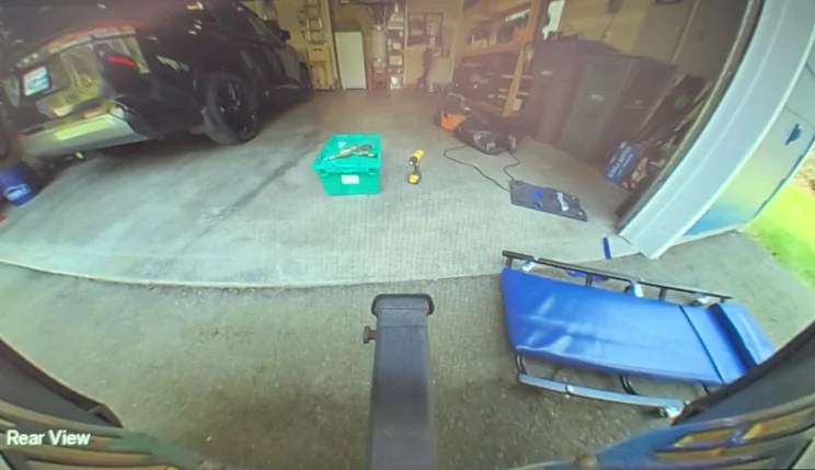

Edit to add: Final step I should mention, it'll say cameras and sensors don't work after you unplug and replug then. Just give it a sleep cycle and everything is back to normal.
And voila: I can see!
Rivian R1T R1S DIY Gen1 R1T rear bumper camera replacement 1000008531

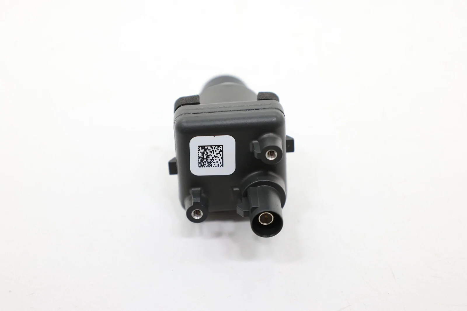

Based on eBay..which isn't always reliable it looks like PT00465707-D is listed as for R1T/R1S but it has a different mounting and plug point (top center) from what you have pictured:
Rivian R1T R1S DIY Gen1 R1T rear bumper camera replacement 1776599266322-6i

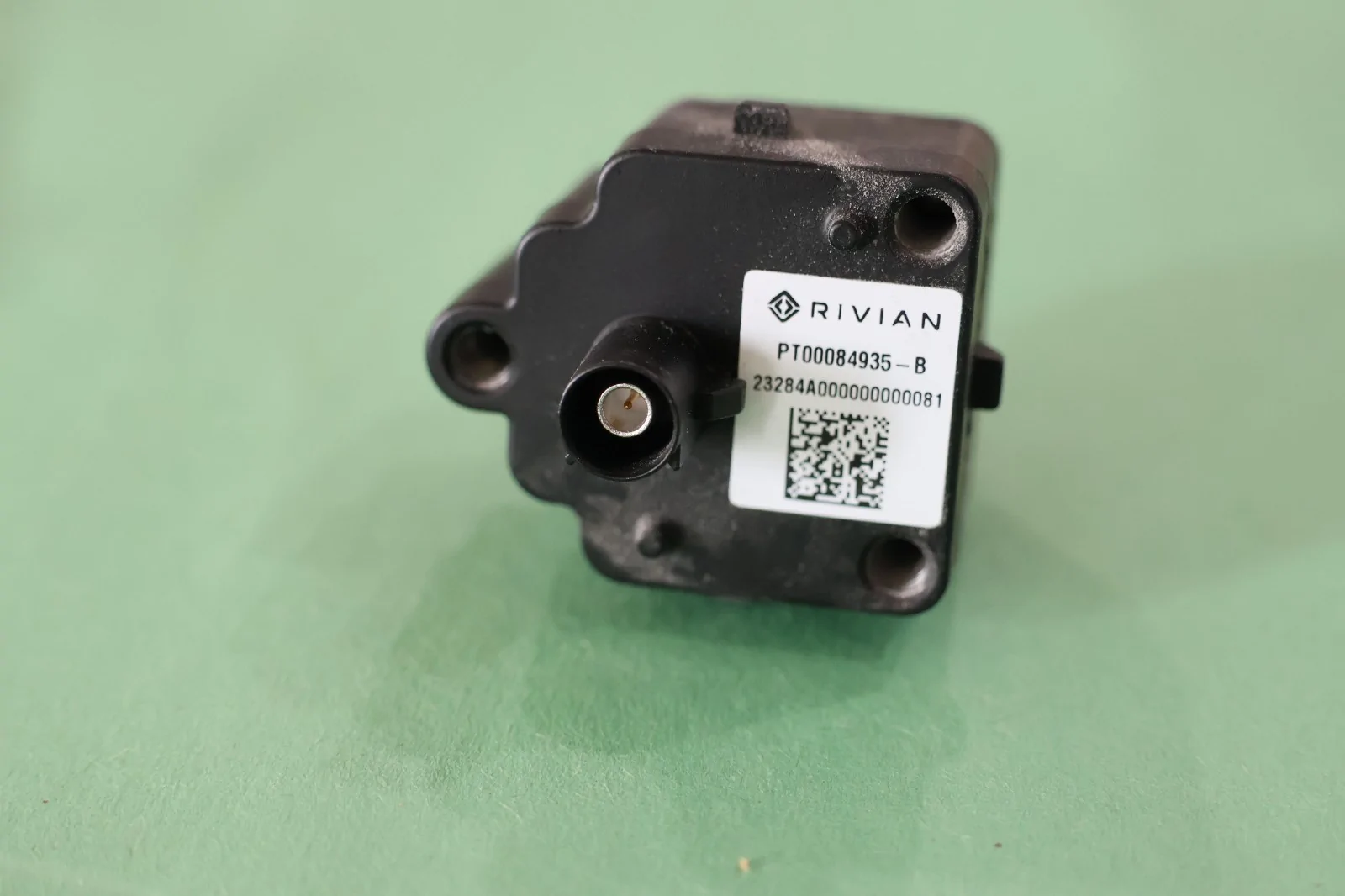

The fender cameras showed as PT00084935-B, but they too looked different:
Rivian R1T R1S DIY Gen1 R1T rear bumper camera replacement 1776600429184-i0

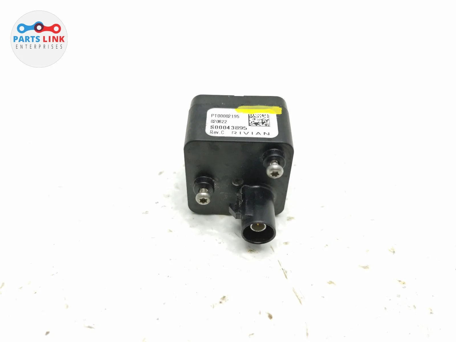

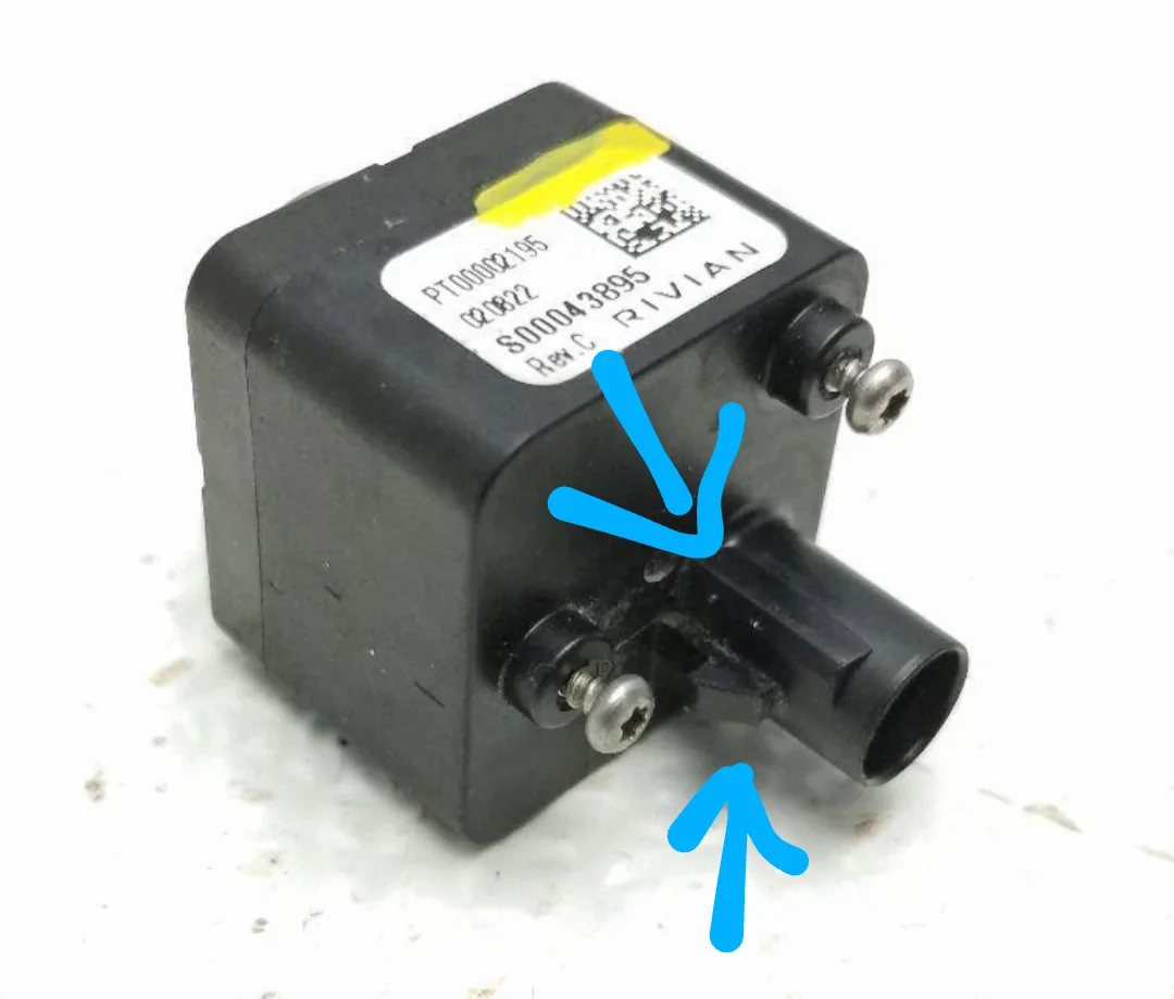

I finally found PT00002195 which seems to be the side mirror light camera and seems to match:
Rivian R1T R1S DIY Gen1 R1T rear bumper camera replacement 1776600797223-cl

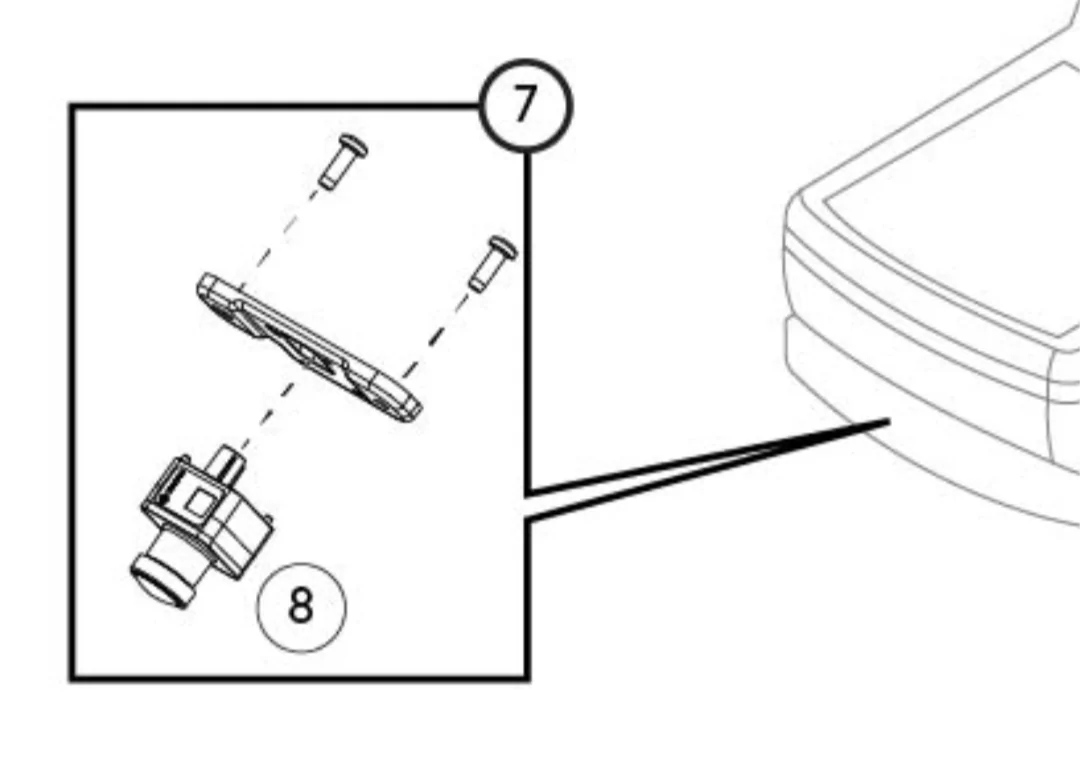

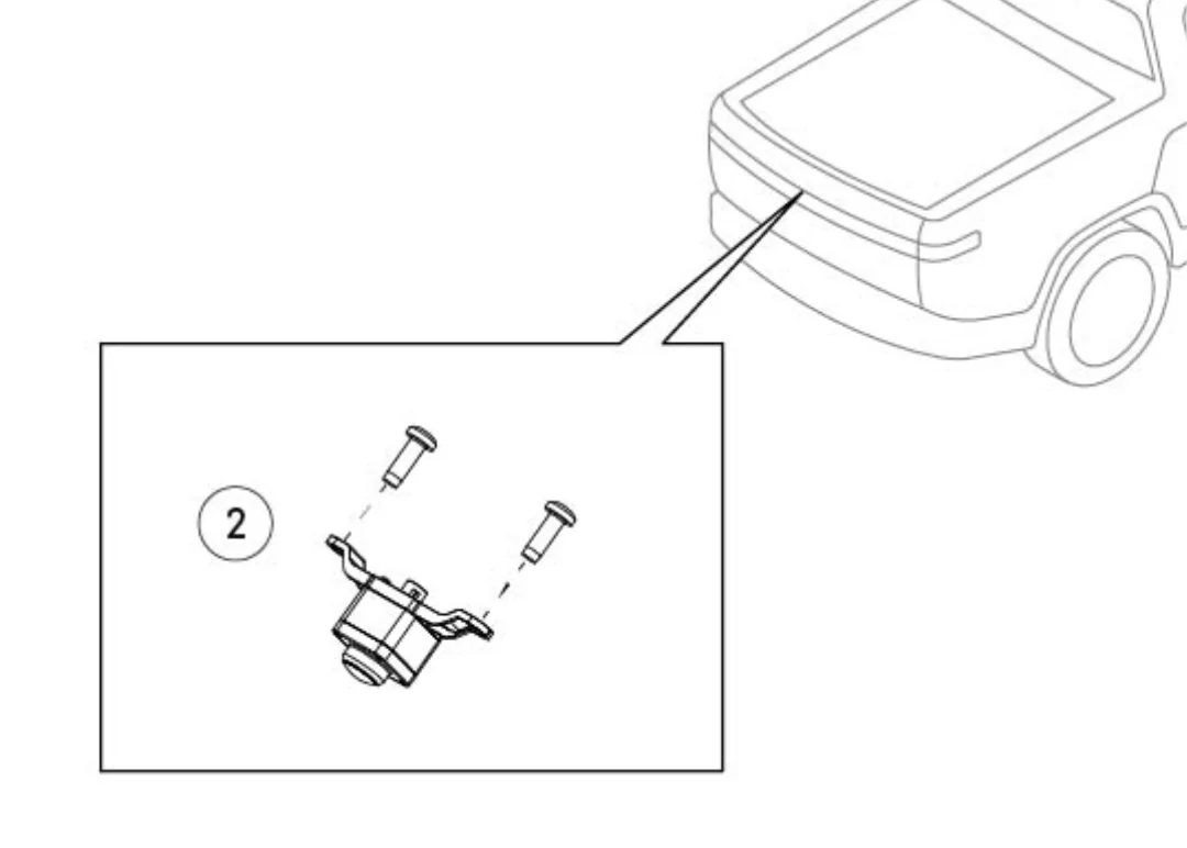

Gen1 camera and bracket assembly, bumper, rear: PT00032058-A
Gen1 camera, surround, mirror: PT00002195-D
Gen2 shows all of the front, mirror, and rear cameras as PT00465707-D so you know they are all the same, but also shows different ones for pre-bracketed. Gen1 doesn't do that in the parts portal.
Precisely my finding on that gen2, pretty dang close but not quite. And the lens is different on the R1S bumper than the R1T, it's longer for both gens.
Rivian R1T R1S DIY Gen1 R1T rear bumper camera replacement 1000008558

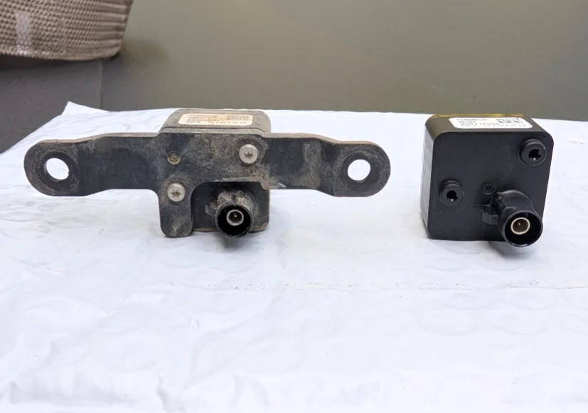

Gen1:
Rivian R1T R1S DIY Gen1 R1T rear bumper camera replacement 1000008560
Gen2:
Rivian R1T R1S DIY Gen1 R1T rear bumper camera replacement 1000008561

You've got me back down the rabbit hole. This camera is gen2 "Camera, Wide Angle, Front" on parts portal, goes up top in the rearview mirror assembly.
Even if you get brackets that fit a different screw pattern, will the plug mate?
Gen1:
Rivian DIY Gen1 R1T rear bumper camera replacement {filename}
Gen2:
Screw it, I ordered it.
Those nubs are just to hold it in, the pin pattern will matter more than anything else. That said generally the nub alignments are due to different pin/wiring patterns so it might not work. The big question though is, would it even be any better in terms of quality?

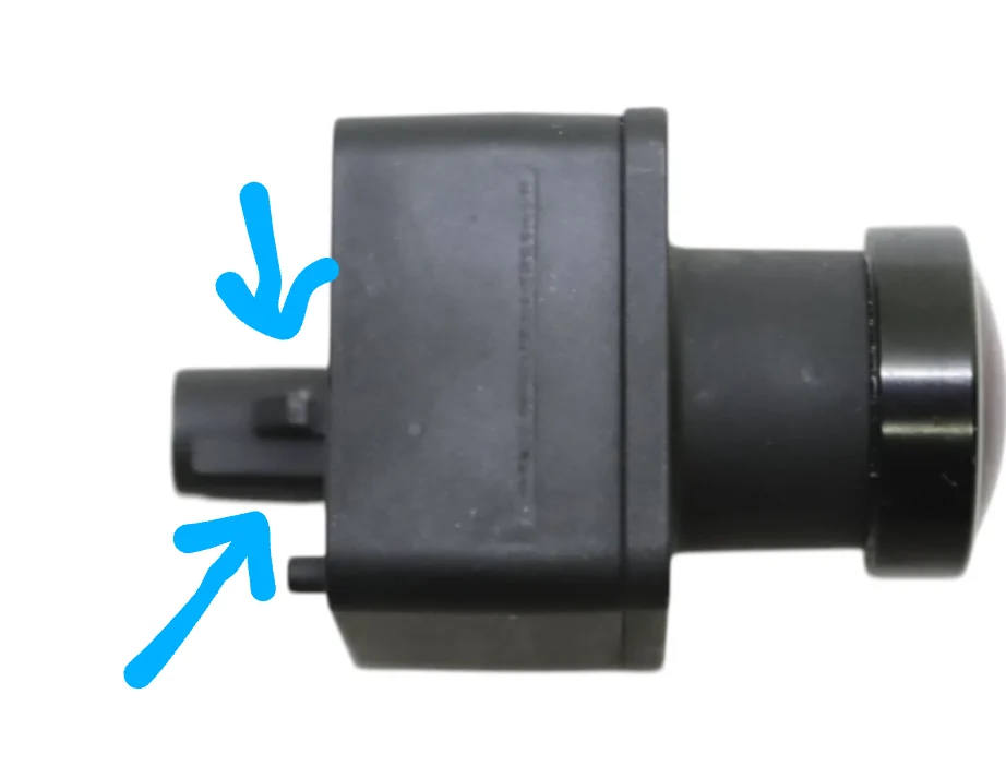

I didn't get a good pic of the plug when I had it off, but looks like this:
Rivian R1T R1S DIY Gen1 R1T rear bumper camera replacement 1000008564
There's a specific pattern for the plug, so while pin might connect fine, the plug might not seat well and could allow water intrusion.
