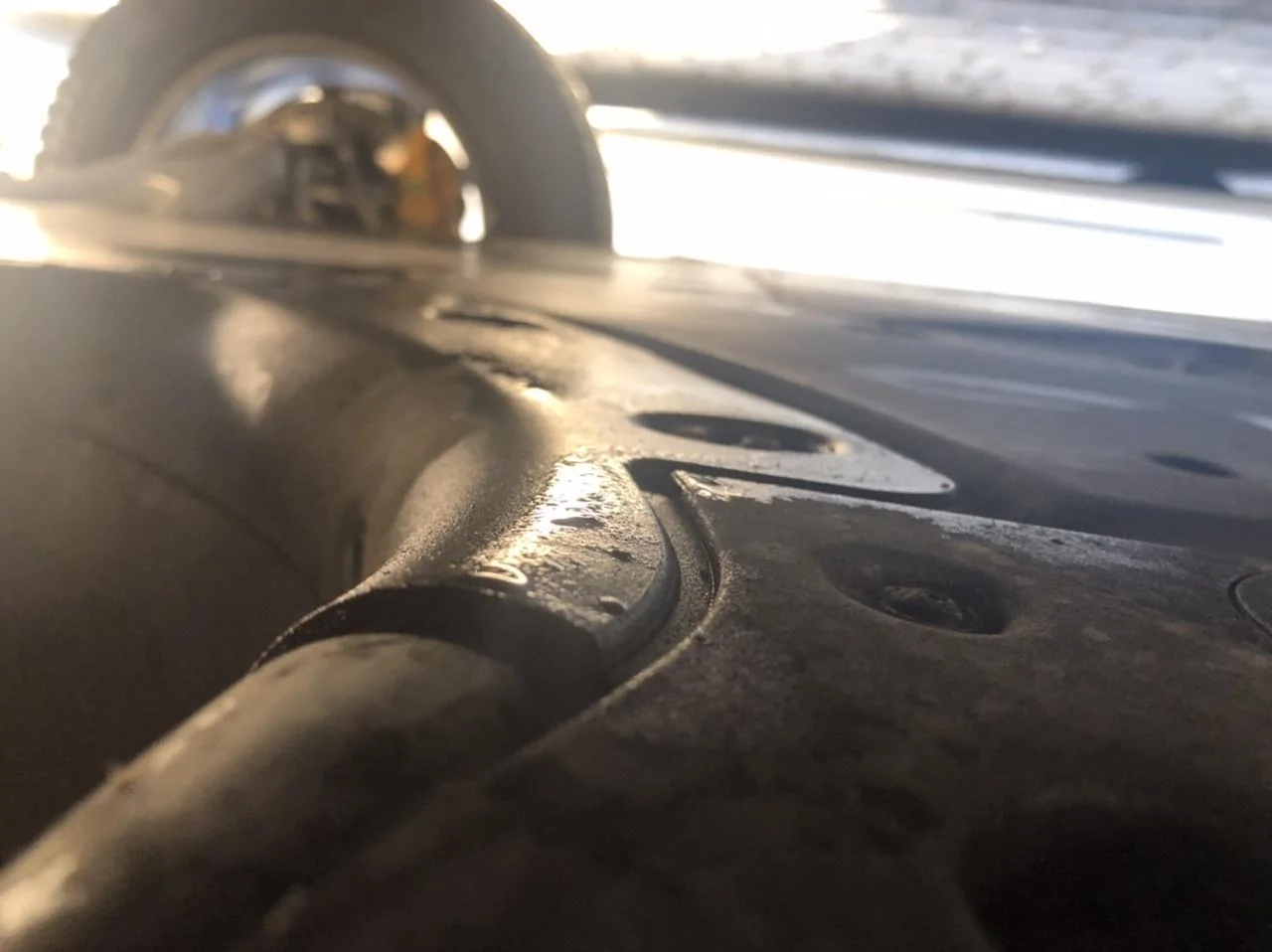

Just check my inner CV joints and they wiggly too just like the video.
And, I found an oil leak. Called it in and waiting for resolution.
Rivian R1T R1S Rivian R1T CV axle failure missed by service center 86F3106D-6FF2-4BF8-A81F-10A4C854A9D1
