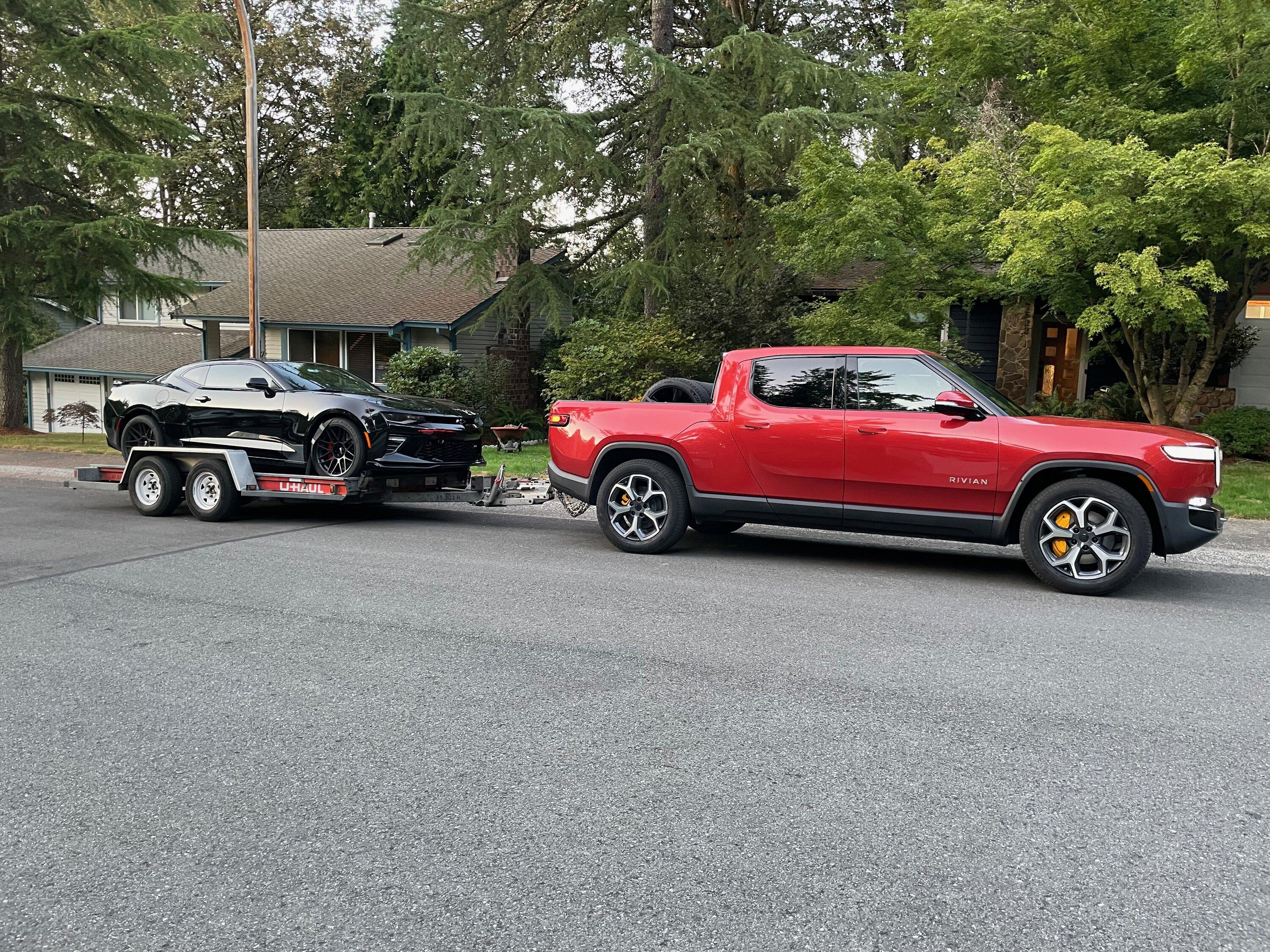

I've been disappointed that nobody has been sharing any experiences towing a car. Lots of boats, but no cars. @gideontherivian had kind of shared some towing teasers, but I assume he was an employee, and so no efficiency, charging, or general experiences notes were really shared. So I had to try it myself!
Rivian R1T R1S Towing a car (to and from the track) with R1T - my experience & report IMG_2624
That trailer, empty, is supposed to be 2210 lbs, and the car I think is about 3685 lbs, so probably just a little shy of 6000 lbs total.
It worked really well. I wouldn't say you couldn't feel the weight, but it felt like a lot less than you would expect. Towing mode sets the dampers to stiff, and I think that goes a long way to taming all that extra mass that's sitting on the tow ball. It was impressive. If you hit a bump, you'd get one nice compression + rebound cycle on the truck, and then you could see the trailer bounce a few extra times in the mirror (but you wouldn't feel it, and it wouldn't pull you around). It definitely tows better than any half ton I've towed with (though admittedly, I've only towed with older half tons).
I'm really curious to learn how regen works along with electric trailer brakes. With the surge brakes on the u-haul, a decent amount of regen would trigger the surge brakes, and then you'd kinda lose the ability to capture that energy until you start accelerating again. In some cases, it would have been really nice to just let the truck regen, and only use the trailer brakes if you really need them. There's a fine line here, I'm sure, keeping the rig stable while also trying to take advantage of regen. But I would expect that the electric trailer brake controller might be able to do that better than surge brakes, which basically have no control. That might impact range?

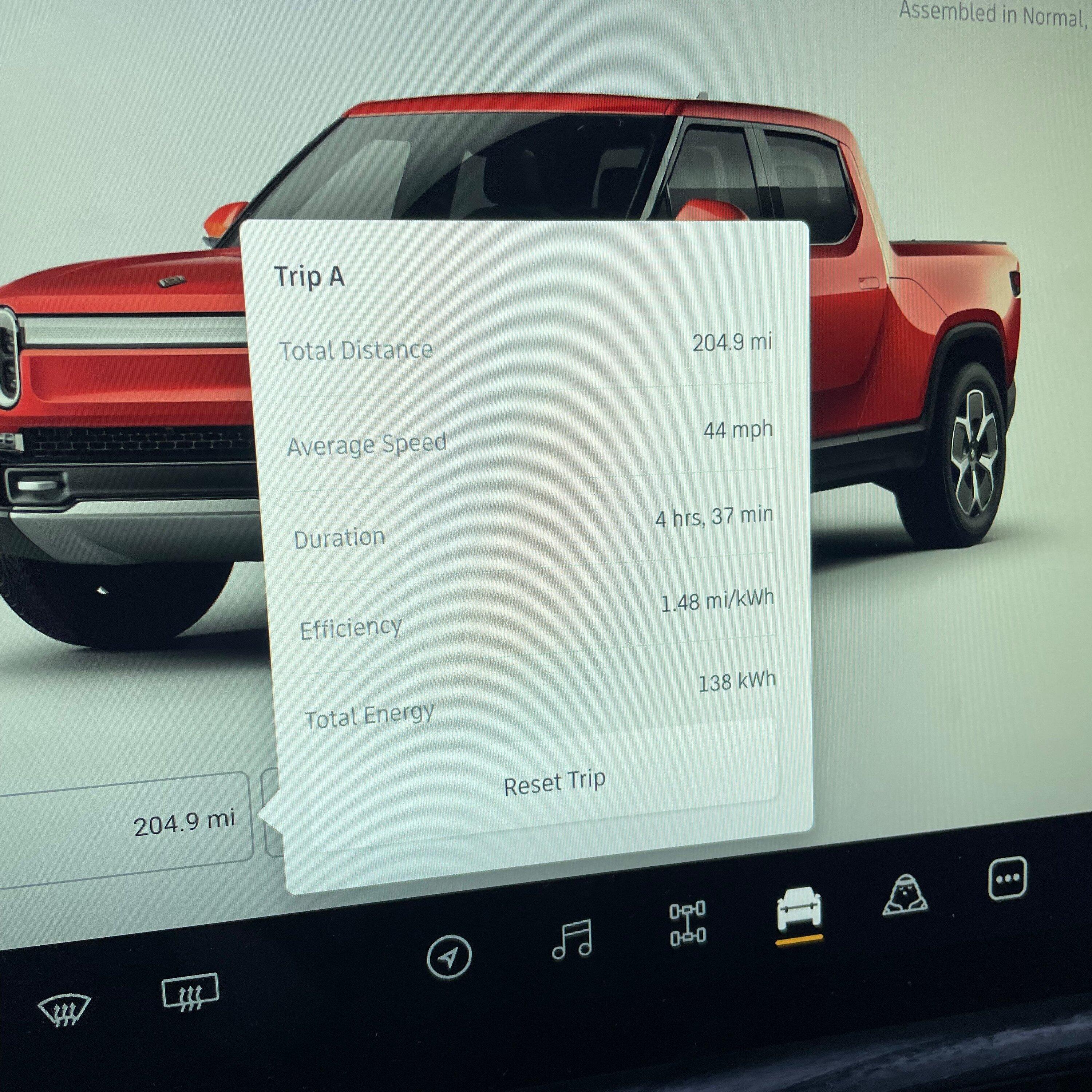

So, range. After "learning" the trailer, the truck estimated full-charge range of 150 miles. This estimate seemed to move a little throughout the trip though. The energy use summary is below. This is for a round trip with minor elevation change (traveling between Redmond WA and The Ridge Motorsports Park). On the way there, there was minimal traffic, and I was traveling a little over 60mph on average. On the way back, I just drove with traffic, but there was a lot more traffic. So there was stop-and-go, and there were periods of ~70mph. The consumption at 70mph is definitely worse, but the stability is still great.

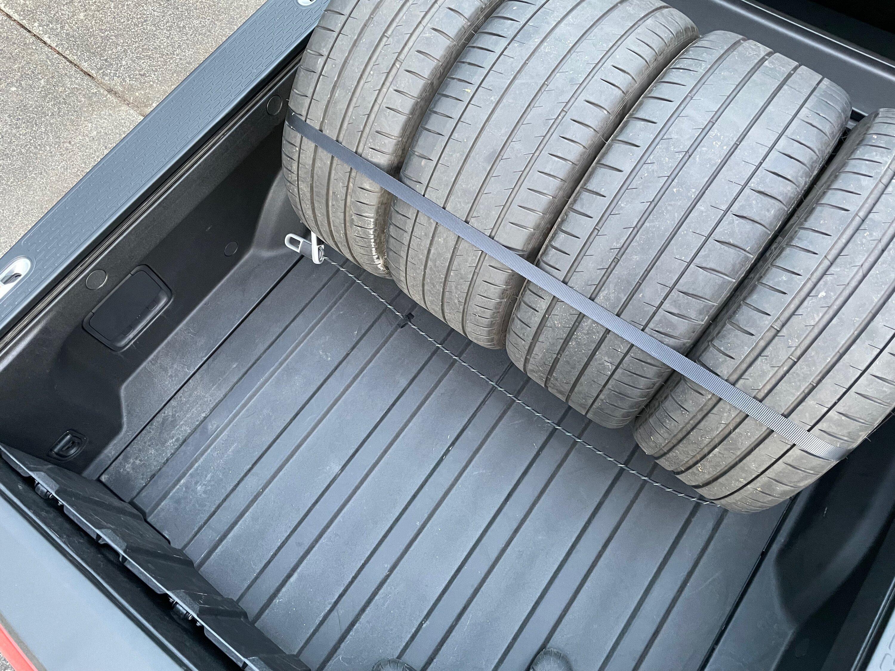

Third isn't towing related, but I discovered that the gear guard cable is restrictively short. I couldn't even reach it around a row of 4 wheels in the bed of the truck. ?‍♂
That's why they sell a longer one in the gear shop for $100.
Be careful tying down to the front of the truck up against the tonneau cover. I always tie things up to the rear side against the tailgate to ensure I don't damage the ultra-fragile tonneau cover.

Nice to see towing a car you got nearly 1.5 mi/kWh. I'm a max pack preorder, but one of the reasons is to ensure towing my car to the track is a real possibility. One track I frequent is about 110 miles and the other is just shy of 80 miles. Not having to charge at least on the way there will be quite nice since I'm usually leaving the house stupid-early in the morning. Of course I also see you're on the 21s...I wonder how much worse this would be on the 20s.
I originally had a max pack with 20s reserved, but I got impatient. I switched to the 21s when I settled for the 300 mile pack specifically because of this use case. I did make a new reservation with the intent of switching to the 400 though. I just haven’t completely settled on 20 vs 21 for the next one now. The 20s would be better for the occasional winter trips I do, and they look better. But the 21s are better for everything else :/.

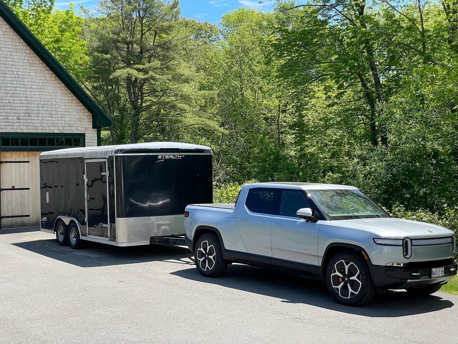

I have been towing sales samples in a 16x10 Stealth Trailer for the last couple of months. Longest tow was 592 miles from Buffalo, NY to ME. Here is some of my feedback;
Range - seems like wind resistance (my trailer is tall and square) is worse than weight when it comes to range. I have been getting 1 - 1.3miles / kwh driving at 65-69mph. I estimate that trailer and samples weigh roughly 6,000 lbs. Not getting that much better range when I tow the trailer empty. Speed changes the range dramatically.
Navigation / Route planning - I quickly realized that that when towing Rivians system is not at all functional. It wanted to send me routes that do not have chargers and longer than what the estimated range was for the vehicle. I use plugshare to map my route. Have informed Rivian about this navigation issue.
Charging with trailer, most of the time I have to unhitch the trailer to charge bit of a pain for sure.
Overall driving with trailer has been really good. Merging in and out of traffic, stability etc. is really really good. I have been using an F-150 Ecoboost for the last six years and the Rivian tows better, albeit not as far..
