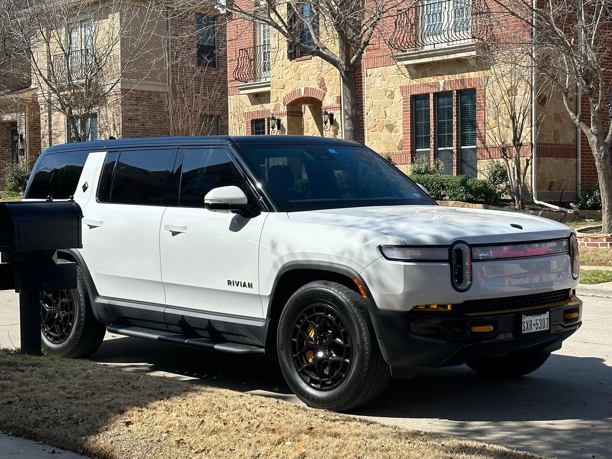

@LL75 can you post a pic of the grabber hts60 on your r1?

I just got a set of the terrain contact h/t. They get installed Thursday
Any photos you could share of the Continental TerrainContact H/T's? Sorry, I searched but couldn't find any if you already posted somewhere else...also, any ballpark on MPKs so far?
Guessing you are right around 2.0 with the colder temps?

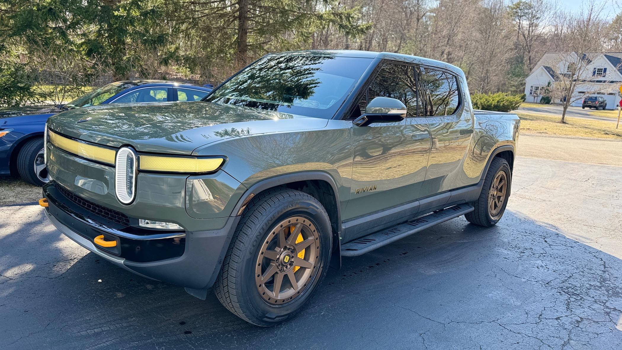

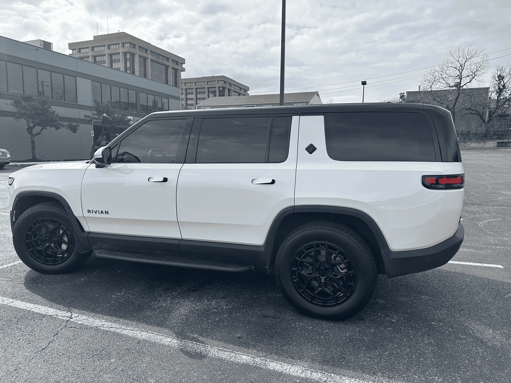

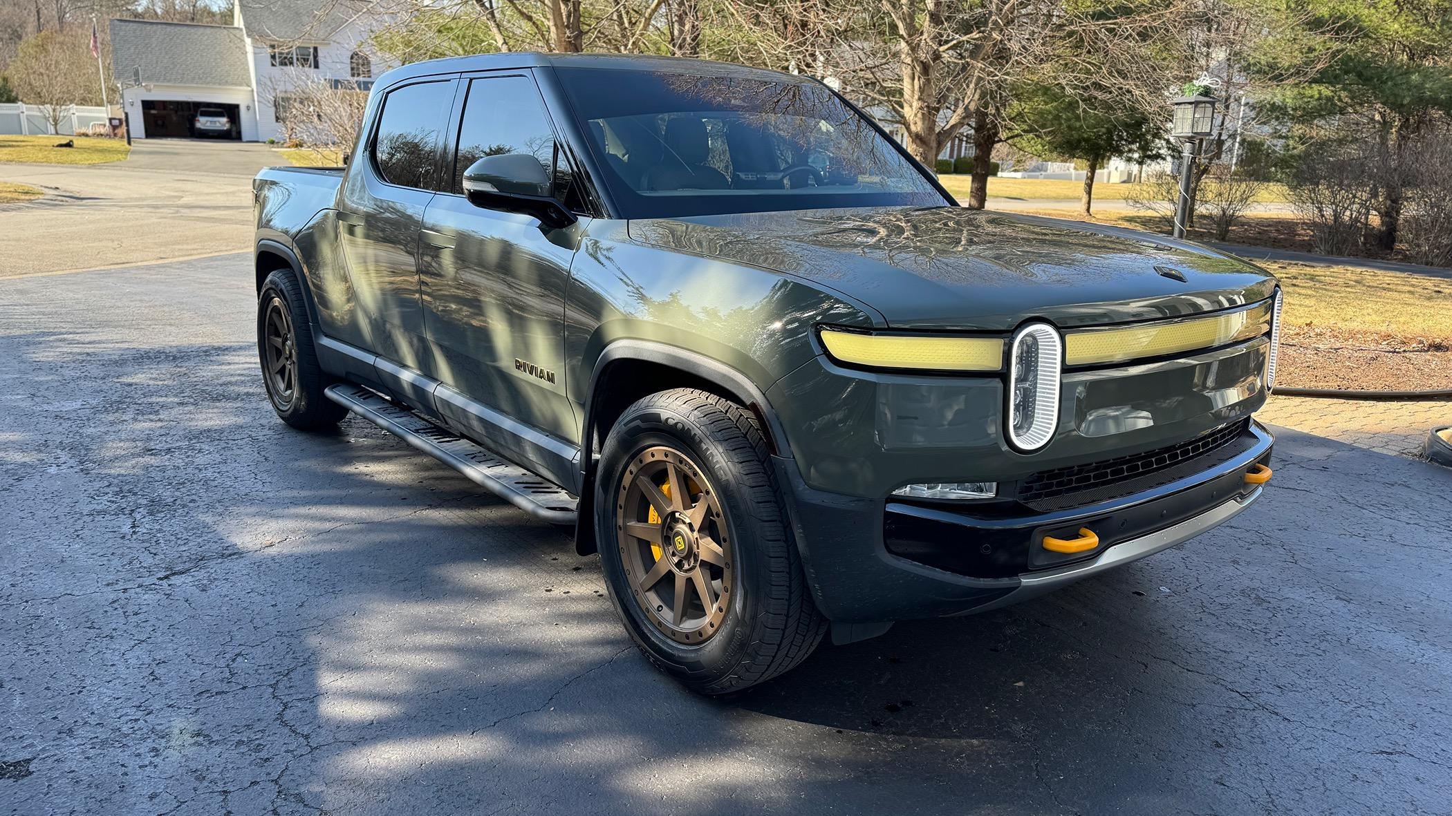

Still cold but highway I saw 2.3 ish and local driving I saw around 1.9 - 2.0. Still roughly 30-40 degree f around here

These look great. I assume these are 275/60/20 and not the 275/65/20 based on how they look, right?
Thanks for providing pictures and brief range numbers. I'd be interested to see how these do as it warms up a bit.

Yes, all tires mentioned in this thread are 275/60 (33").
The OEM size (34") of that tire would likely be 20-30% less efficient...
Assuming average temp of only 36F or so, once adjusted 65F DoubleTake's MPK is a solid 2.25, will need some more data to confirm, but this should mean a max range of 290 (AP) miles or 325 (Conserve) miles...
Thanks for sharing DoubleTake!

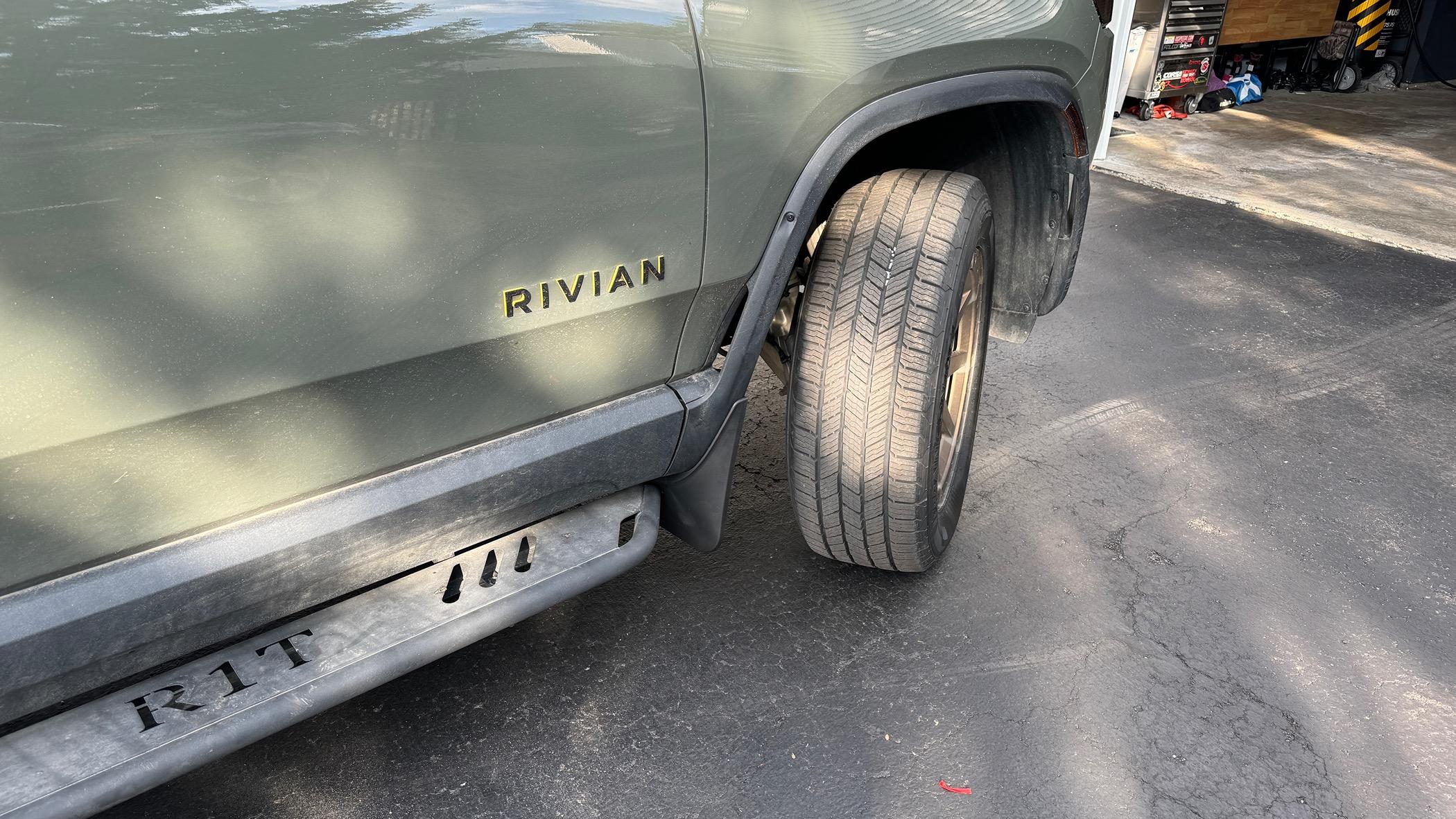

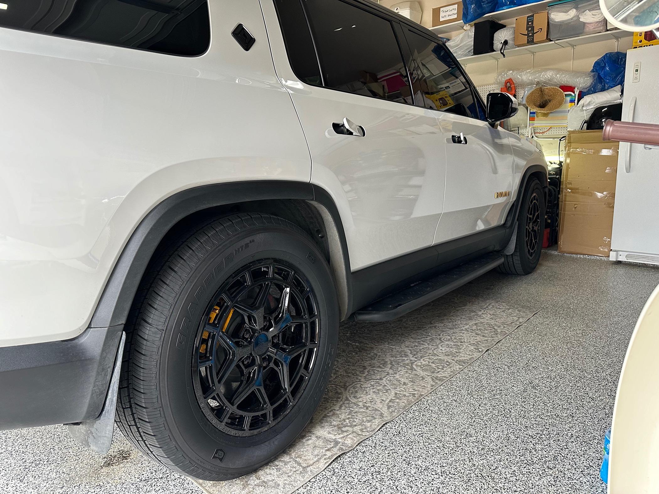

So today in 45 degree weather during my same 13mile commute home I average 2.35. With my 275/60 KO2 I would get 1.85 and with my 22” 275/50 perreli I would get 1.95. ( all these with same weather and commute to try and get as close to realistic comparison)
