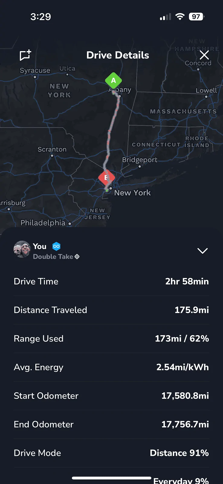

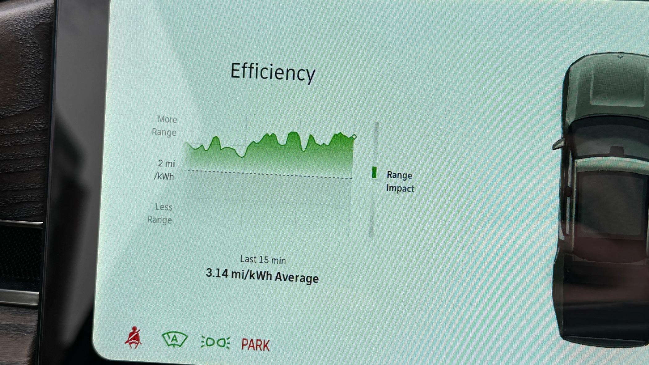

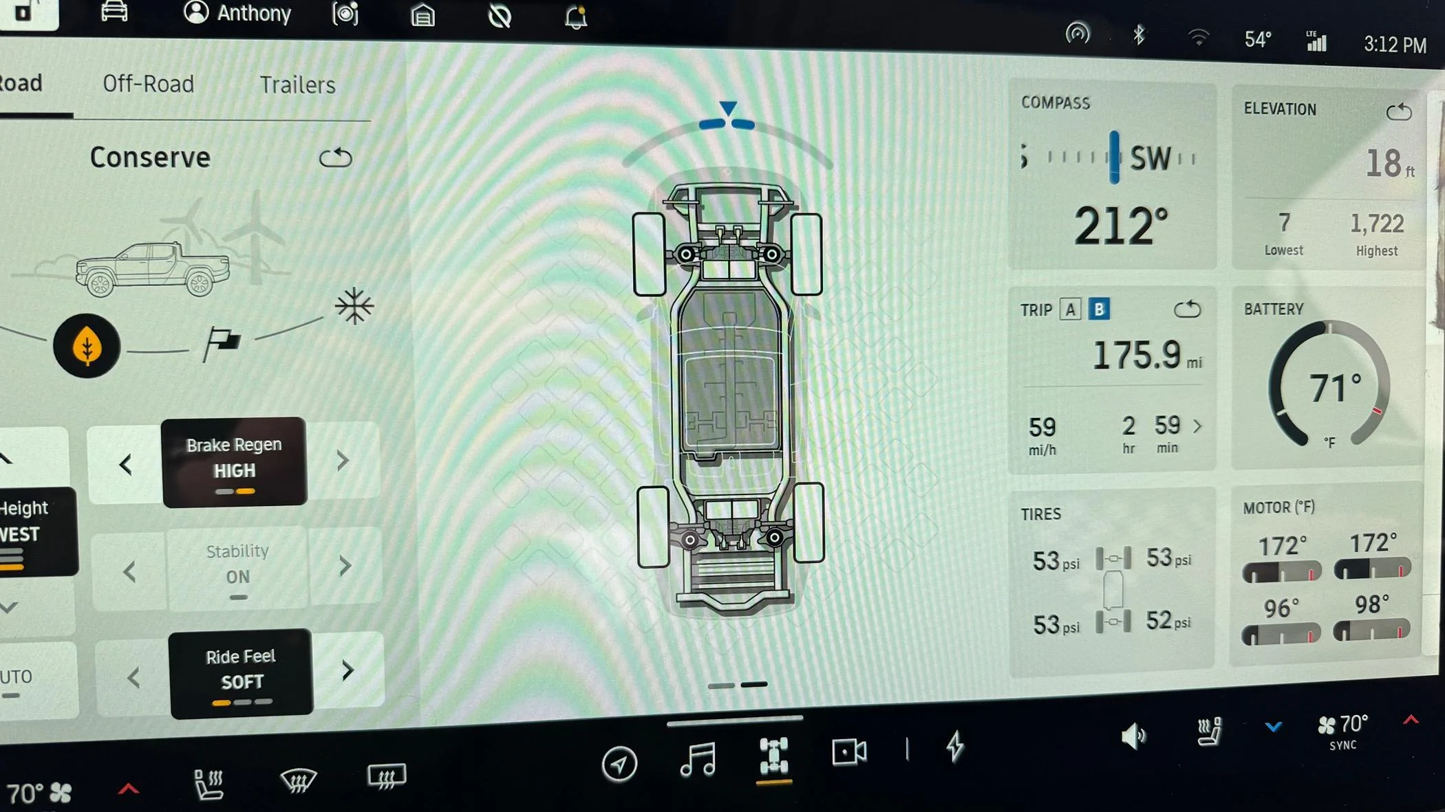

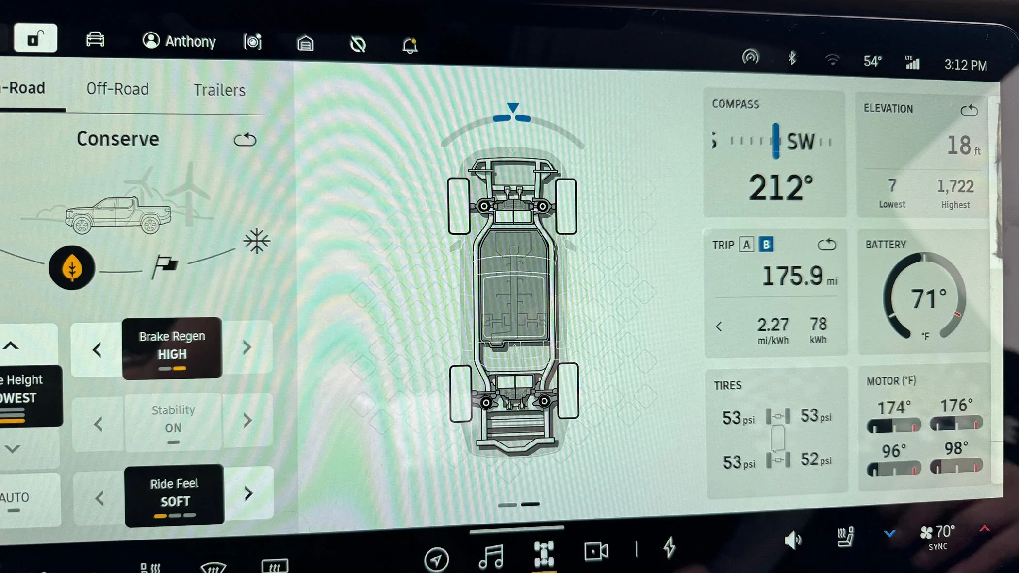

@ksurfier Today’s trip from upstate NY to Jersey. 175miles. In NY I was going 70 then in Jersey it was between 55-65. Temps in the 50 outside and battery around 68.
Conserve mode entire trip. Nice to see and I expect to see more in the future as it gets warmer and when I switch to HTS60
