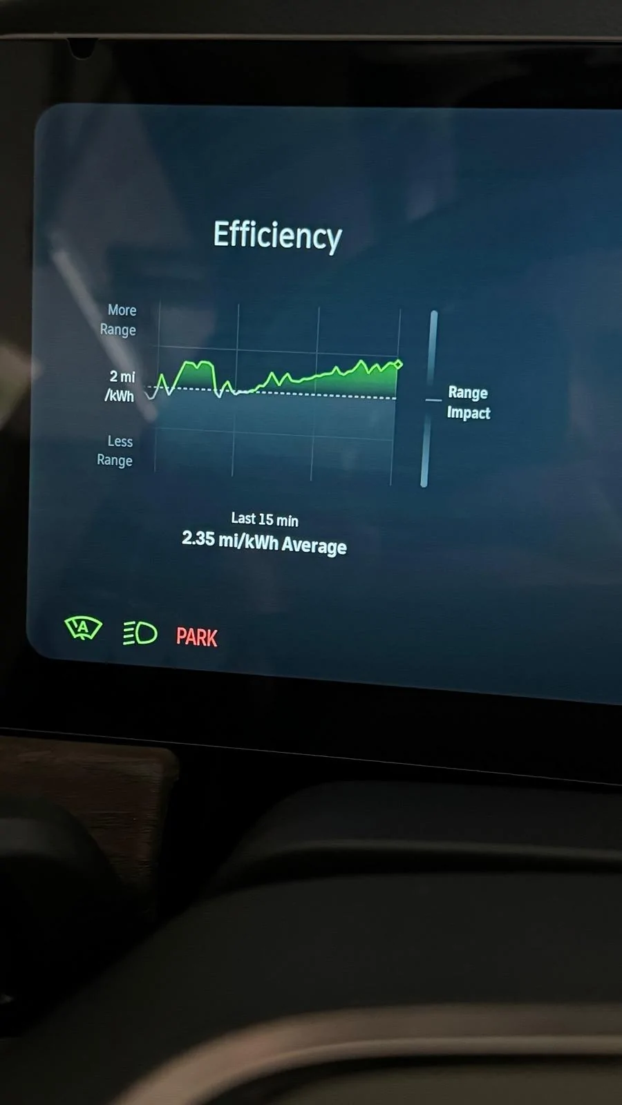

So today in 45 degree weather during my same 13mile commute home I average 2.35. With my 275/60 KO2 I would get 1.85 and with my 22” 275/50 perreli I would get 1.95. ( all these with same weather and commute to try and get as close to realistic comparison)
Wow, that's great. Adjusting for temp that's pushing into ~2.7 MPK in AP...in Conserve that'd be close to 3 MPK, or a total range of 384 miles...will have to see how it settles out...
If you have an opportunity to run on flat-ish ground at 70 mph and you can get 2.4 MPK in AP that would confirm it. Range at 70 mph would be ~345 miles Conserve (307 miles AP).
