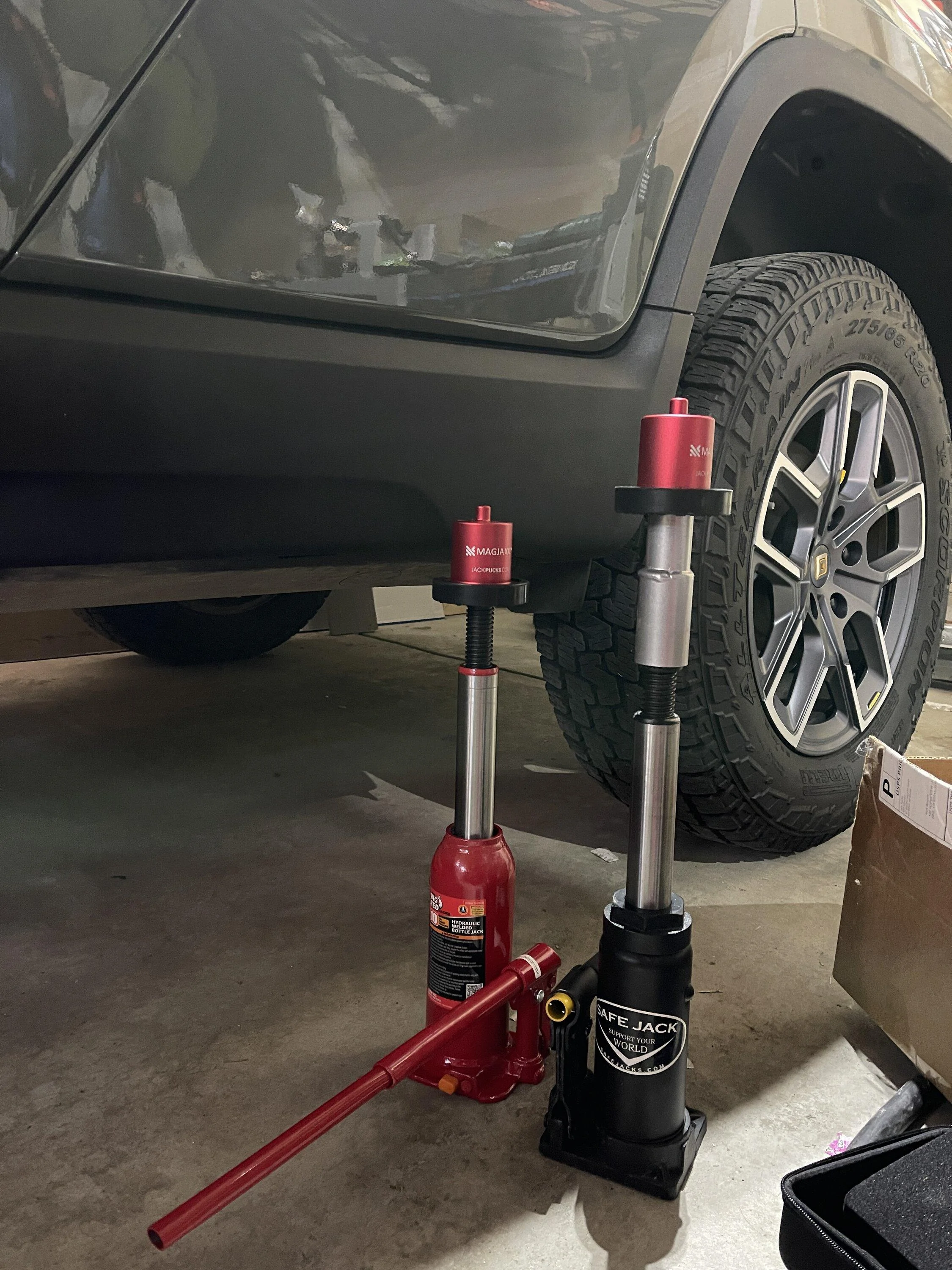

Yea, Safejacks is pretty much the end all be all of bottle jacks. I’ve got one for my lifted Wrangler. The basic 6ton jack comes with extensions to make it lift higher. Here it is next to the 10ton big red jack.
In this pic, my R1T is at the max height setting. With the extension and puck, the SafeJack tops out at 20 3/8” The adapters I have for this jack are more than enough for my Wrangler on 37s. They have larger capacity jacks available as well. The only other jack I would consider over this is the Pro Eagle floor jack.

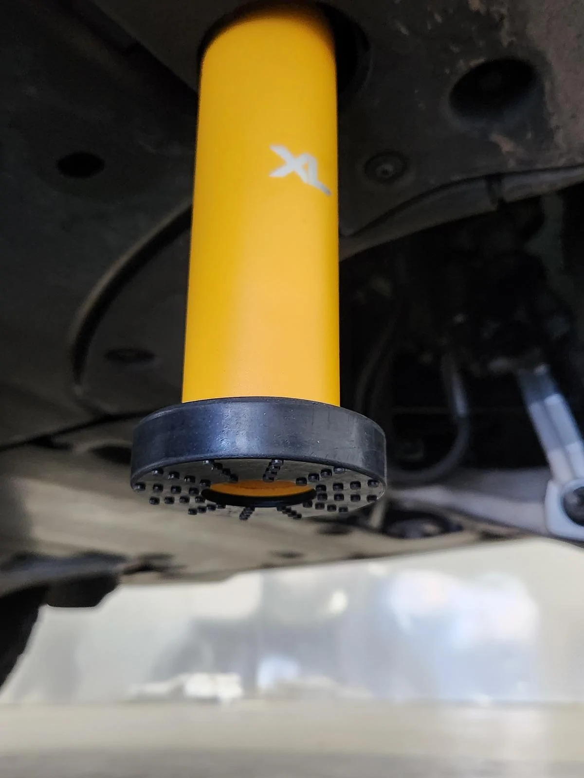

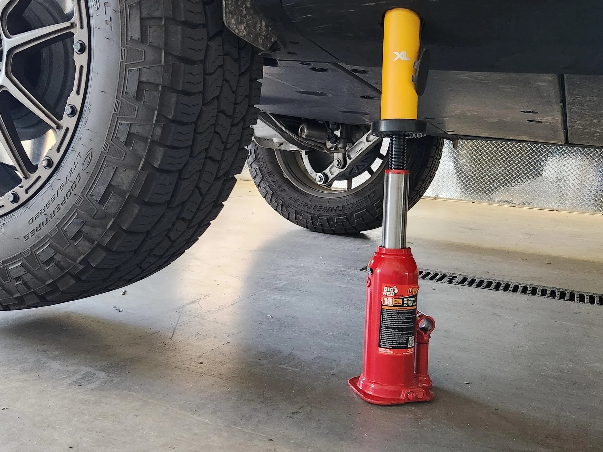

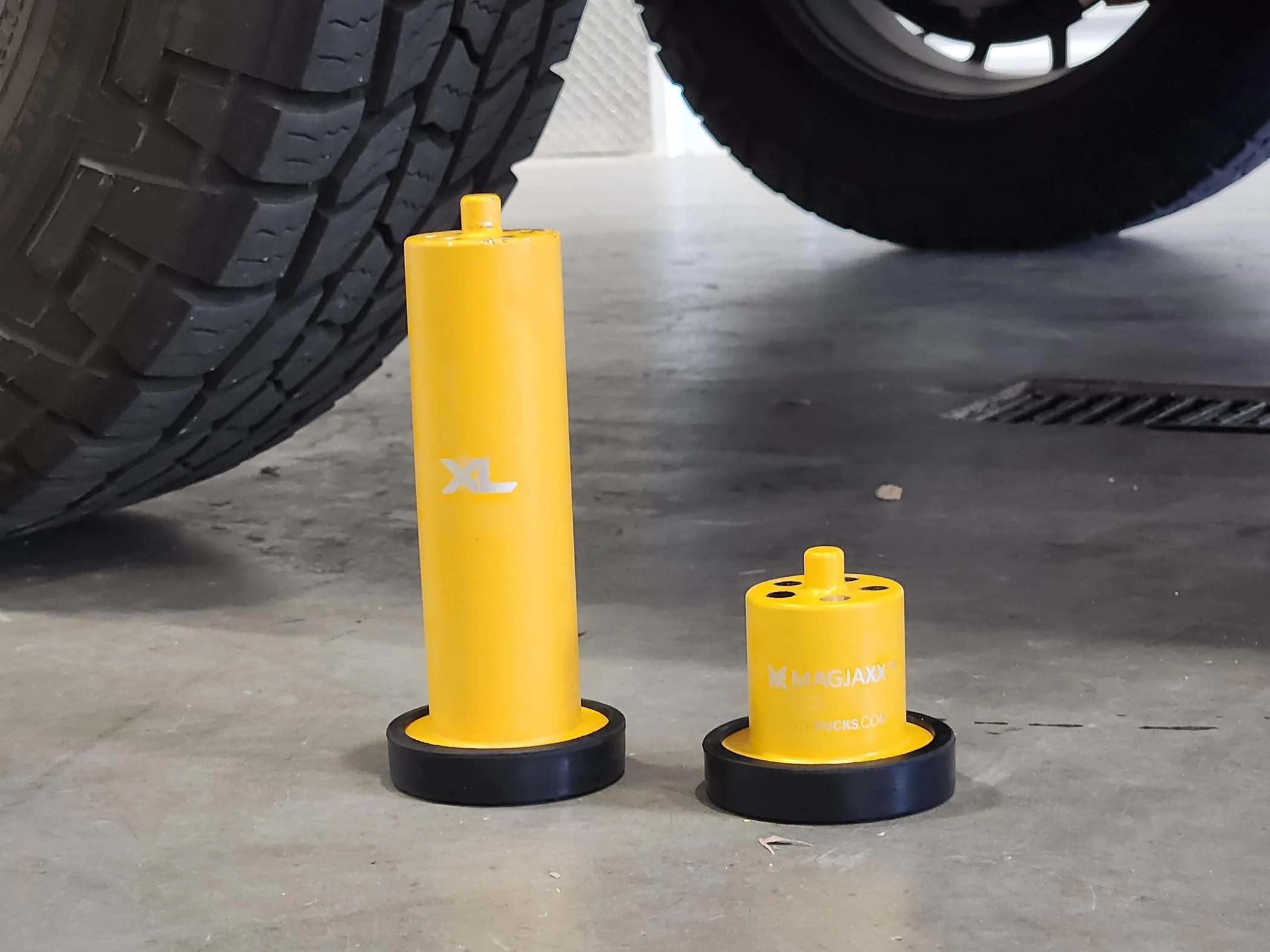

We designed a high lift magnetic jack puck (only high lift kit with magnets) - XL 6 Magnetic High Lift Jack Puck Purchase Link to work with a readily available hydraulic bottle jack, to provide support to Overlanders/Off Roaders and those that simple wanted a solution to get the rear wheels easily off the ground for a tire change or repair.
There are two reasons we released this high lift version of our magnetic jack pucks.
1. If you use this along with the Big Red Torin 10T Hydaulic Bottle Jack from Amazon Big Red 10T Bottle Jack Amazon Link you can lift the rear wheels off the ground in any Rivian R1, for a change or repair.
2. The Big Red 10T fits nicely in either the R1T or R1S and works well in off road situations, where you need extra height to get the tire off the ground.
People who want to do a plug repair on the road (screw or nail), you can easily use the XL puck and get the tire off the ground, to de-air, pull out the screw and insert a simple plug. After that air up using your compressor, lower and drive.
is there a specific kit you’d recommend? I’m still fuzzy on which is best for an R1T.
