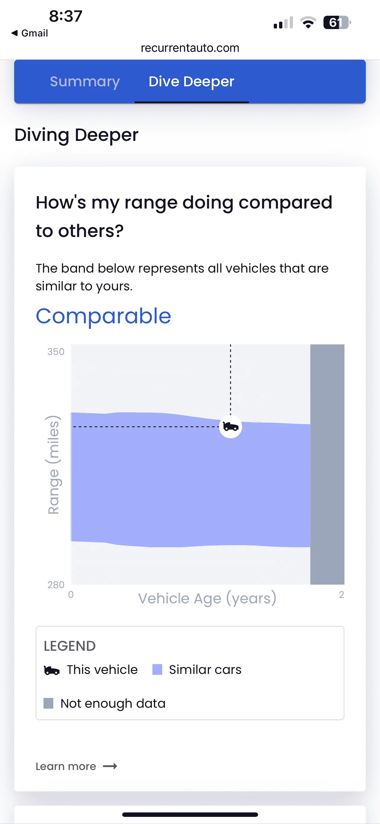

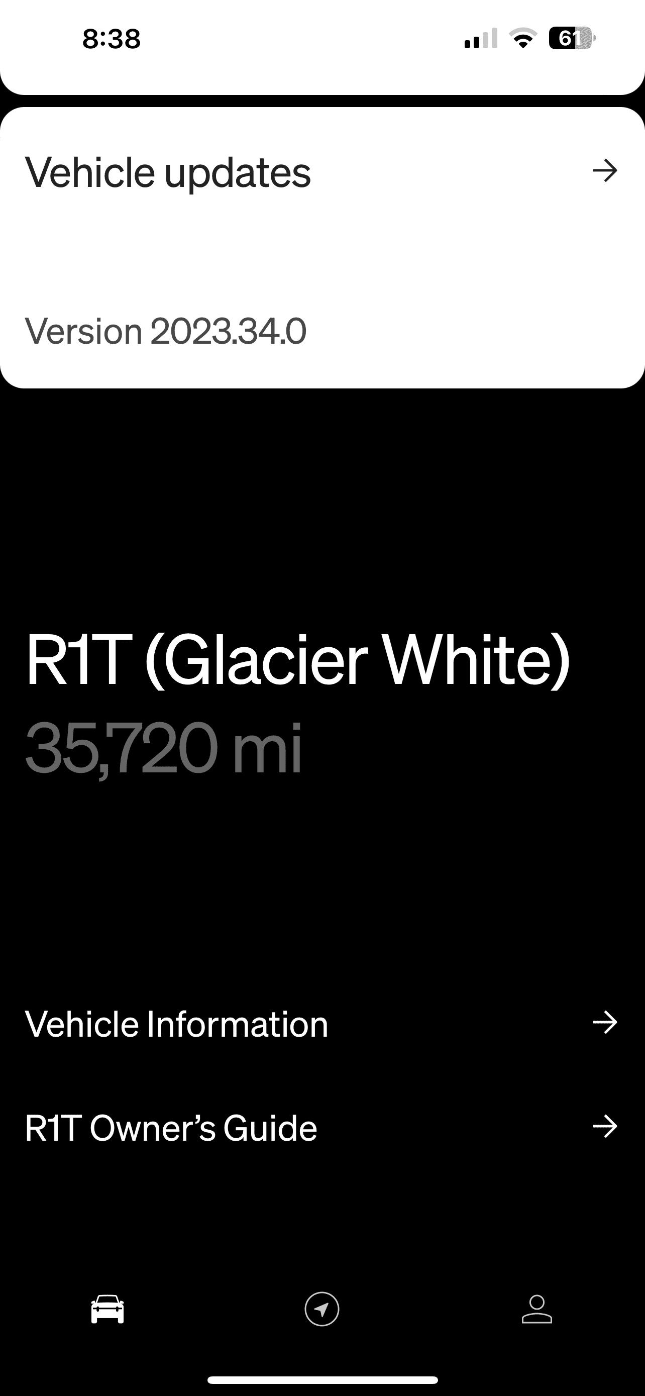

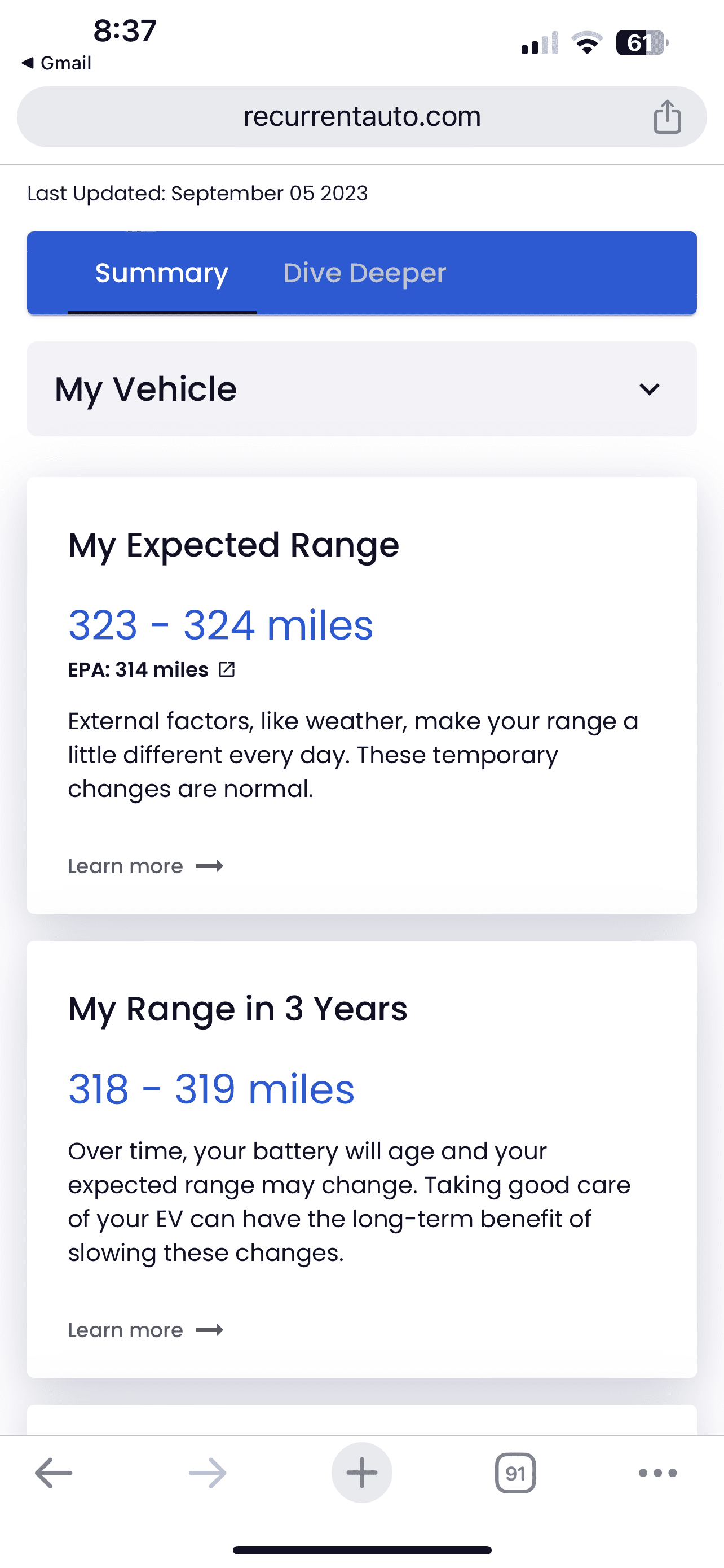

Have had my truck for about 14 months now, according to recurrent and my target range seems like my battery health is doing pretty good. Set daily charge to 70%, full charge about 2x a week for longer road-trips for work and DC fast charge about 1-2x a week on those trips.

that is awesome. Need more reports from other owners please.

But, on what wheels and drive mode?

I rotate between 20” wheels with agressive ATs and 21” wheels with the factory all seasons. My driving is a mix of all purpose, conserve, and sport. It gets very regular full throttle accelerations

Something doesn’t add up.
No way you’re getting expected 324 miles with that setup and driving habit.
Anyways, good luck mate.

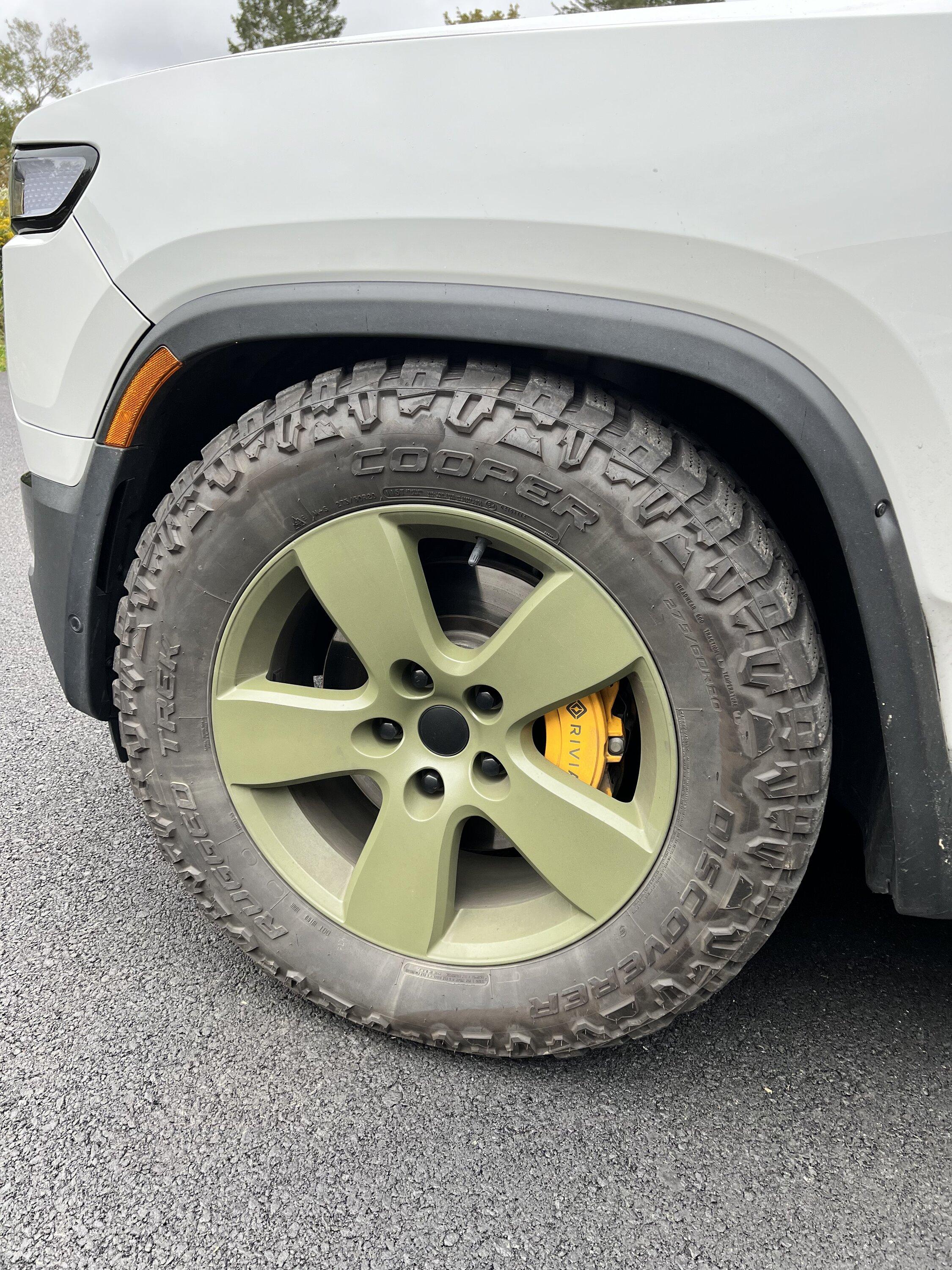

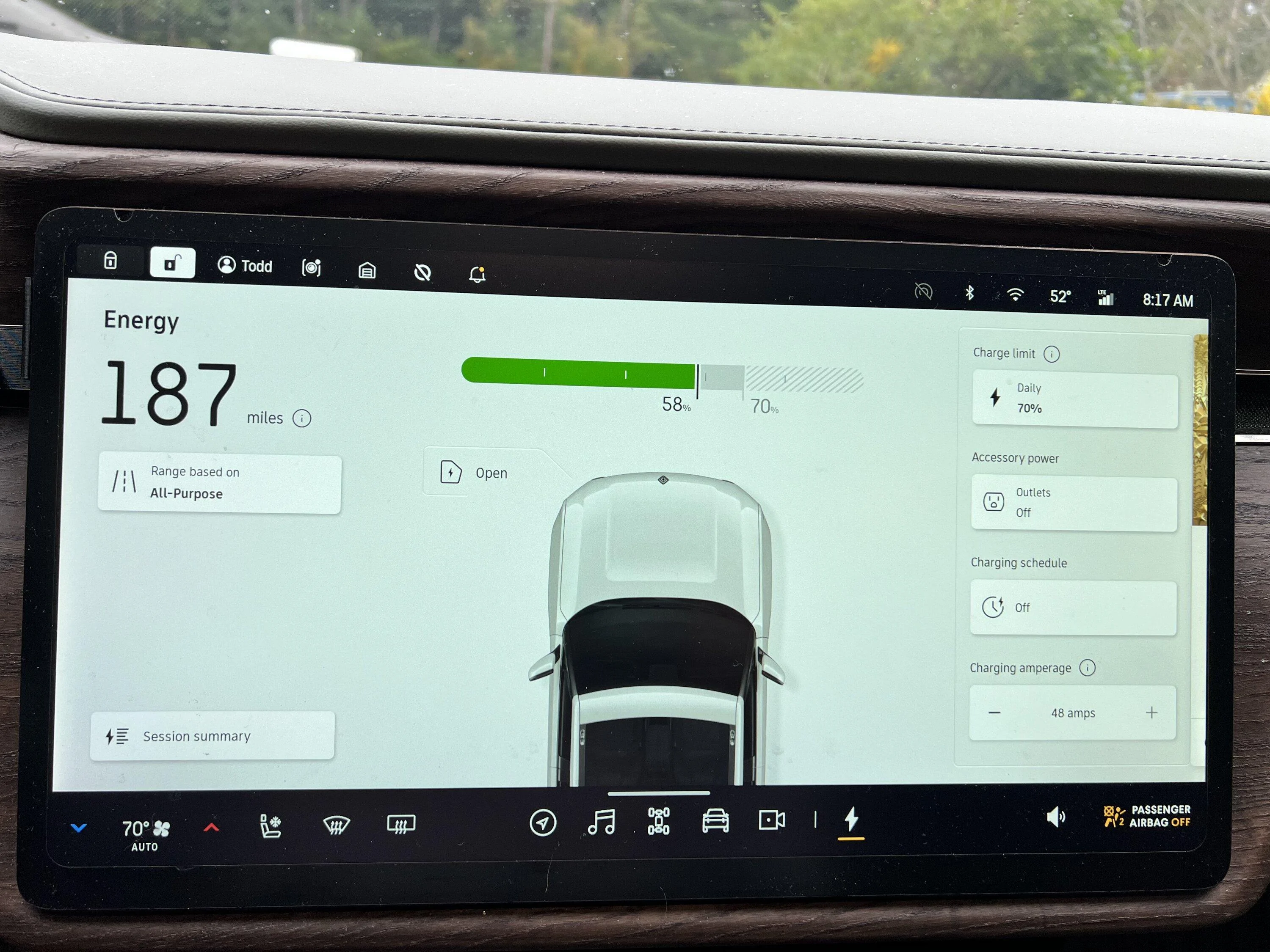

@R1TS 323 mile range at 58% soc works out 187 miles as shown so Recurrent seems pretty accurate to Rivian’s projections as well
Rivian R1T R1S Any Battery Degradation in your Rivian yet? IMG_6893
Picture of the wheels/tires for reference

To add clarity, I don’t get 324 miles in all purpose with those AT tires mounted. I’m down about 10% from that projection. With the factory 21’s in all-purpose I will get that. Overall use/split is roughly 30k with the 21’s and 5k with the 20’s.

On a side not, Did your 21" lasted 30K miles? or this is your 2nd set?

@LL75 - went back and checked my vehicle log and actual mileage split was more like 8,500 miles on the ATs and 26,500 on the 21”. The 21’s should have been replaced around 24,000.
