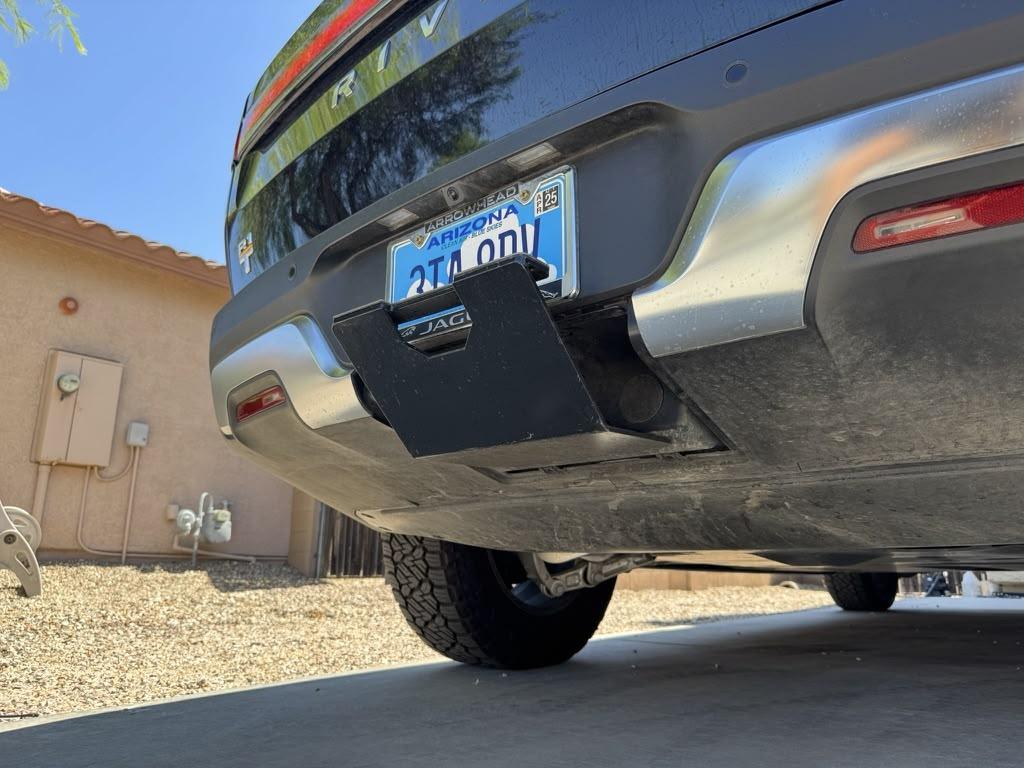

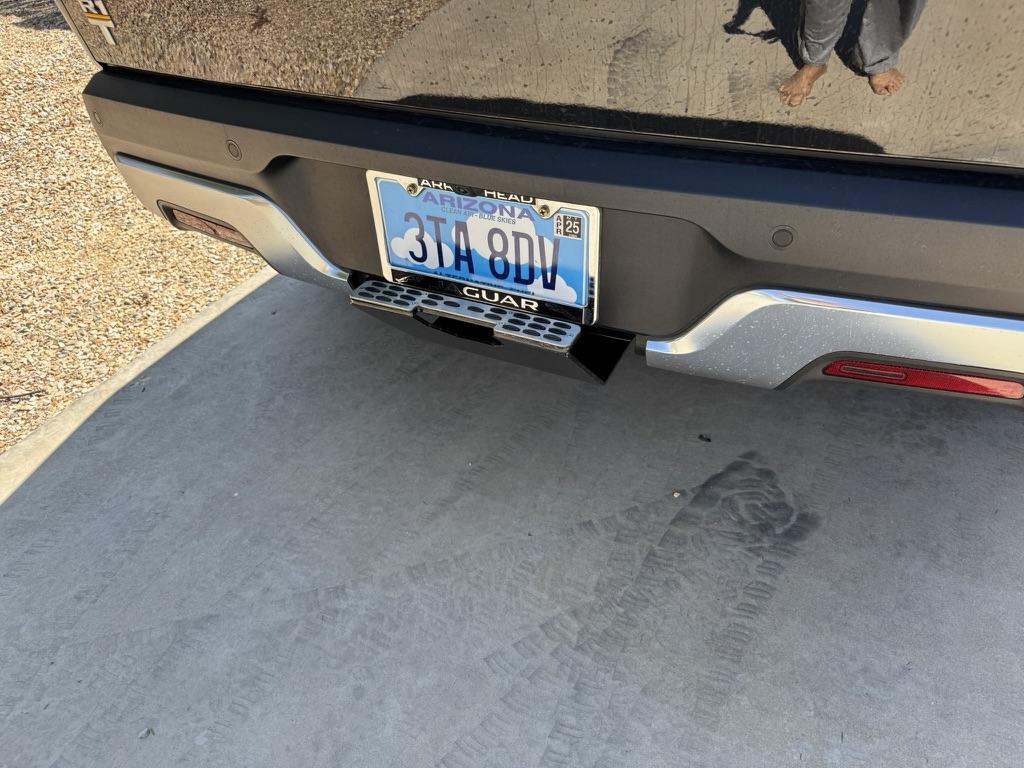

I bought my truck used and the cover was missing. But I've also had the experience, more than once, of someone bumping my vehicle while parking. Plus it's nice to have a step into the bed. Aaaannnd...those plastic bumpers will not do well off road if I bottom them out. So I did this for about $70...
https://www.amazon.com/gp/product/B09NVHVVRP
Rivian R1T R1S Any tricks on reinstalling the trailer hitch cover? 1729611725524-p5
Rivian R1T R1S Any tricks on reinstalling the trailer hitch cover? 1729611814143-o0
Protection from all of these problems and a nice step.
