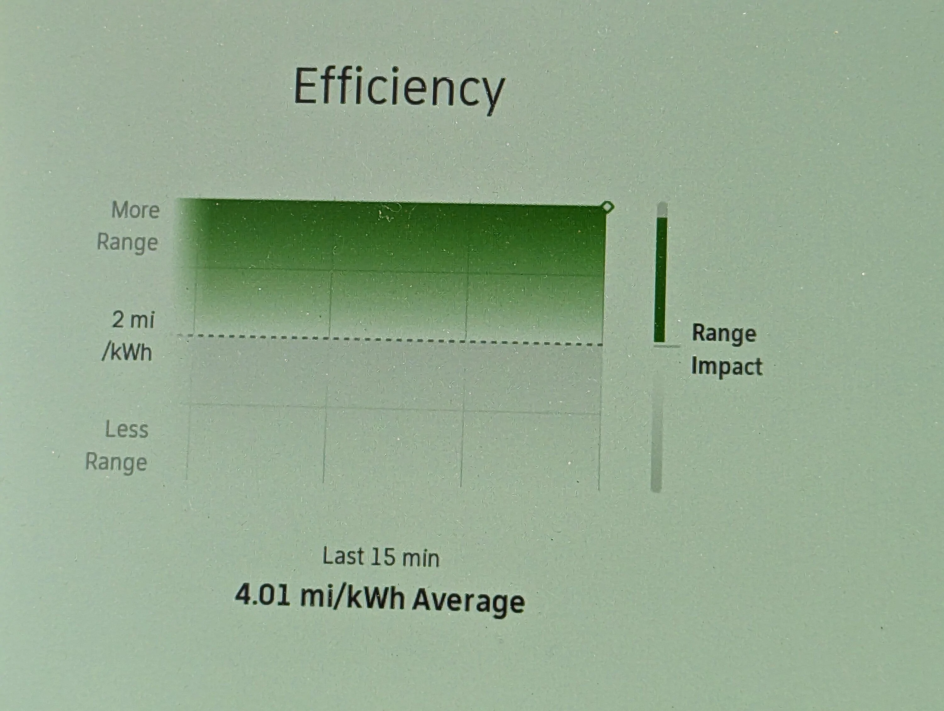

dgennetten
Douglas
May 4, 2023
151
204
Fort Collins
Retired Electrical Engineer
Rivian R1T R1S Bad Efficiency Getting Worse? 1000002532
On a different note, I enjoyed experiencing this all the way down from Chambers Lake (West of Fort Collins). I wish it didn't peg at 4.01, though I understand the math/dataViz justification.
What I didn't expect was much higher efficiency during the half-hour of in-town travels after coming down from the mountains. I cannot make sense of it.
