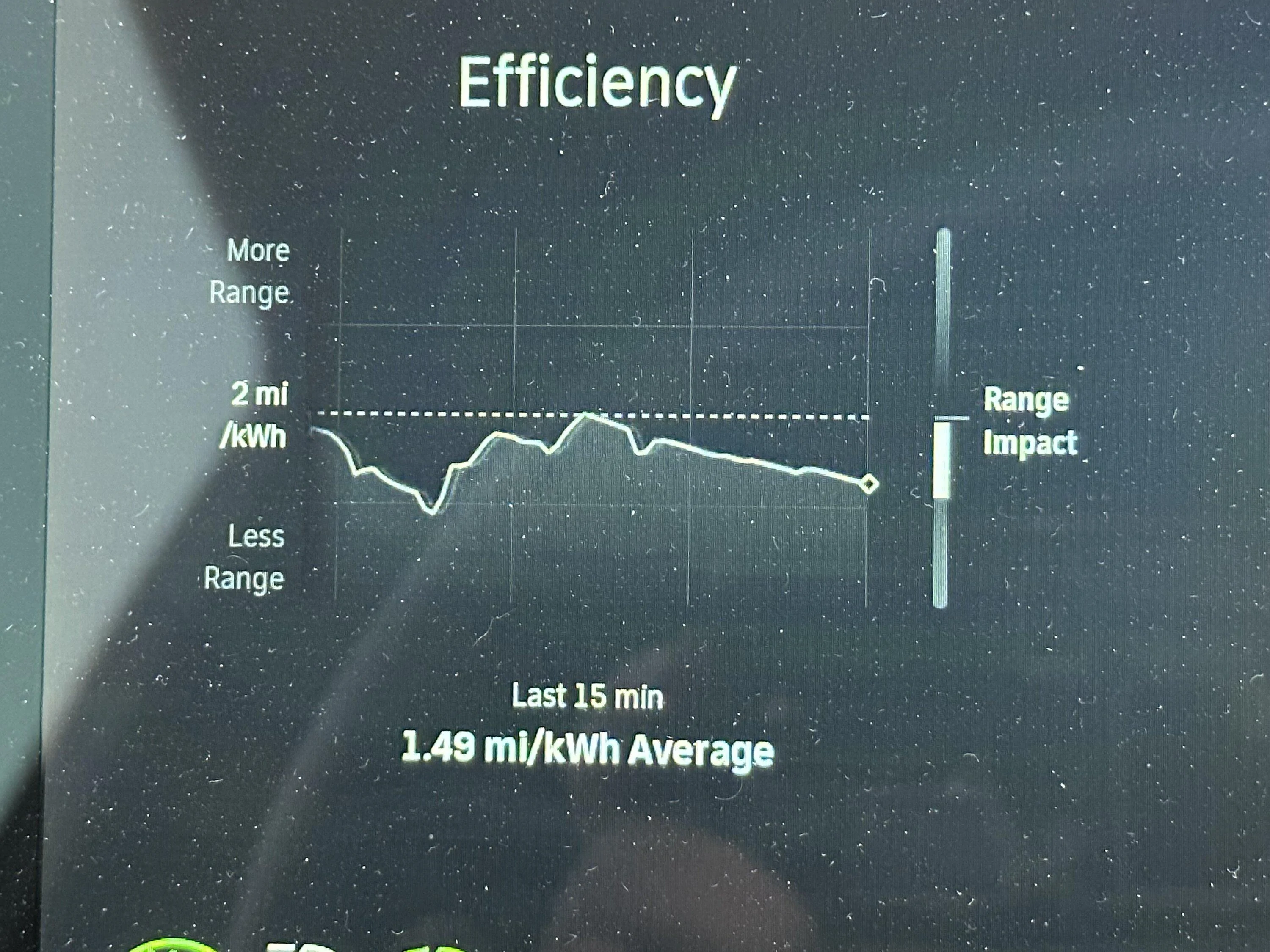

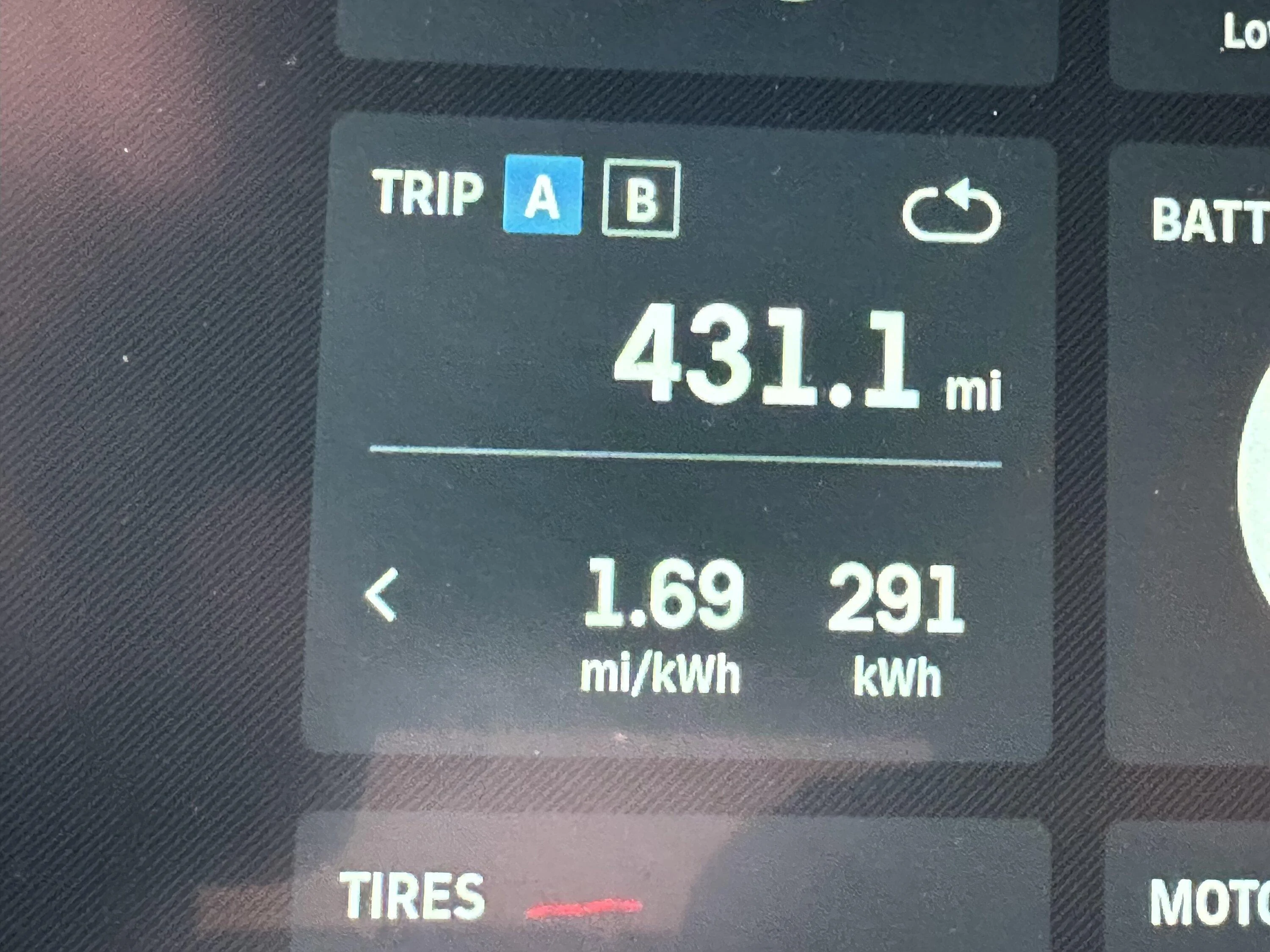

Not impressed with my efficiency… and it seems to be getting worse.
21” R1T
Yes, the temperature has dropped recently. Today was 55. We had our first freeze last night.
For the last 400+ miles, I’ve not been able to break above 2.0mi/kWH. It’s like the mid line is a brick wall for my truck now.
I have all these new meters and can’t correlate any reason for it. Battery, mostly has been 75 +/- 10. Motor temps not interesting.
Anyone else?
My Trip B meter is at 2.11mi/kWH over 13k miles. Total log 14.5k miles.
So strange. I am getting 2.3-2.5 even in 30-50 deg weather.

temp is one thing, there are many other factors:
speed, altitude, load, tire, road condition.
but if there are any doubts, should submit a service ticket, local tech should have some ideas.

Watching this thread as ive only been in my R1T for four months now, so first winter here, and have noticed my guessometer in the drivers cluster will drop up to 20% beyond actual miles driven lately... I was just about to start documenting this for more detail thinking this is abnormal.
I plan to track: ambient temp & battery temp at start (which will indicate garage or outside kept, as we share a spot) and end, cabin temp or off, how leadfoot i drove (low/med/high), and now reading this post, tire pressure too.
Hoping to graph some correlations on most impactful to range loss.
Should i track anything else?
Or is this normal expected behavior that the guessometer drops faster than the odometer in <ideal conditions?

Check your tire PSI and make sure you are inflating back back to factory specs. Cold weather causes tire pressure to drop an you are likely hurting your efficiency.
Cold is obviously going to impact as well.
My loaner truck one 20's has 44 psi tires and is getting far better efficiency than OP's truck, which is mostly short trips.
44 psi isn't that far off the OEM recommendation or am I missing something?
Shorter trips should definitely result in better efficiency because of the high amount of regen.
maybe altitude gain/loss and wind speed..
and.. i think gauge is good enough for recording efficiency but i also notice that it does not go above 4. just to say it has its limitation.
Wind speed and direction. Road conditions (dry, wet, snow). Weather (rain, snow, sunny, cloudy)

Have seen the same in R1S. down from mid 2s to high 1s. Guess it's likely running the heater on short trips.
