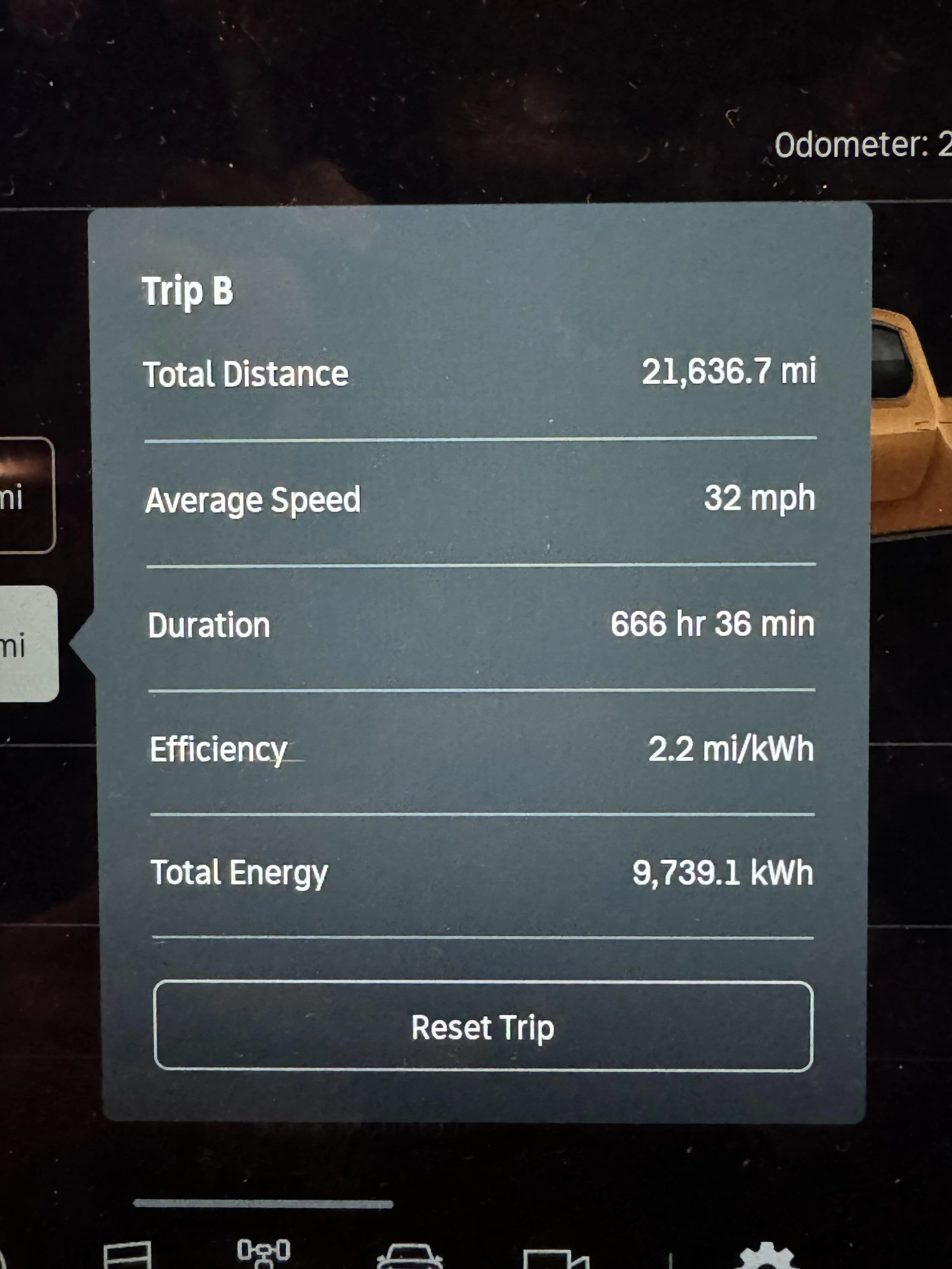

I’m at 2.2 mi/kWh over the last 21k miles, also on 21s. I took my truck into the service center and had them look at my efficiency because I started seeing things get worse this summer. And even now with a warm battery fresh from charging, no cabin heat, and in-town 45mph driving I cannot break into the green on the efficiency graph. SC said everything was normal. Even had engineers in Normal look at the logs.
Tires always at 48 psi cold (garage compressor with hose reel and inflator with gauge makes it easy)
No RTT or cargo bars
Generally drive pretty normal - same pace as other traffic
This summer I’d be cruising 65mph on the interstate (in the city, with traffic) and would be maybe max out at 2.3. I’ve never seen anything above that on the highway at any speed.
I feel like the guys running 20” A/T getting 2.4 are just fucking with us.

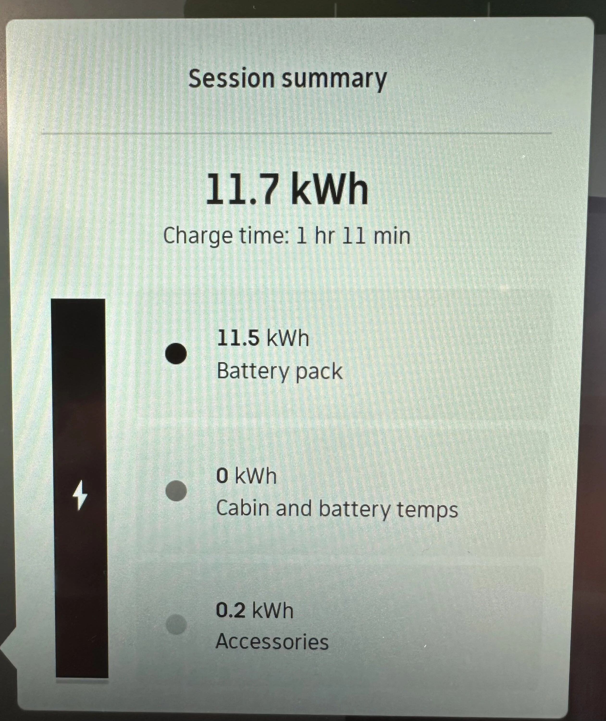

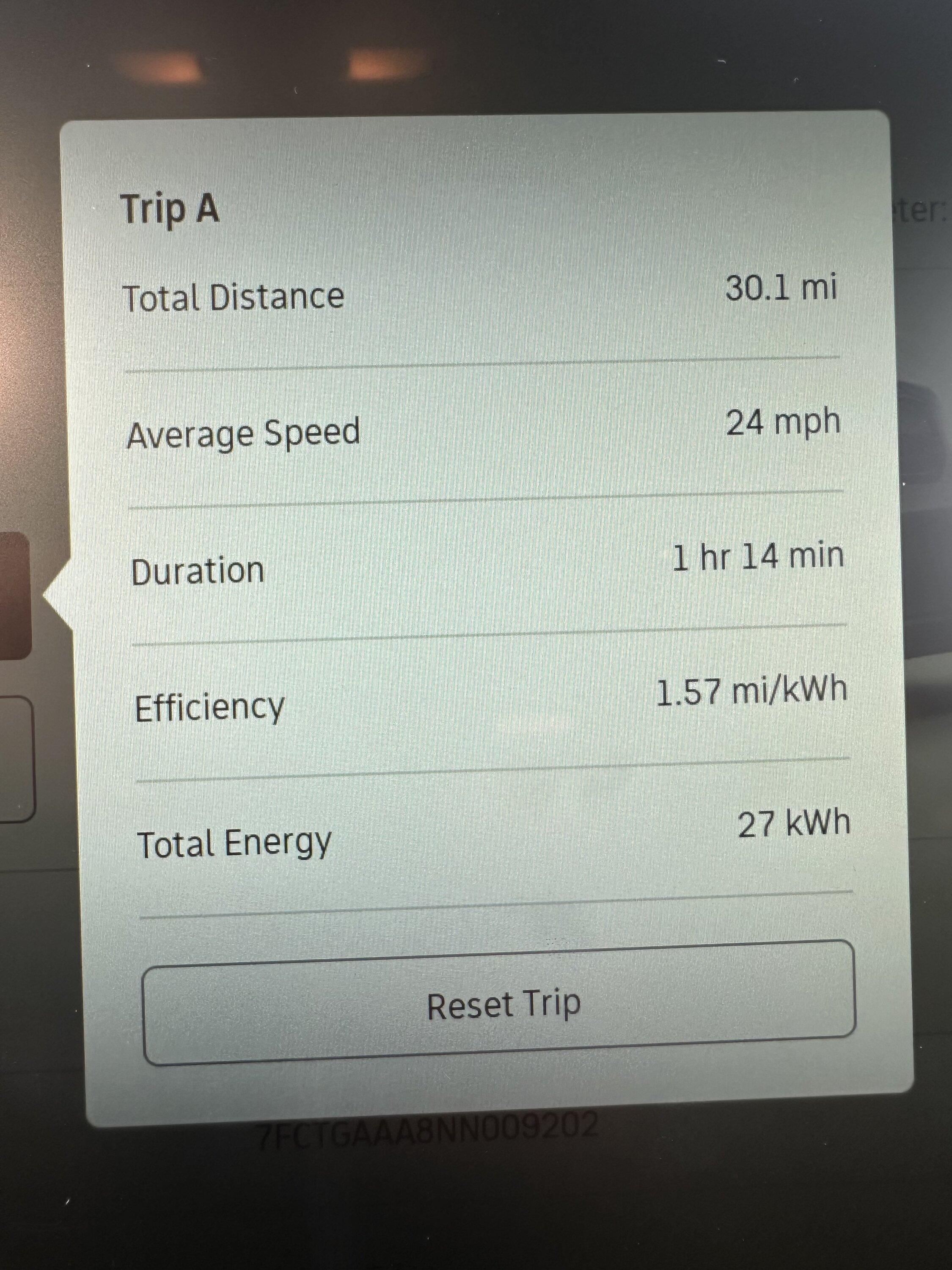

I have no idea what’s going on anymore. Had some warm days here locally and drove around without any AC or heat of any kind. Was finally getting into the green again.
So I reset my trip meter. Last 500 miles averaged 1.65 - abysmal. People with tractor tires reporting 2.4 around here. :)
After resetting the meter, last time I drove I was averaging 2.1 over 25 miles. Came back to the car today after charging overnight (and not reaching the charge limit thanks to 3 month old bug) and my trip meter says 1.55mi/kwh. Charging session says no energy was used to heat battery or cabin.
Look at this. If I divide miles by kWh, it’s 1.11. So where is it getting 1.57? And how did I go from 2.1 to 1.57 while it sat in the driveway?
Starting to think this meter has gone bonkers. Cause guess what, since I’ve posted this thread my lifetime meter has gone up from 2.11 to 2.12
I feel like I don’t understand how averages work anymore. Averages don’t increase when you factor in lower numbers to them.
