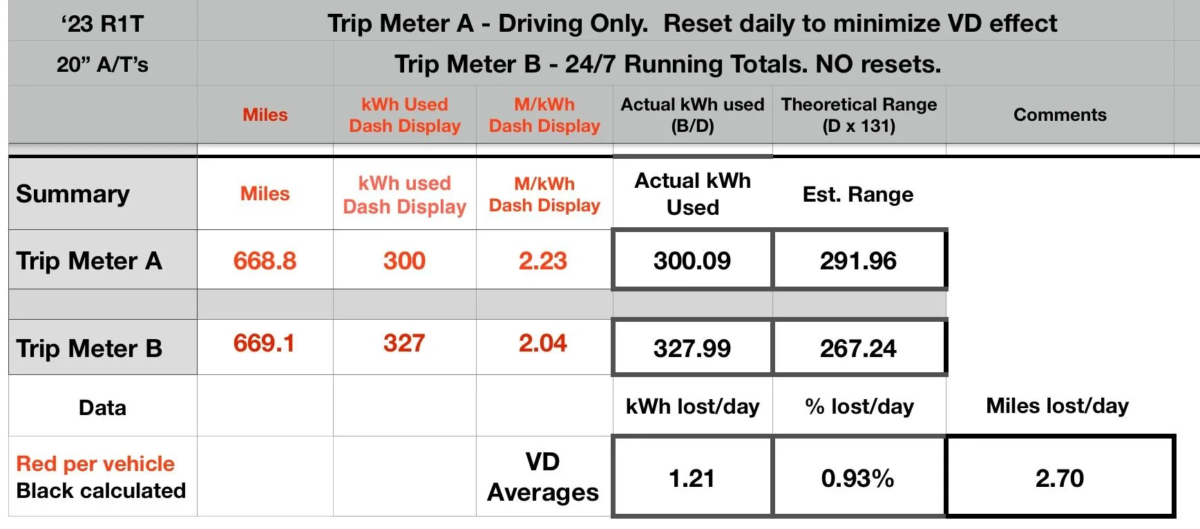

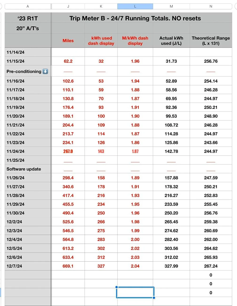

Now, this is interesting. As previously noted, I’ve been tracking my Vampire Drain for the last few weeks, by comparing Trip Meter A (reset daily) to Trip Meter (constantly running). Surprisingly, since the latest software update 2024.43.01, it sure appears that my Vampire drain has been diminishing. Before the update, my Trip Meter B was pretty consistently showing projected range in the mid-240 miles (Note the column on the right in the attachement).This figure was well below my the Trip Meter A projected range, as it included VD when the vehicle sat overnight. Since the update, that Trip Meter B figure has improved every single day, now sitting at 267 miles. My VD miles lost per day has dropped from around 4 to about 2.70. VD is now accounting for a loss of only 1.21 kWh/day or a 0.93% battery loss.
Is this a freak thing or did Rivian sneak in a significant energy management solution with this last software upgrade? Anybody else noticing a change.

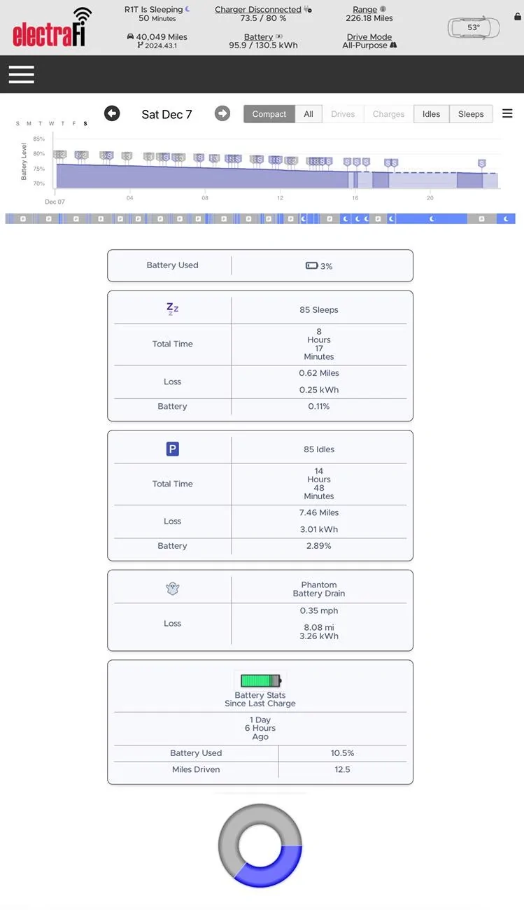

I got the software update earlier this week, and am not seeing a measurable decrease in my VD. I’m tracking on ElectraFi and still seeing an absurd amount of idle and sleeps.
Something appears to be on/running during your sleep cycle's. The vehicle should not experience drain when sleep.

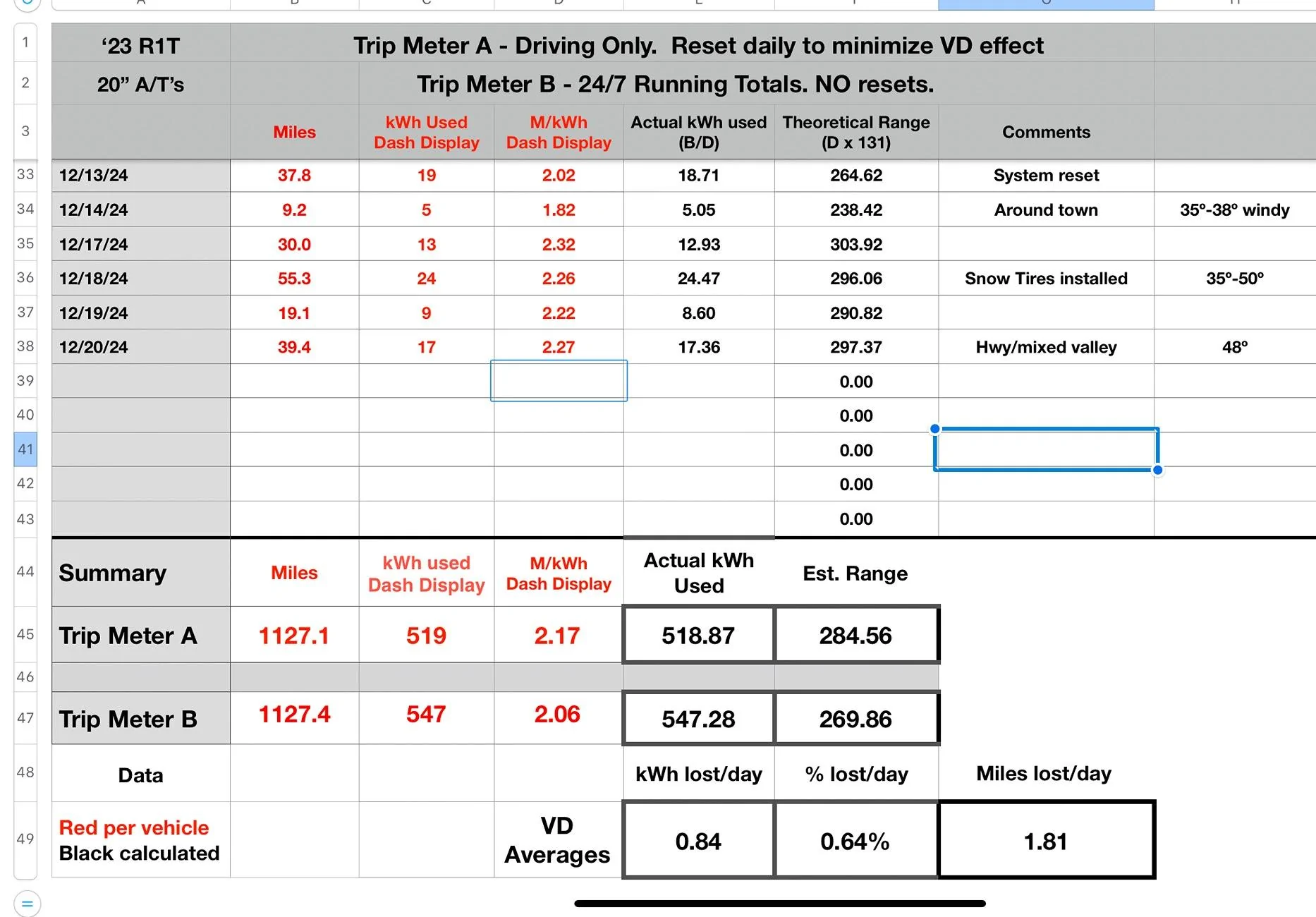

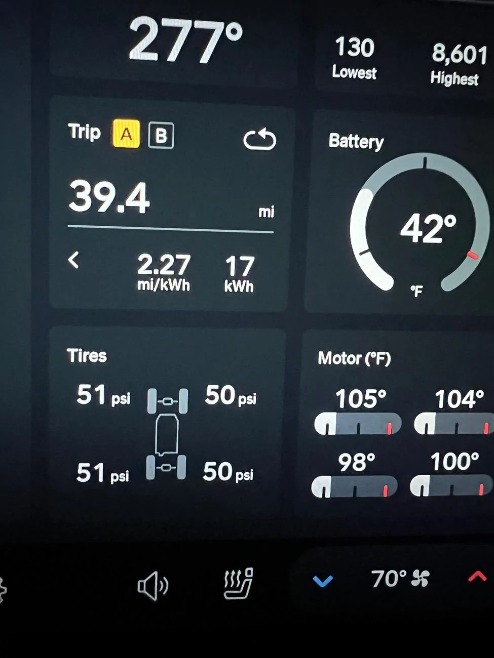

I’m not sure about .47, but it sure looks like it’s getting better. In fact, since .43, the gap between the long term trip meter and daily trip meter has really stabilized. I wasn’t expecting that. Comparing the two, as of today, the average loss for the last 34 days is sitting at about .84 kWh, .64% and 1.8 miles per day - and slowly dropping. The gap between total kWh used (daily driving vs. long term) since 11/14, is sitting pretty steady at about 27-28 kWh. My previous post from 2 weeks ago showed a 27 kWh difference. So, basically, no change in 2 weeks. This is incredible. Based on that info, there has been no drain over that two week period. That can’t be possible, but I’m going with whatever data the car is giving me. I’m wondering if Rivian has found a way to remove vampire drain data from the long term trip meter. This is something I have always wanted and requested from Rivian. In the last couple of days since I downloaded .47, I have been getting very good daily driving efficiency, especially considering less than ideal weather, and it seems to be trending up. In fact, since .43 and continuing with .47, all numbers seem to be improving. Attached is shot of the last 6 days, with the totals for all 34 days.
Don’t know what Rivian did, but I’m liking it!
On a side note, for a while during this experiment, I was preconditioning the battery in the morning. I thought this would help my range. I have since stopped doing that. It didn’t seem to offer any advantage. Now, as with today, I take off with the battery temp often in the low 30’s. After about 30-40 miles, the temp is up to about 40ish and my driving efficiency still seems great. Go figure.
