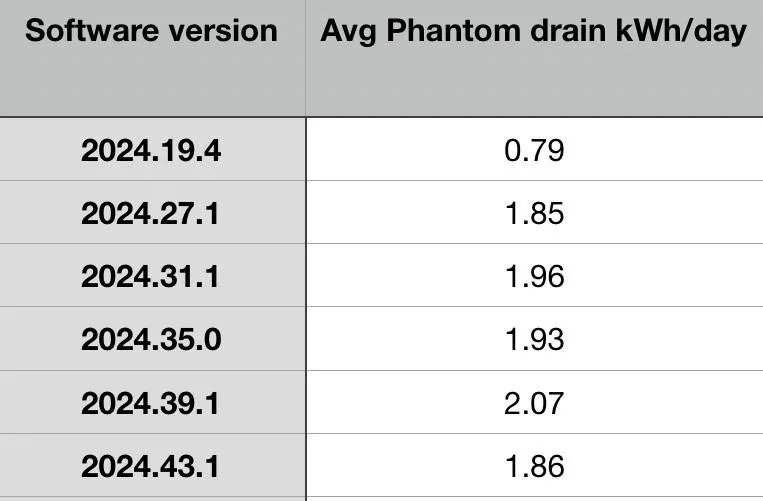

I’ve been logging my daily phantom drain from electraFi since late July, 2024. Version 2024.19.4 was fantastic. Except for 2024.39.1, gear guard was turned off during data collection.

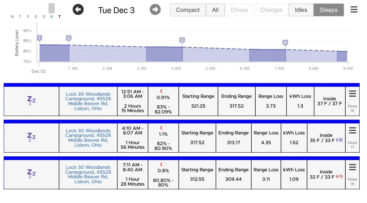

Got my 2025 R1T gen 2 about one month ago and love it but been noticing some wicked phantom drain.
Just got Electrafi and here stats from last night:
3.91 kWh/ 11.91 miles loss in less than 8 hours.
This can’t be expected loss can it?
also, can someone tell me what the gap-times between “sleeps” represent on Electrafi? Does this mean truck was awake the whole time?

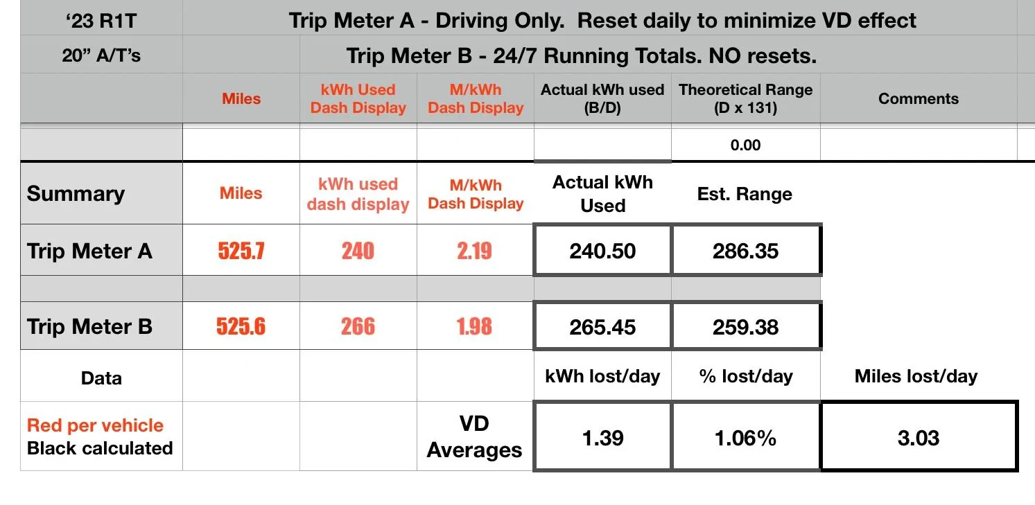

I agree, 10% daily loss is nuts and unacceptable. I’ve been closely tracking my ‘23 R1T for the last 3 weeks, comparing daily usage data (Trip Meter A) to long term data (Trip Meter B). In this way, I can see how much vampire drain I am getting. So far, this is what I am seeing. I have gear guard off at home.
