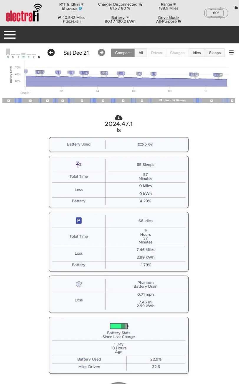

ElectraFi is very handy for tracking everything.
I don’t have .47 yet (not a C+ subscriber) but VD did seem to improve slightly with .43. I don’t have quite as many sleep/idle cycles, but still way more than I used to. It looked much better until today, actually. Had like 30 sleep cycles the other day but now back up to the 60s ?‍♂

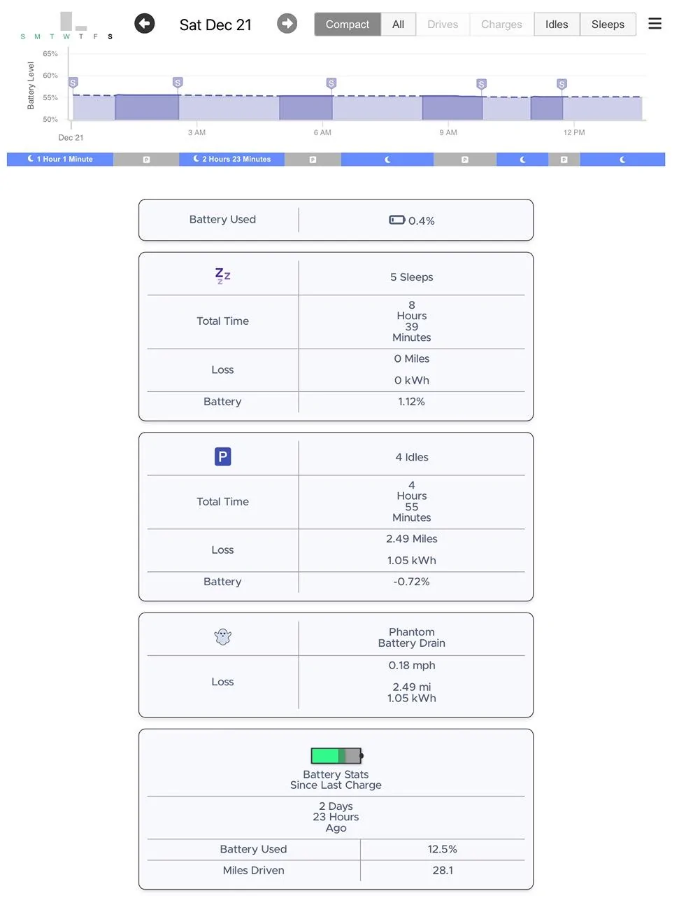

Interesting. You have a lot of idles. Here’s mine.
Yeah that’s what I was used to seeing. I have a service appointment still because it’s baffled Rivian in their remote diagnosis. Many people are saying it’s a sign of my 12v batteries going out. ? but it’s odd that it coincided with a software update from October when it started this behavior (.39 I think?)
