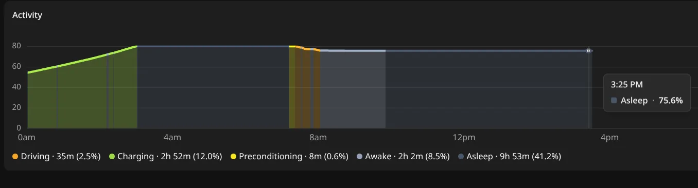

anyone notice a crazy amount of drain ever since the latest update 2025.46? mine seems to wakeup every 1-2hrs again, even with the tender going all the time
Definitely OK around here

R1S LE - 22"
argh, i wonder if my 12V is nearing death again. had it replaced via warranty about 14mo ago and had a 12V warning message a few times over the last few months, but service said it was just a random blip
I did have issues with the truck not sleeping and loosing large amounts of energy while parked (5 kWh in 1 hour). Only happened after .46 update. Turns out some bluetooth sensors were never functioning properly and with .46 it started causing issues. The service center reprogrammed the sensors and all is well now. They also gave me a new 12V!
