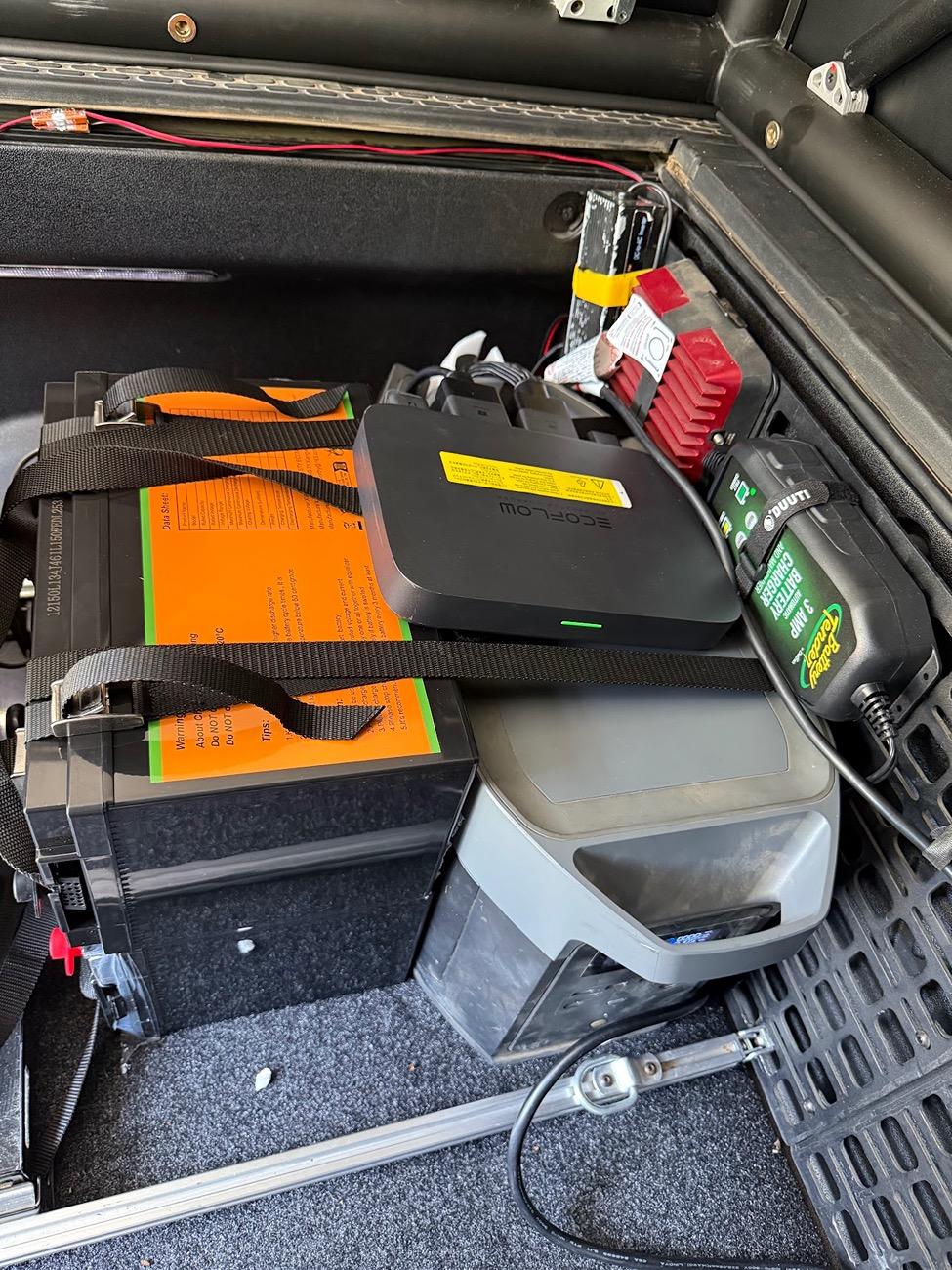

Thanks to everyone who’s contributed to cracking the vampire-drain problem – I finally seem to have solved it (at least on my end). Below is my setup and the results of an eight-day test. I added links to all the items in my setup.
Result: 1 % total vampire drain on the high-voltage pack over eight full days parked while I was out of the country. 6 kWh consumed from my external LiPo battery system that lives in the bed that powers the 12v OBD charger. 2023 R1T Version 2025.10.01. Parked outside in moderate weather.
I know it’s pretty convoluted (and absurd that we have to go to these lengths!), but if you’re heading off-grid for a while, this works really well.
My chain of components:
OBD battery-tender connector
12ft SAE extension cable
→ wire routed along the floor then behind the back seat through the tonneau-cover cavity (I don't have a powered tonneau.) It exits in the bed. (if you have the powered cover, route around the felt in the gear tunnel)
3Amp Battery-Tender charger
→ small 12v DC→110v AC converter (the smallest you can find.) I had an old one lying around so no link for this. You could plug the battery tender into the ac ports on your power station but they will consume more power than using a small external converter via the dc jack. You only need around 35watts of 110v power to power the obd tender.
→ EcoFlow Delta 2 Pro power bank (2kw)
→ EcoFlow alternator charger
→ two 150 Ah, 12 V LiPo batteries in series
When I charge my Rivian, I turn on the outlets. That charges my Ecoflow in the bed which charges my external LiPo batteries using the Alternator charger. When it's done charging, I switch the alternator charger to pull power from the external batteries to charge the Ecoflow. That gives me about eight days of power for the OBD battery tender.
Instead of losing around 20kw of power from the high voltage pack to vampire drain over eight days, I lose 6kw from my LiPo external system. Of the course of a year, that's about 640kWh in savings. What an embarrassingly stupid waste. The side benefit of this system is that it also gives me a much more efficient power supply when I'm out camping. Keeping the Rivian's 110v outlets on wastes a huge amount of power at idle.
Rivian R1T R1S Phantom / Vampire Drain Solution Works! Using 12v Battery Tender IMG_7971

Great outcome but a creative yet convoluted solution. Sad you had to go to such lenghts. At the same time, it is absolutely ridiculous that we have to do this to minimize vampire drain. I had no idea how bad it really was until I owned my truck.

I know. It's nuts. The vampire drain has infuriated me from day 1. The amount of waste is scandalous, especially from a brand that likes to tout its environmental responsibility. There are so many awesome things about the truck, I just can't believe they screwed this up so badly.
I had the Ecoflow anyway and got a crazy deal on the lipo batteries to the overall cost wasn't that high. It's nice having the extra capacity for camping but the truck is a giant battery anyway so none of this should really be necessary.
