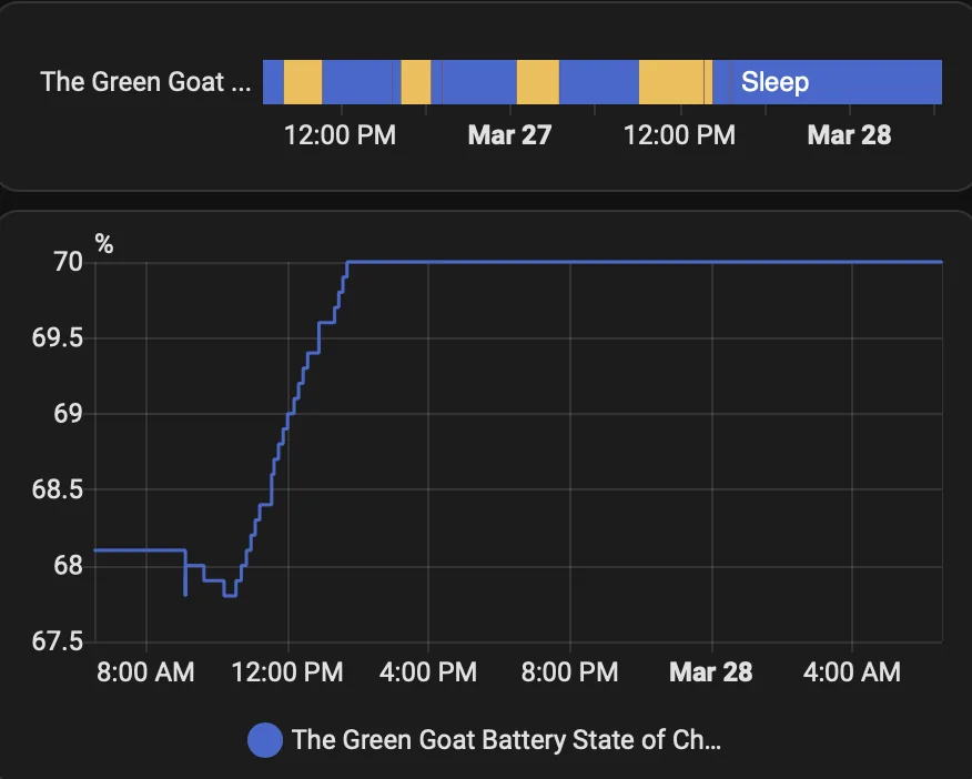

DJ
I have a 2022 R1S and yesterday plugged in a 800ma Battery Tender charger with Battery Tender OBD2 charge adapter. R1S has been sleeping for 16 hours so far and no vampire drain. Lately I have been seeing 4-6 hours of sleep and ready state for 2 to 3+ hours. I have a green light on the Battery Tender.
Rivian R1T R1S Phantom / Vampire Drain Solution Works! Using 12v Battery Tender Screenshot 2025-03-28 at 6.32.19 AM
Here is what I am using.
Battery Tender Water Resistant 12 Volt Battery Charger and Maintainer: Automatic 12VBattery Tender Water Resistant 12 Volt Battery Charger and Maintainer: Automatic 12V Battery Charger and Maintainer for Motorcycle, ATV, and Personal Watercraft - 12 Volt, 800mA Battery Float Charger - 022-0150-DL-WH
Battery Tender OBDII Adapter Cable for 12V Battery Charging - 22 Inch Cord - Solar Compatible - Charge Vehicle's 12V Battery Through OBD II Port - 081-0154-DL
