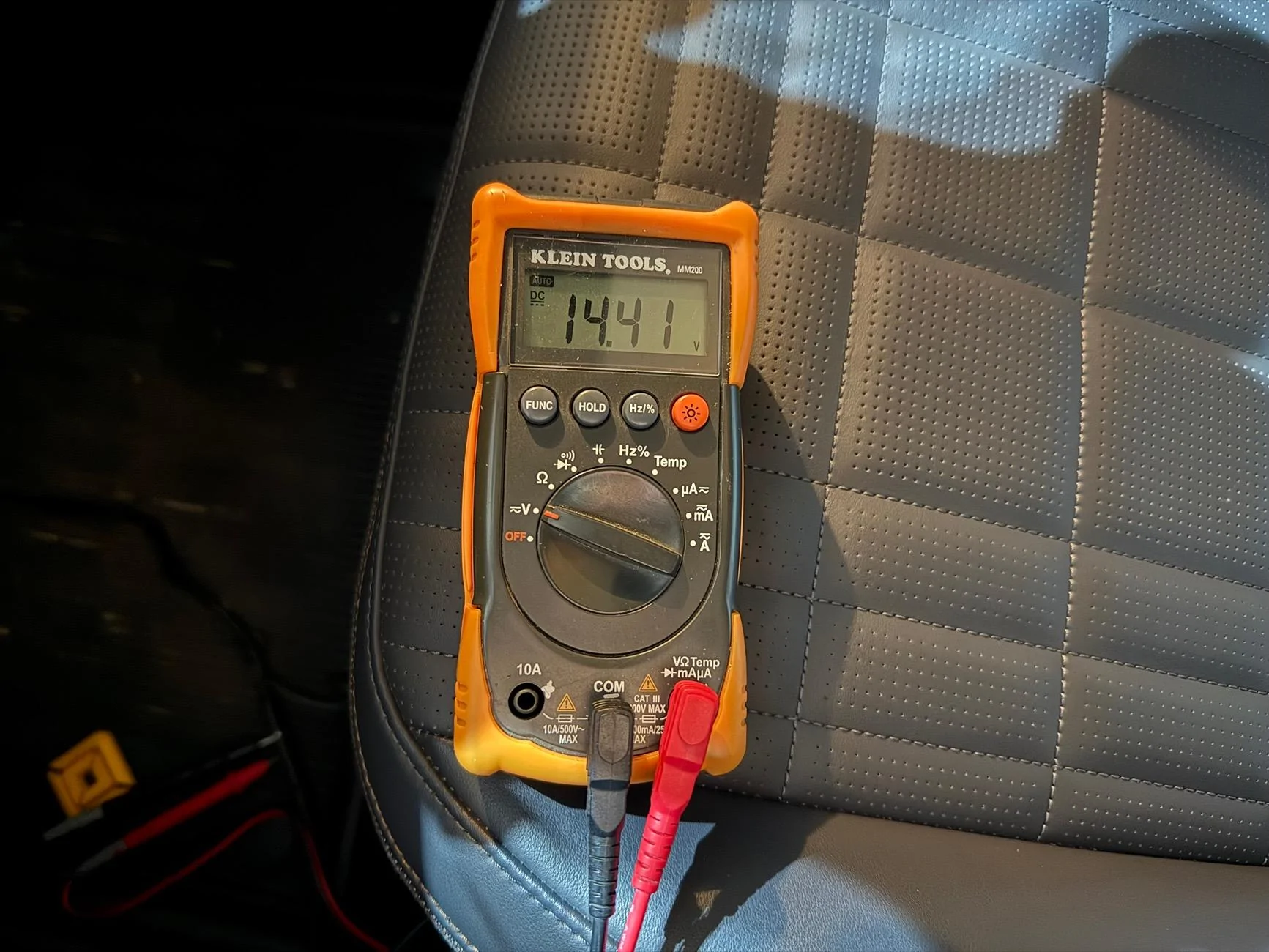

I have been experimenting using a battery tender through the OBD2 port. With the latest update I have noticed that our G2 R1S is keeping the 12v battery at 14.4 volts even when sleeping. I can't imagine the battery will last long sitting at a high voltage. Float voltage for an AGM battery is between 13.2v and 13.6 volts. Attached pic is with no charger attached and car sleeping for over an hour. Anyone else notice this after the latest update?
Interesting and weird. I can see my Gen1 voltage dropping to ~12-ish while not charging and 14.3 when charging/awake.
I do measure directly from the leads on the battery though. Are you sure that your truck was sleeping even with the door open? I'd validate that with ElectraFi or with the app icon

I had the window down so I could measure the voltage without waking it up. Confirmed on the app that it was sleeping when I took the measurement. Before the latest update our G2 behaved exactly as what you experience on your Gen1.
My battery tender has a voltage display and when it went to float mode it was reading high voltage. That's what clued me in to the change.
Hopefully I can let it sit for a few days with the tender attached and see if the voltage ever drops. Maybe this is a special AGM battery that can handle a constant absorption charge.
I will also check directly at the battery to rule out the OBD2 port somehow having isolated high voltage. It's my understanding that the OBD2 12v positive is direct to the battery.
Keep us posted.

Hard to know but maybe a constant voltage of 14.3 to 14.4 volts will allow these batteries to last longer than the constant drain and recharge approach. I'm very interested to know if the latest update changed how V1 vehicle behave.
I don't see any need to keep our R1S on a tender if it's getting a constant charge. In fact, the tender might be a bad idea
