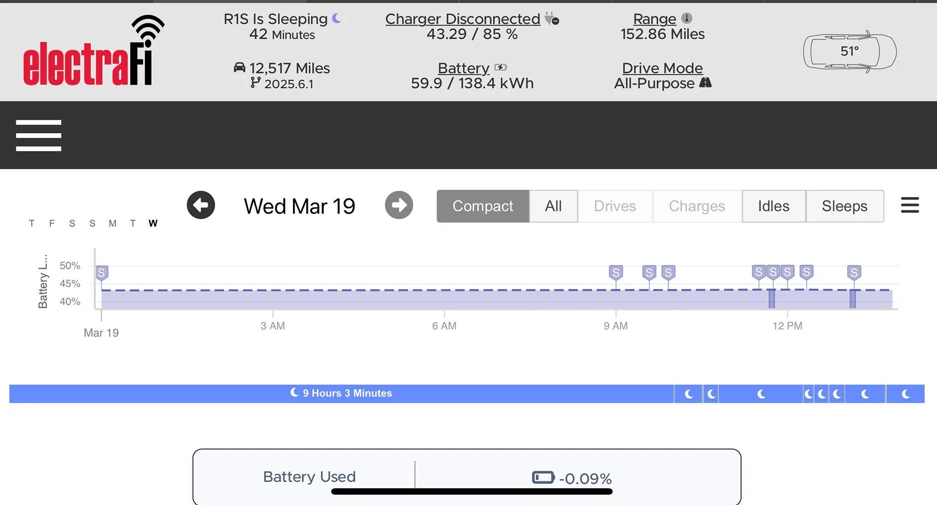

I've finally caved and put my R1S on a NOCO 2A battery tender through the OBD2 port. I can't go another day with a ridiculous 2.4 kWh of phantom battery drain.
Well, I was a bit disappointed when the first couple days went by and I was still burning around 1.6-1.9kWh a day after putting it on the 2A battery maintainer, but maybe today is the first day the battery got fully topped off without interruption? Today's graph shows an almost non-stop state of sleep, only waking up for brief moments that coincide with when I walked by the vehicle to leave the house. So far it's showing 0.00% loss, which makes sense as the vehicle hasn't been awake for more than a minute or two at a time all day.
Rivian R1T R1S Phantom / Vampire Drain Solution Works! Using 12v Battery Tender 1742417774078-lr
That appears to be my observation as well. I use a 3A charger, but still see 1 to 2 events every other day where the vehicle wakes up and stays awake for 2 to 3 hours without any PAAK or fob waking up the vehicle. Still frustrating, but at least my VD is being somewhat kept in check.
I put it on the 2A battery tender on Sunday, and Monday and Tuesday didn't seem to change much; still had multiple wake events for a couple hours each day. Today is the first day I haven't seen a wake event *knocks on wood*.
I'll settle for one wake event every couple days if that's where my vehicle is at now, but only time will tell
