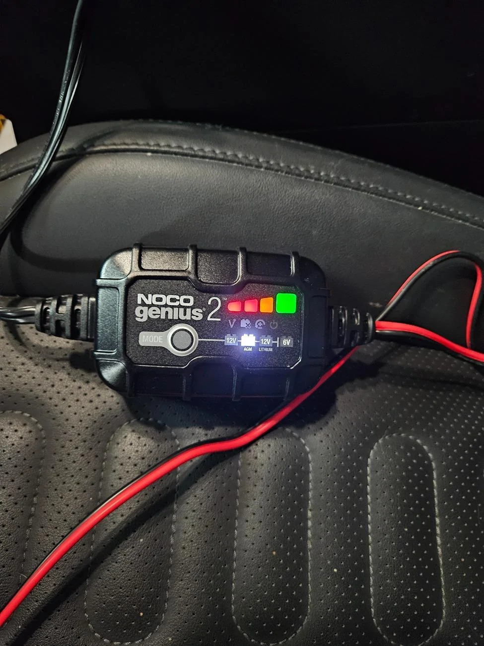

Long Term Test Update 4/11/2025:
I had my Gen 1 R1S parked in my garage for 13 consecutive days while traveling. Gear Guard was "Off at Home" and I did not use Shipping Mode. My 1 amp NOCO battery tender was plugged into the OBDII port. Temperatures were in the 50s (deg F). I remotely checked the status only 1 time.
I lost 9% (11.9 KWh) over this period. This averages to 0.69% per day, or 0.92 KWh per day.
While this is far below some of the horror stories on the forum of 2 to 4% per day, I have to say that I was disappointed. With the battery tender connected, I was hoping for something around 0.1% per day.
I am still baffled as to why my NOCO charger/tender never goes green, indicating a fully charged battery. It was still red after 13 days connected to a sleeping vehicle. Even though others on the forum have had good luck with similar 1 amp tenders, I may still invest in a 3 amp unit and see if I get different results.
It's also possible that my tender is working exactly as designed, and something in my vehicle is causing 12 V battery drain in excess of 1 amp.
More to follow....
Update 4/13/2025
I couldn't find a 3 amp charger/tender from a reputable brand that had the features I was looking for. So I went with the 2 amp NOCO Genius 2. That did the trick. Within 5 minutes I was in the green showing a fully charged battery snd maintence mode was starting.
Rivian R1T R1S Phantom / Vampire Drain Solution Works! Using 12v Battery Tender 1000006820
