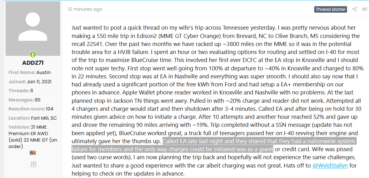

Just saw this posted on the Ford Mach-e forum. A user report of EA saying they has a "Nationwide system failure"
Rivian R1T R1S CCS charging not working? ***RESOLVED 7-27!!!*** 1658238487367
Wish that was the issue for me. Tried without the app and just a credit card. Rivian even got EA to start a free charging session all to no avail. I definitely tried a charge point the same day and a Greenpoint/she'll the following day each with the same issue. Not saying definitively it's the truck but sure seems logical to me.
