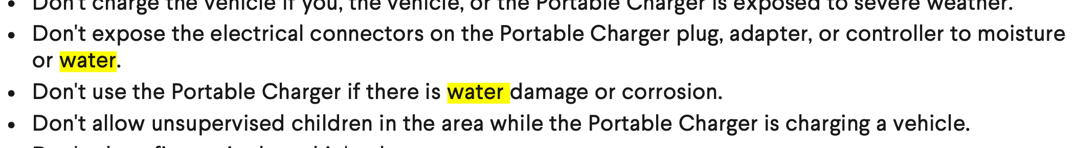

In fact the portable charger manual says not to use extension cords or use it in the rain.
Didn't the charger info page on Rivian used to show someone plugging in the travel charger in the rain? I'm in the hardwire EVSE camp for this guy, but I'm gonna call bull on this one. What's the manual actually say?
Rivian R1T R1S Charging at my cabin. 1700186057112
I think it is talking about the plug that goes into the wall and the charger itself. I think the end that goes into the truck is fine in the rain.
Oh now I'm following, yeah definitely don't plug it into an extension cord and leave that connection exposed in the rain. They have weatherproof housings for RV plugs for a reason.
Mine spent many, many nights in the rain and snow and never had a problem. It was my primary charger off outdoor 14-50 plugs for the duration of my R1T ownership.

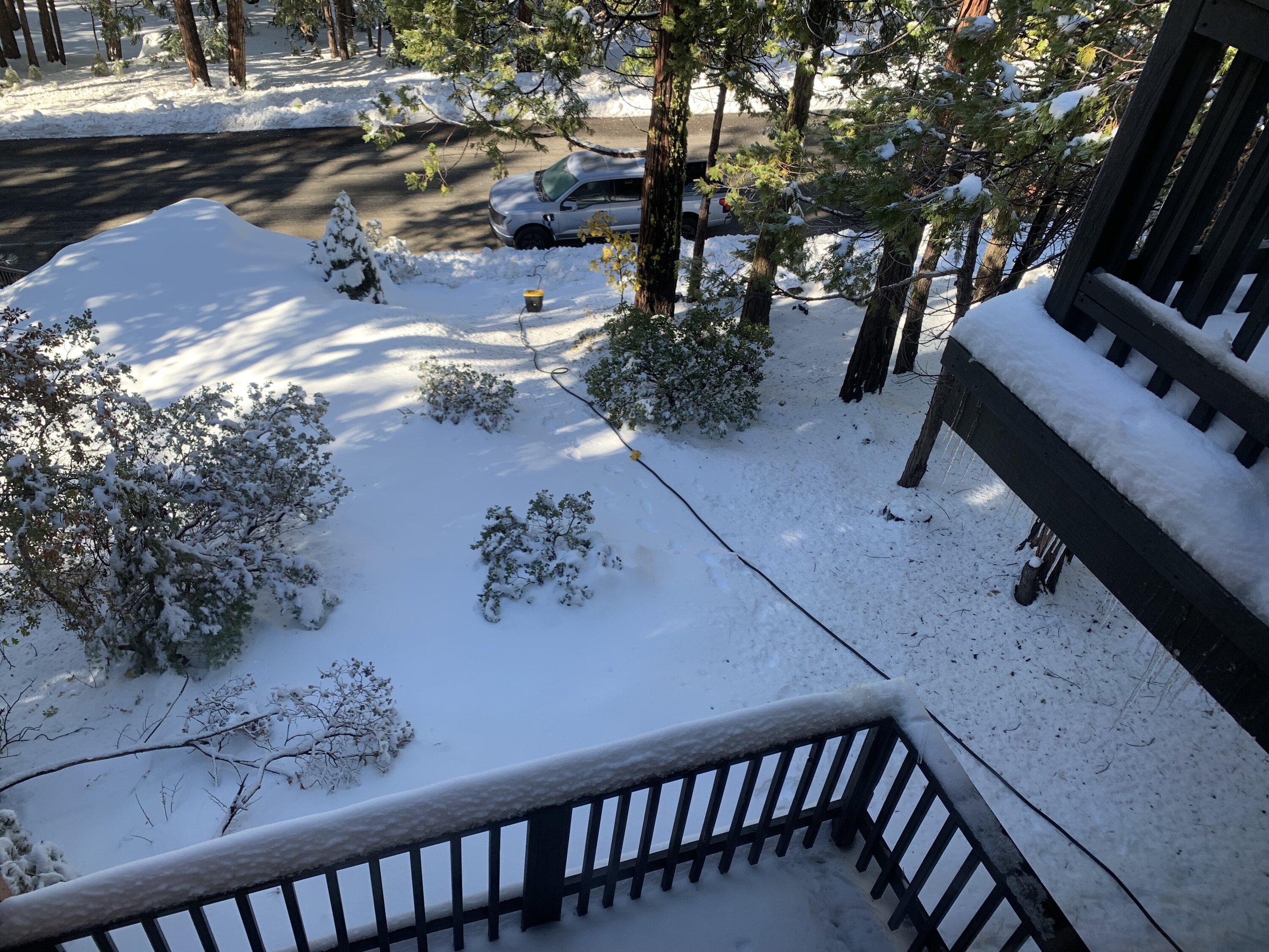

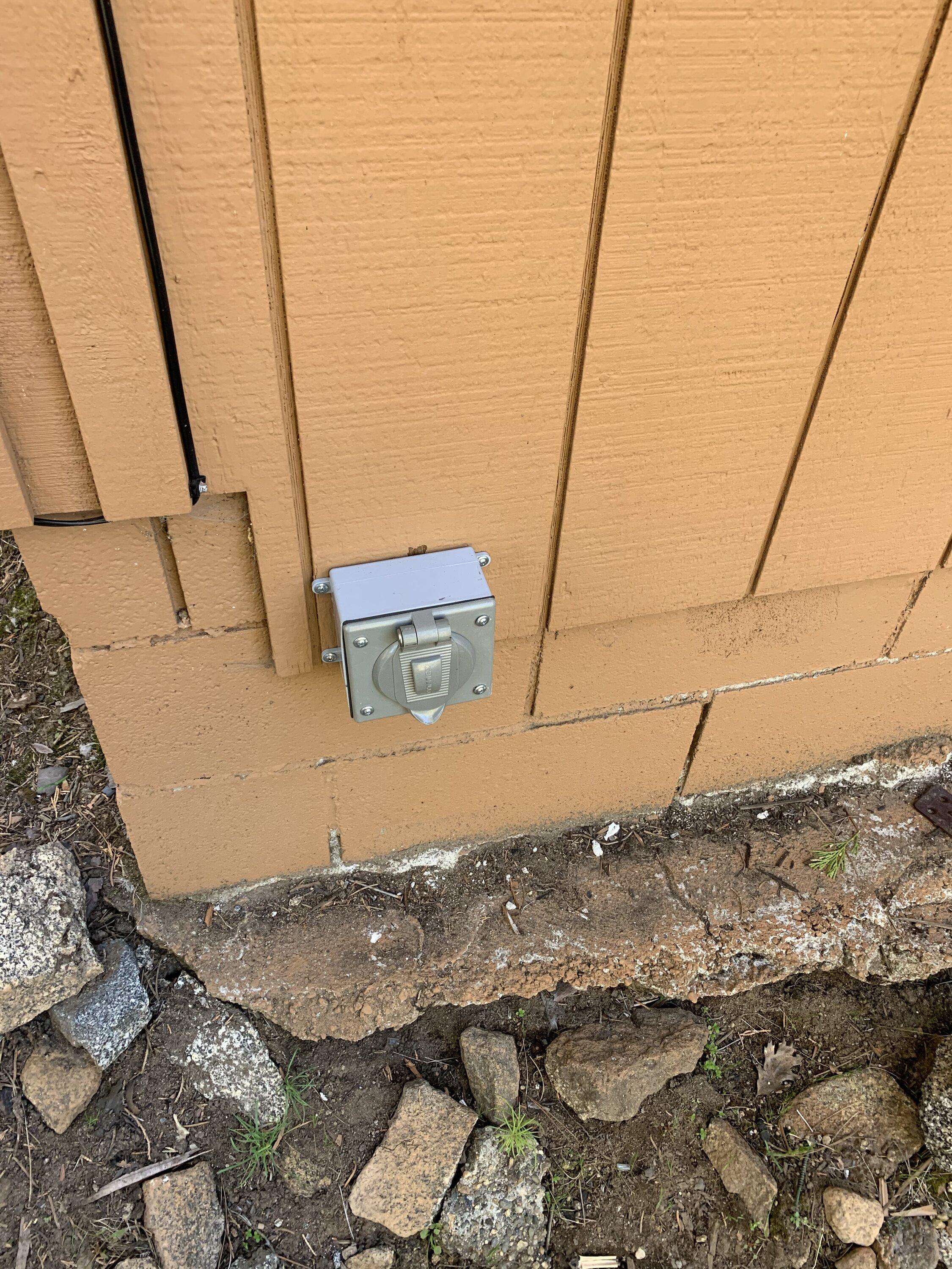

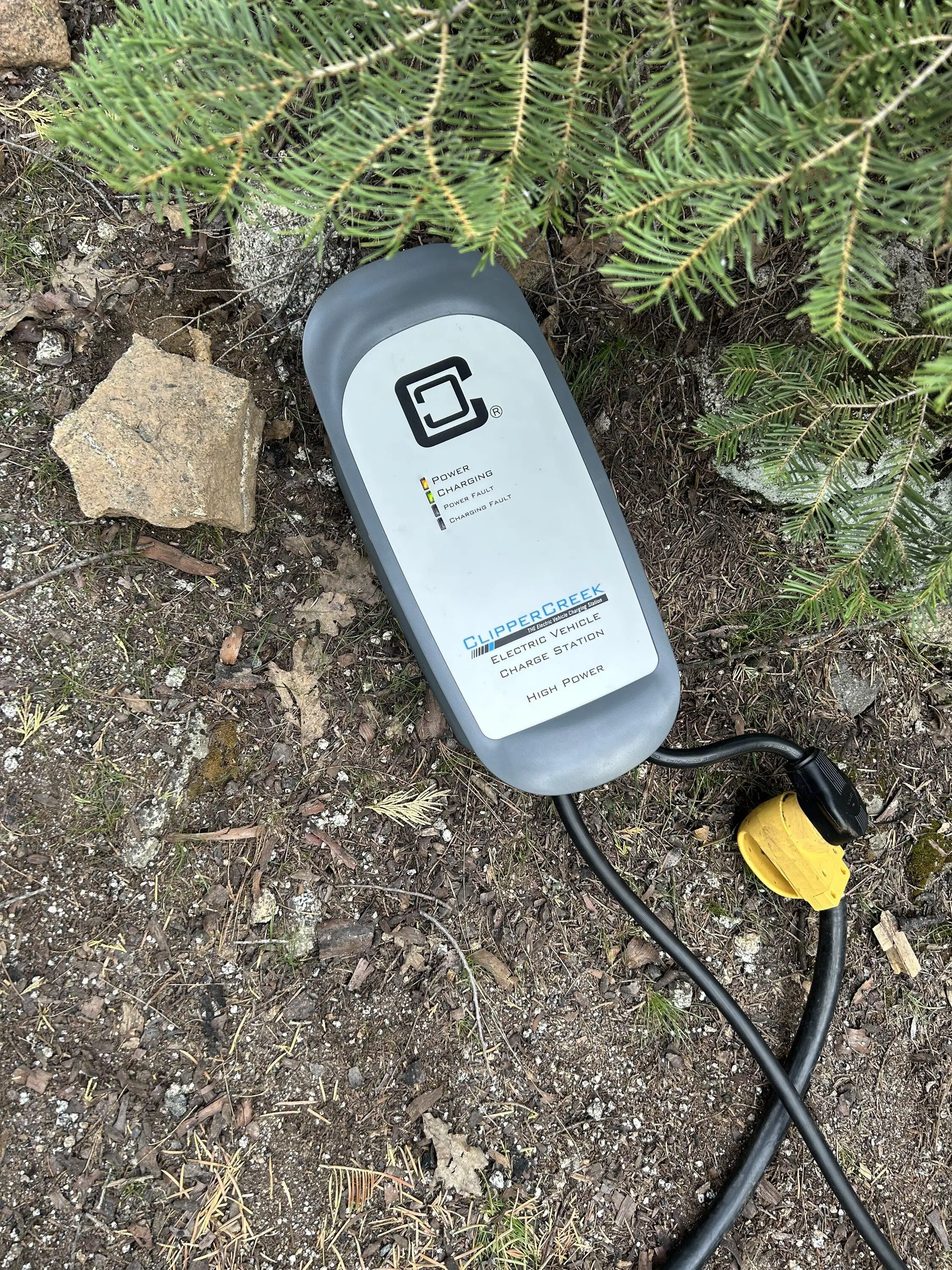

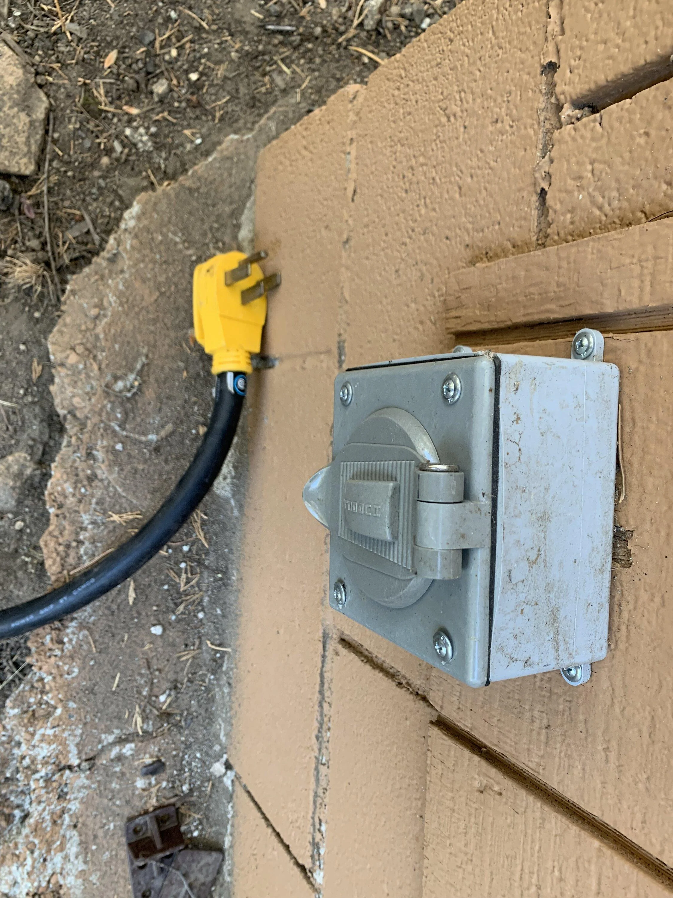

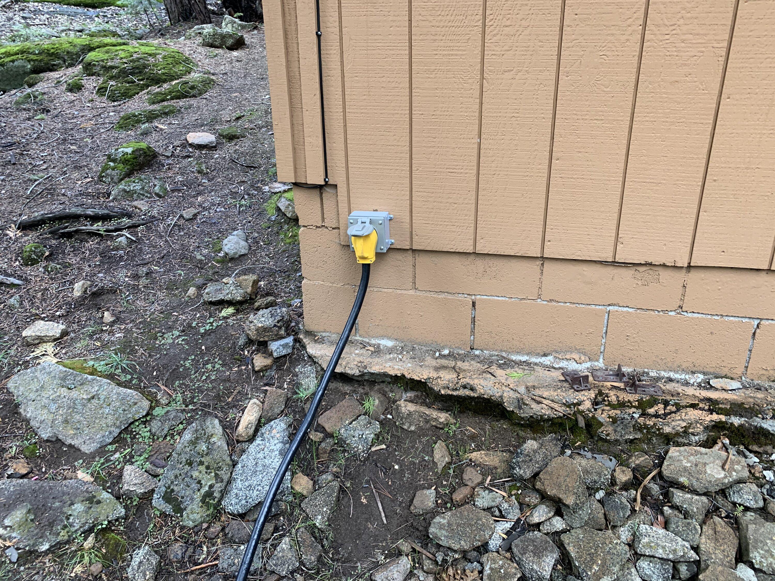

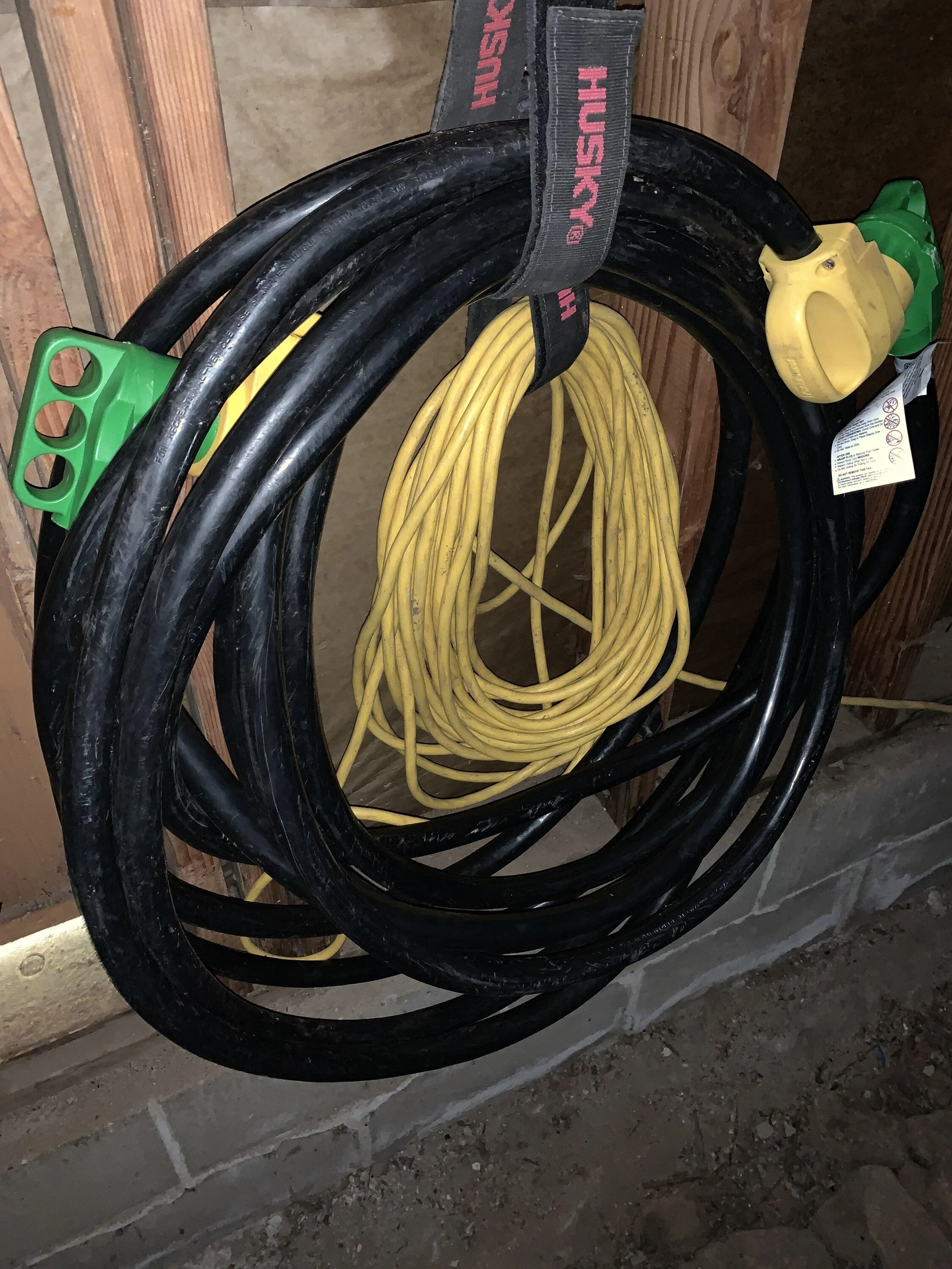

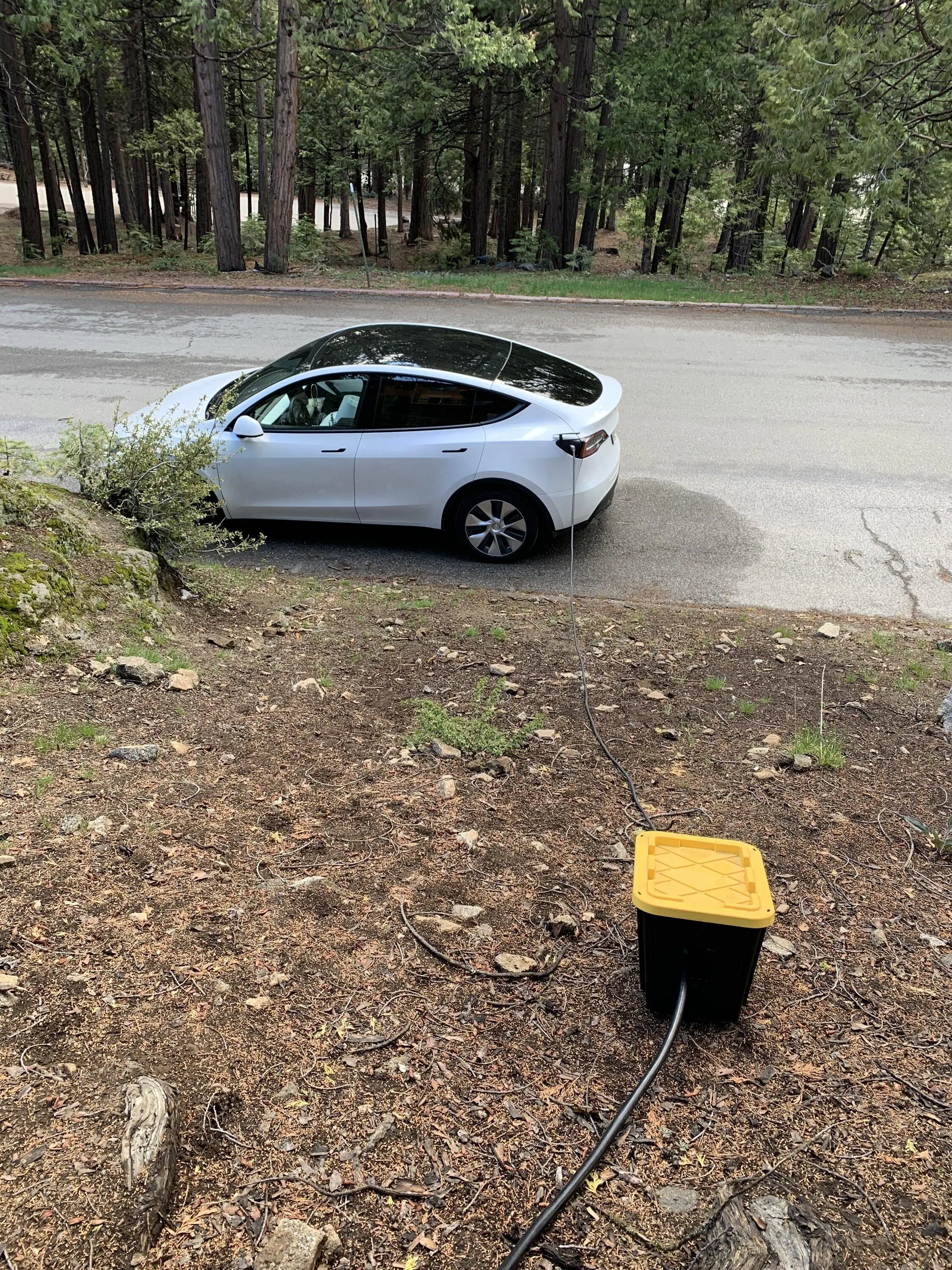

I had the exact same situation as you when we bought our mountain place. It’s a condo association and so I cannot trench but my HOA did approve my setup. I had an electricIan install a Hubbell 9450 Nema 14-50 outlet and an outdoor approved outlet. I then bought two heavy duty Rv 50 amp cables to make the run. I then bought a Costco plastic bin and cut fist size holes on each side to run the Rv cable in, connect a ClipperCreek Nema 14-50 EVSE inside to protect from the weather and then run the cord out the other side. the ”run” is about 95 feet. I’ve used it to charge my Model S, wife‘s model Y and now my Ford Lightning. I see no voltage drop and on the teslas I dial down the charge rate because I can. when we have had two EV’s here i also run a heavy duty 120V industrial extension cord and replaced the 15 amp outlet with a hospital grade unit to handle the constant load. We are up here a few days each month and the biggest issue is hauling the heavy cables out of the cellar. My wife doesn’t mess with the 240v if she comes up alone and just uses the 120V to trickle charge. We‘re also at 6000 feet so we only charge to 70% as we regen power heading down the mountain. Hope this is useful. I’d love a hardwired system like at our main house but that’s just not a possibility.

Love your ingenuity!
