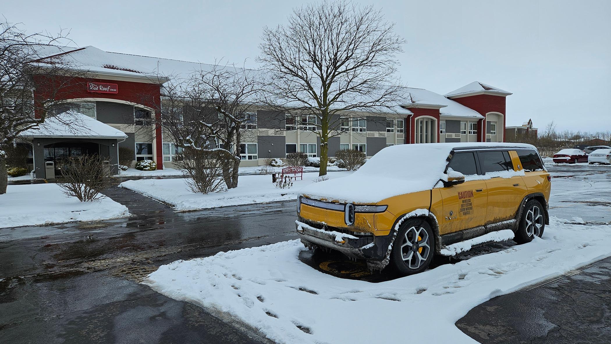

I guess Tarkus & I (and my two kitty cats) are a "EV Anomaly Drive Team" as I/we live & work on the road, driving nationwide from county to county testing the accuracy of wireless E911 calls. I typically pick a motel with a supercharger nearby for Tarkus as the "bullseye" & test the surrounding counties (one per day up to 1.5 hrs. of drive time to get to a county). Depending on the weather/time of the year, I usually charge up in the morning while I setup my test equipment in Tarkus (summer time & mid-late afternoon during the winter time). Sometimes my county is so far away I'll stop-off at a charger for short charge during lunch to make sure I can get back to my "home-base" motel/supercharger. I've run her down to less than 10% a few times & typically stop charging at 80%-95% depending on congestion at the charge station. Maybe once a month I come across a station that is packed & has a line formed & I just move on to the next station and when I'm done with the 10 or so surrounding counties, I pack up Tarkus & move to the next cluster of counties. Now that I can use Tesla Superchargers', Motel selections will be better... & nothing wrong with Red Roof as they are Pet Friendly... :cool:

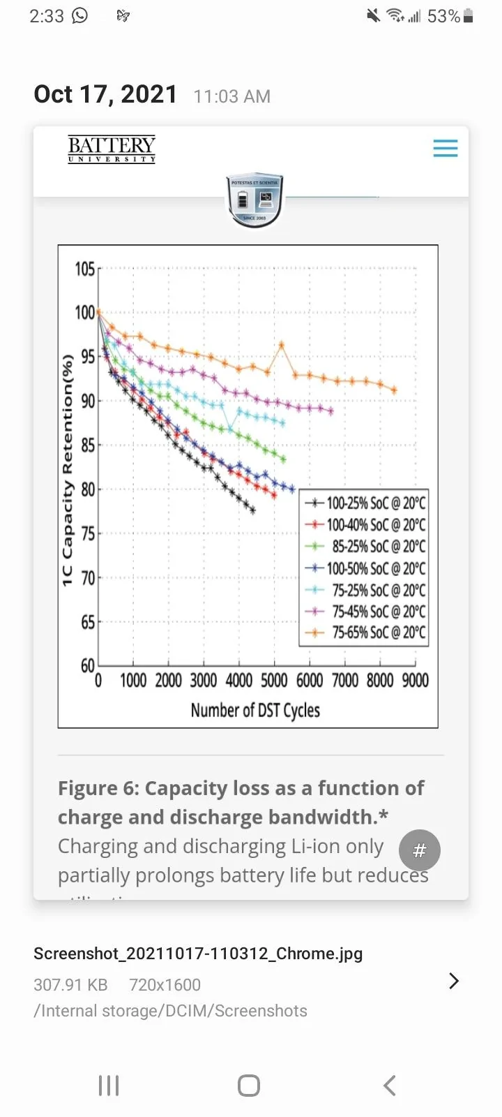

Your battery charging routine is ideal.
Rivian R1T R1S Charging Habits and Battery Health Screenshot_20240323_135954_Gallery
R1Sky Business
Mar 15, 2022
45
4,988
3,988
250K miles with less than 10% battery degradation here we come!!!!
