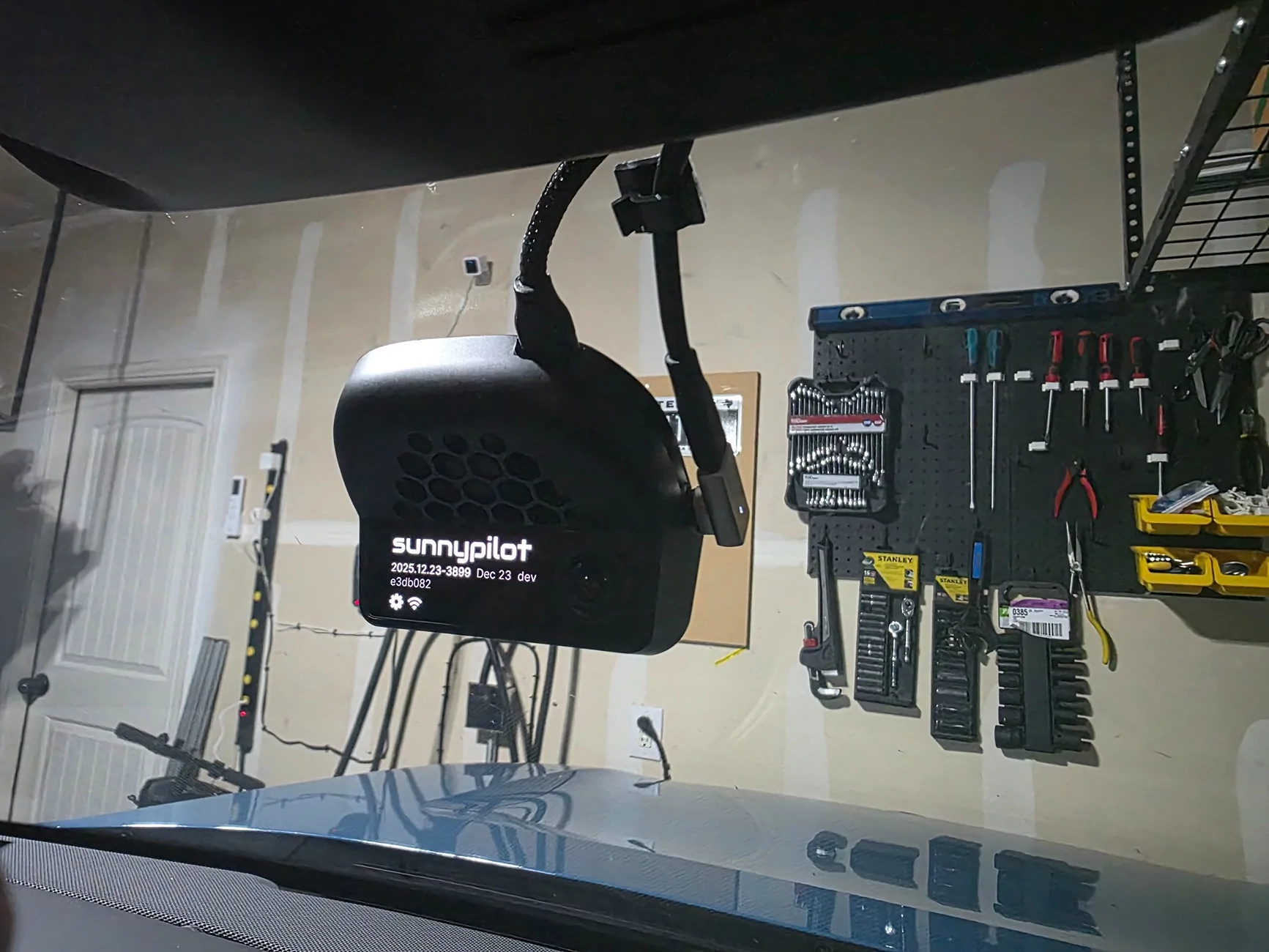

Gah, clean that up!
I'm gonna clean it up a bit (and mount it a bit higher), just waiting for my Janka mount to arrive. Is that a magnetic adapter on the secondary cable?
