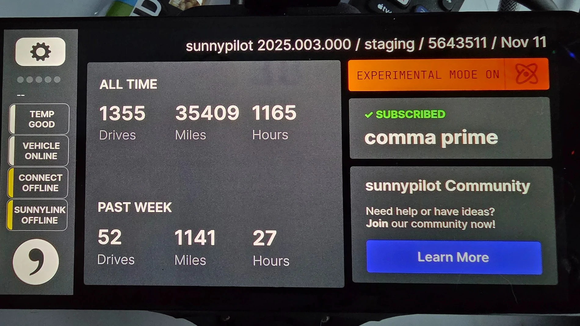

The build I've been using is sunnypilot staging with default settings. The Comma 3X is mounted immediately beneath the rear view mirror, centered with the rear view mirror.

I've been using the Sunnypilot build but am open to trying others. Any other recommendations?

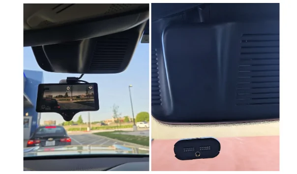

It should be mounted centered on the mirror "hump" on the mirror housing. That's actually the center of the windshield.

Try different driving models - not different builds. I mention it at the end of the video when going over how to change settings using Sunnylink Dashboard. You can select and install different driving models that have slightly different driving behaviors. You're probably currently using the default driving model.
Thanks, I didn't know of the distinction between build and model! I'll explore a bit more on that. Hopefully there's a model that counters right-bias lane centering.

Like @gerrylum said, models seem to be personal - they react differently for everyone based on circumstances, so one might like Down To Ride V6, another Space Labs 3 or GWMv9, or any one of the many options. So, don't feel like something is wrong if you try one someone suggests and it doesn't do well for you, just try another.

I've recalibrated multiple times. I've even done the questionably unsafe thing of slightly rotating the Comma 3X (it's on a windshield mount with a little slack in the joint) to bias the camera facing right in hopes of tricking it to bias steering more left, but after an initial correction towards center, it continues biasing to the right.
Do y'all have it mounted to the right of the rear view mirror (despite standard instructions to the contrary)? I was at one point tempted to try that, but I hate the idea of having to remove the sticky tape residue off the glass and reposition the wiring path yet again if it didn't solve the problem.
Of the multiple builds you mentioned, which would you recommend I try first? In that order?
Aloha XD, I too have had the dreaded too close to white line syndrome & my unauthorized fix is to tap/push the left or right side of the windshield mounted Comma 3X & the "nudge" usually shifts the vehicle a smidgen to the left or right as needed & away from the white line. Too hard a nudge on the 3X & it wants to recalibrate. Mine usually does not reset back to the edge of the road again. I'm on the SP / Staging / Nov 11, w/GWMV9 Model with a few miles of driving with the 3X 😎
