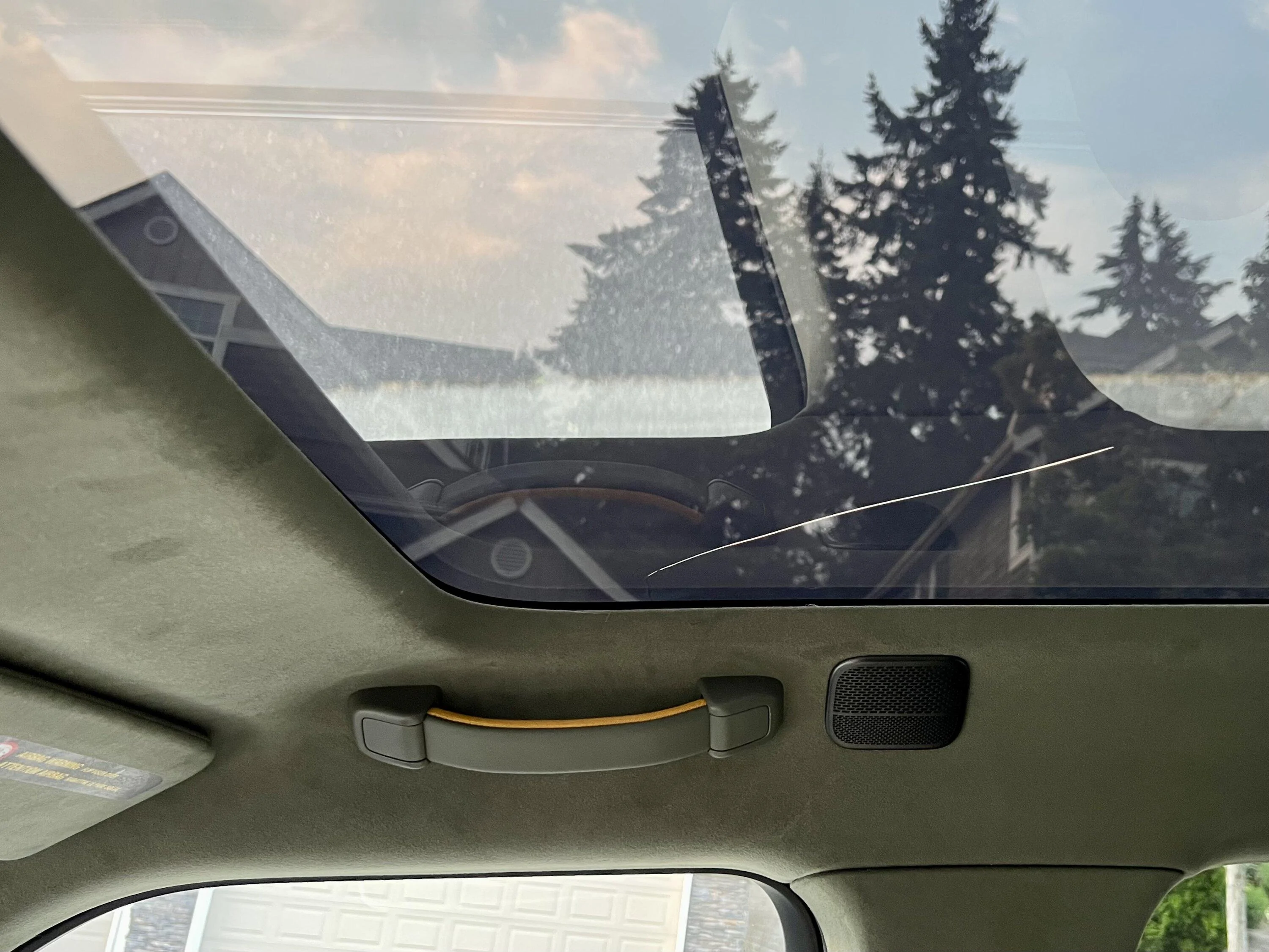

My roof cracked on its own. I didn’t touch it or put any weight on it.

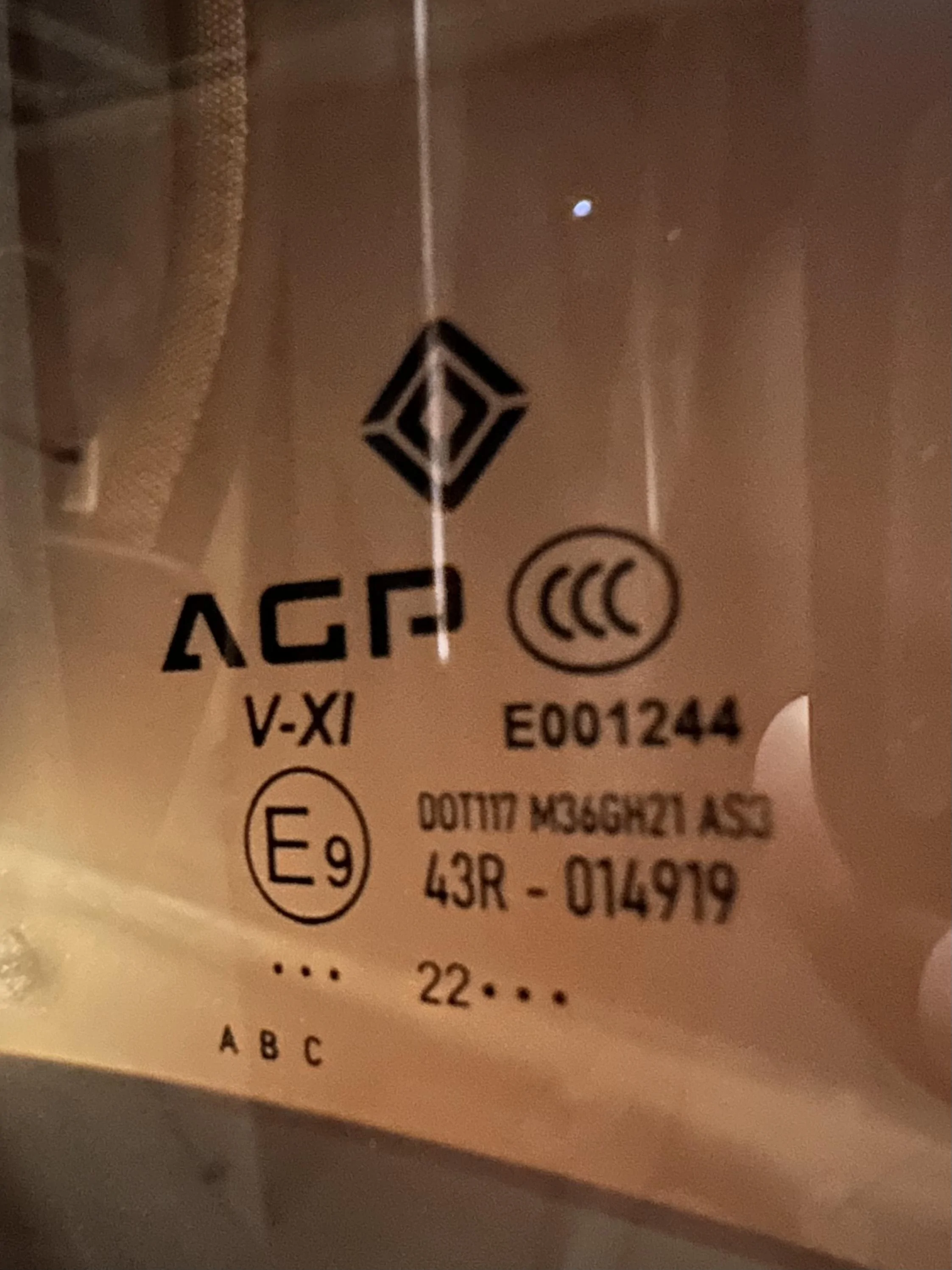

could you get a picture of the identification markings on the glass? Curious who the supplier is.
Looks like you breathed on it wrong. ;) Please let us know if Rivian takes care of it for you or gives you a hard time. There have been way too many reports of spontaneous roof cracks for Rivian to expect customers to pay for these replacements.
My theory is that it’s from slamming the door shut. The passenger side door is difficult to close, and maybe that put pressure on the roof glass.

…And then there were two (automotive glass companies that suck). :(
When two suppliers have the same issue I have to think the spec is weak rather than manufacturing defect.
Very possibly but it’s far easier to simply jump to conclusions. :)
