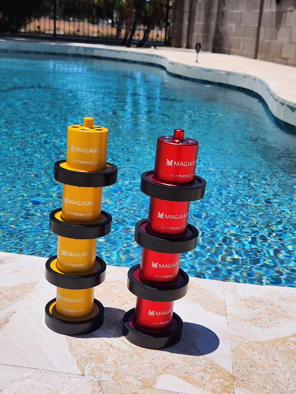

I wish the yellow ones were available on Amazon. All they had was red when I purchased a couple weeks ago.
The Rivian Yellow are unique for sure and are available on our website and while not Prime, we ship the same day and product arrives quickly. Thanks for the business!!

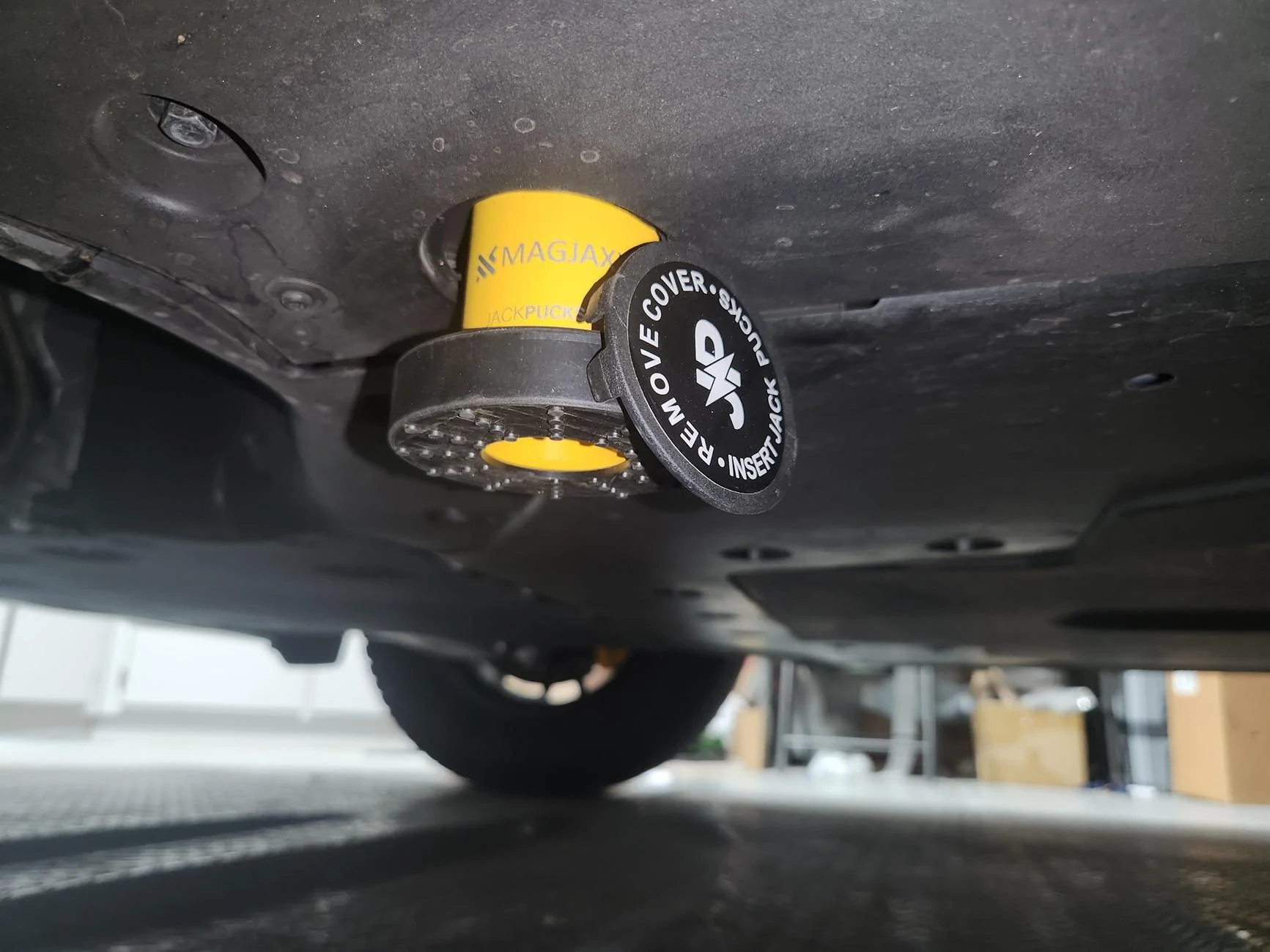

Here we go again!! Glad you were paying attention. I simply cannot comprehend this from DT?! This has happened countless times to people, hence why, I had to make our Jack Point Identifier Emblems for our vehicles. Silly.

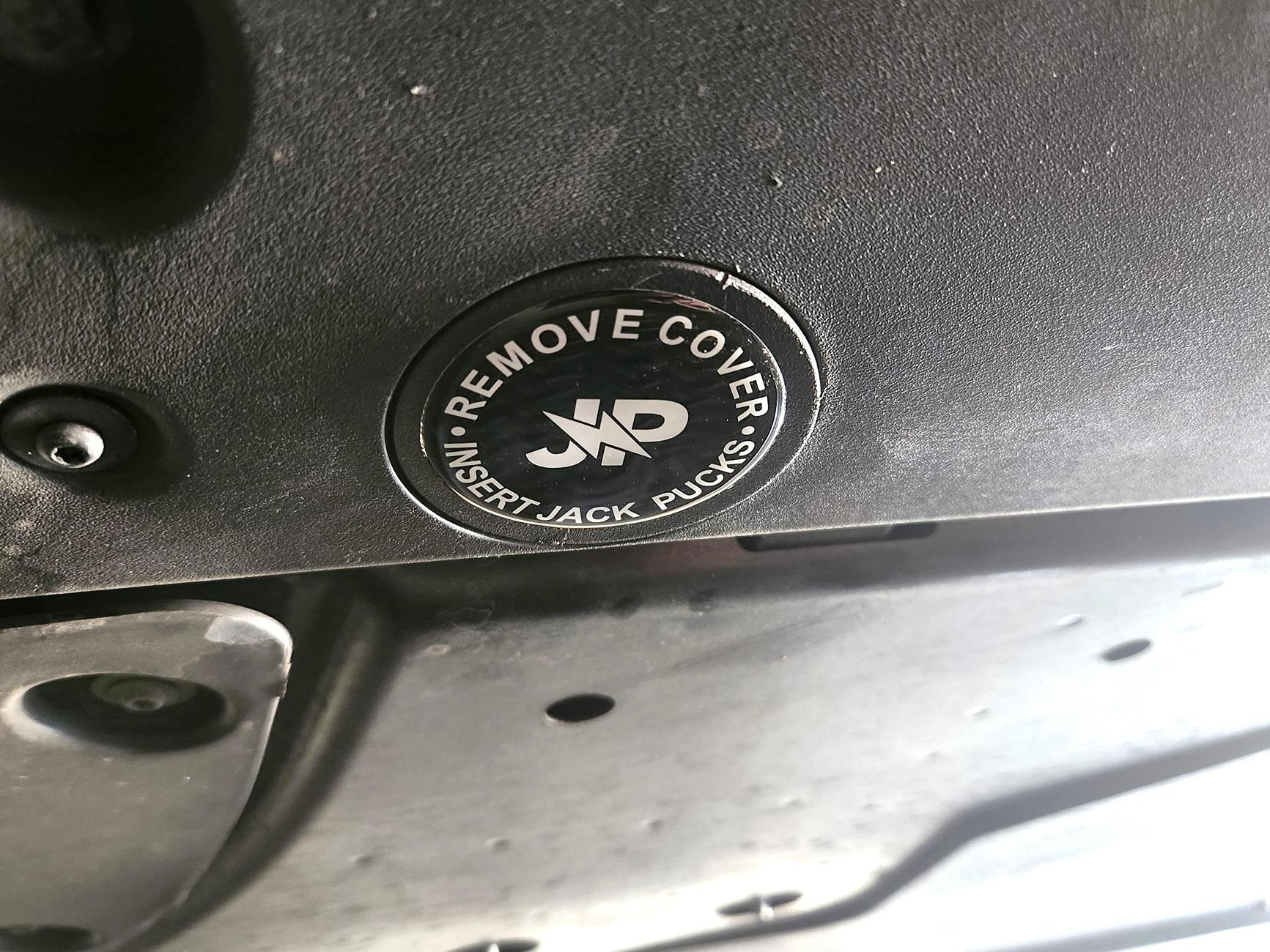

I already have the red ones, but now I kinda want to get the yellow ones so I can turn them into LEGO minifig heads…

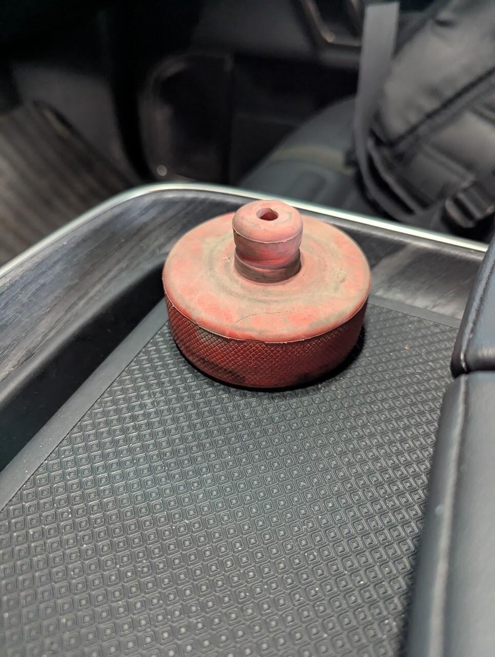

I'm not one to usually resurrect an old thread, but I found this in my garage, and the most recent lift done on my truck was at a Discount Tire in Spokane, WA:
Rivian R1T R1S Discount Tire failed to use jack pucks 1751461045683-cb
Wonder if they need that back...

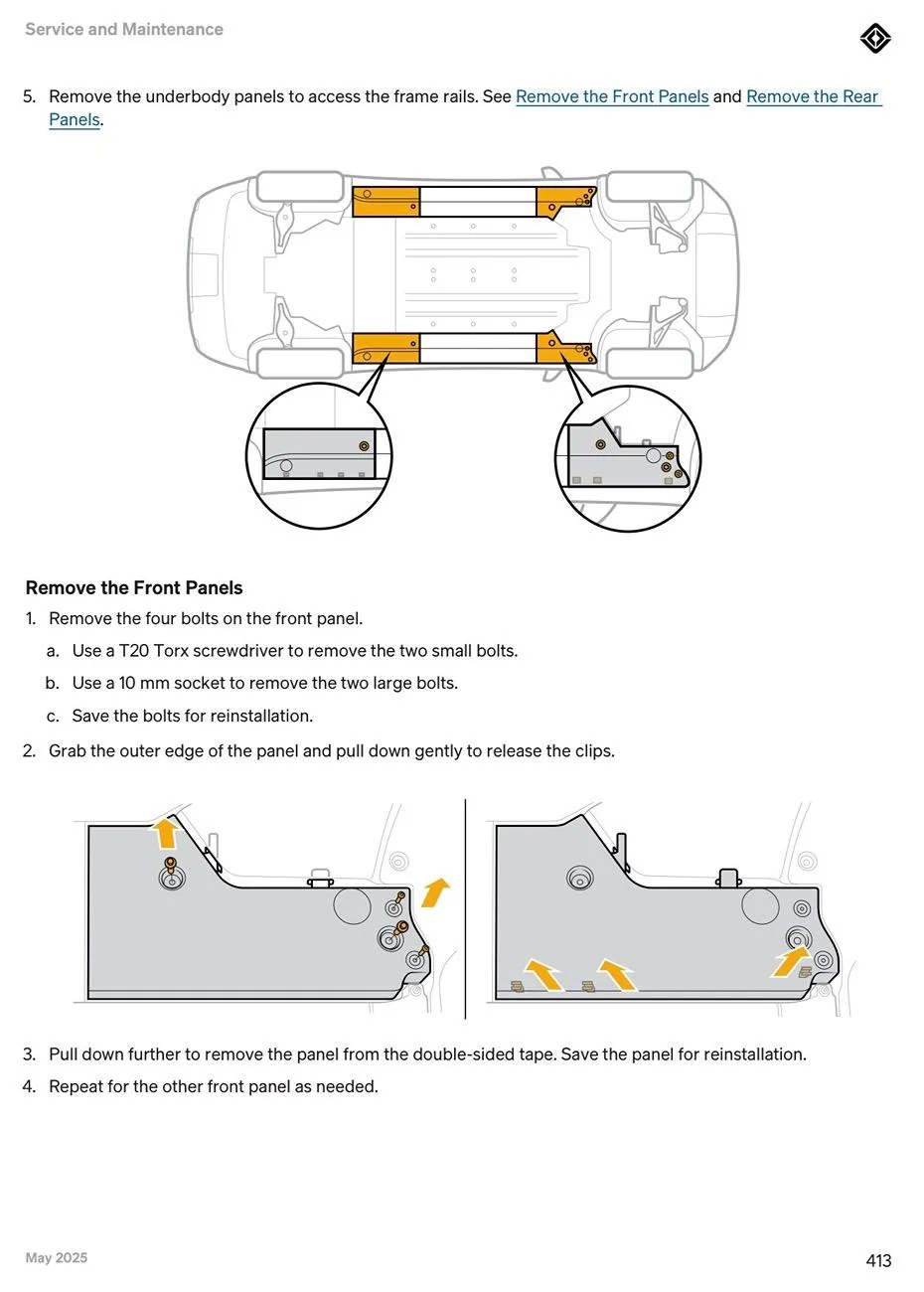

Might be best practice to just remove these yourself before going to any shop. So easy to do and great for peace of mind, plus it allows for use of a lift. Pucks shouldn’t be used for a four point lift. I’d like to say that it’s fool-proof, but some dope always finds a way.

I must admit I chuckled......this is still going on in mid-2025.
