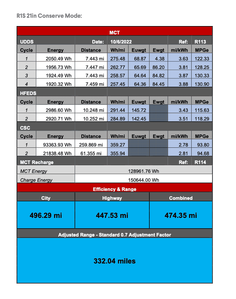

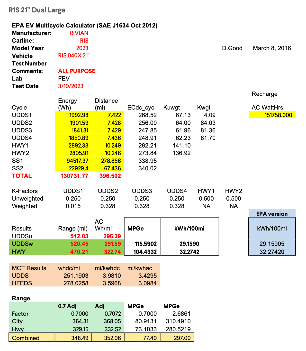

Can you clarify something about your statement above? Pages 28 and 30 of the document you referenced refers to the R1T on 21's. The document linked in the first post here only seems to include R1S test results.
From that I can gather, it looks like:
R1S Quad Large 21" Conserve = 332.04 mile adjusted range
Rivian R1T R1S Dual Motor EPA Certification Application (Reveals HP, Efficiency, Range, MPGe Figures) 1686025132818
R1S Dual Large 21" All Purpose = 352.06 miles adjusted range
Rivian R1T R1S Dual Motor EPA Certification Application (Reveals HP, Efficiency, Range, MPGe Figures) 1686025165423

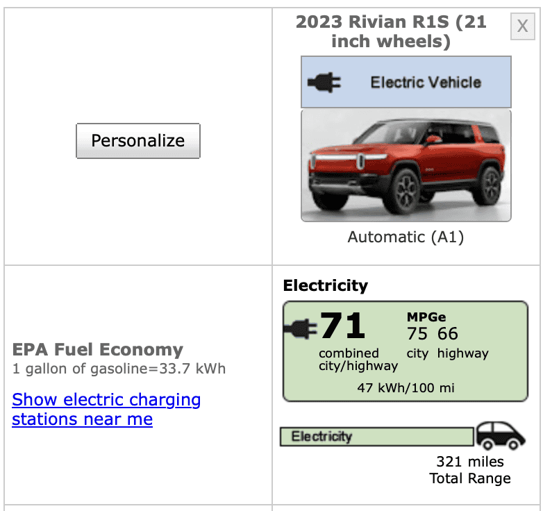

The official EPA rated range on an R1S Quad large is 321 miles, since I don't think a Quad Motor is meant to be driven in conserve all that time.
Rivian R1T R1S Dual Motor EPA Certification Application (Reveals HP, Efficiency, Range, MPGe Figures) 1686025570687
So, if I'm reading this right, the R1S Dual Motor is adding about 20-30 miles of range, or 9% when comparing official EPA ratings.
BTW - I'm not entirely sure how the adjustment works, but I know 0.7 is standard and Rivian's adjustment doesn't seem all that different.
