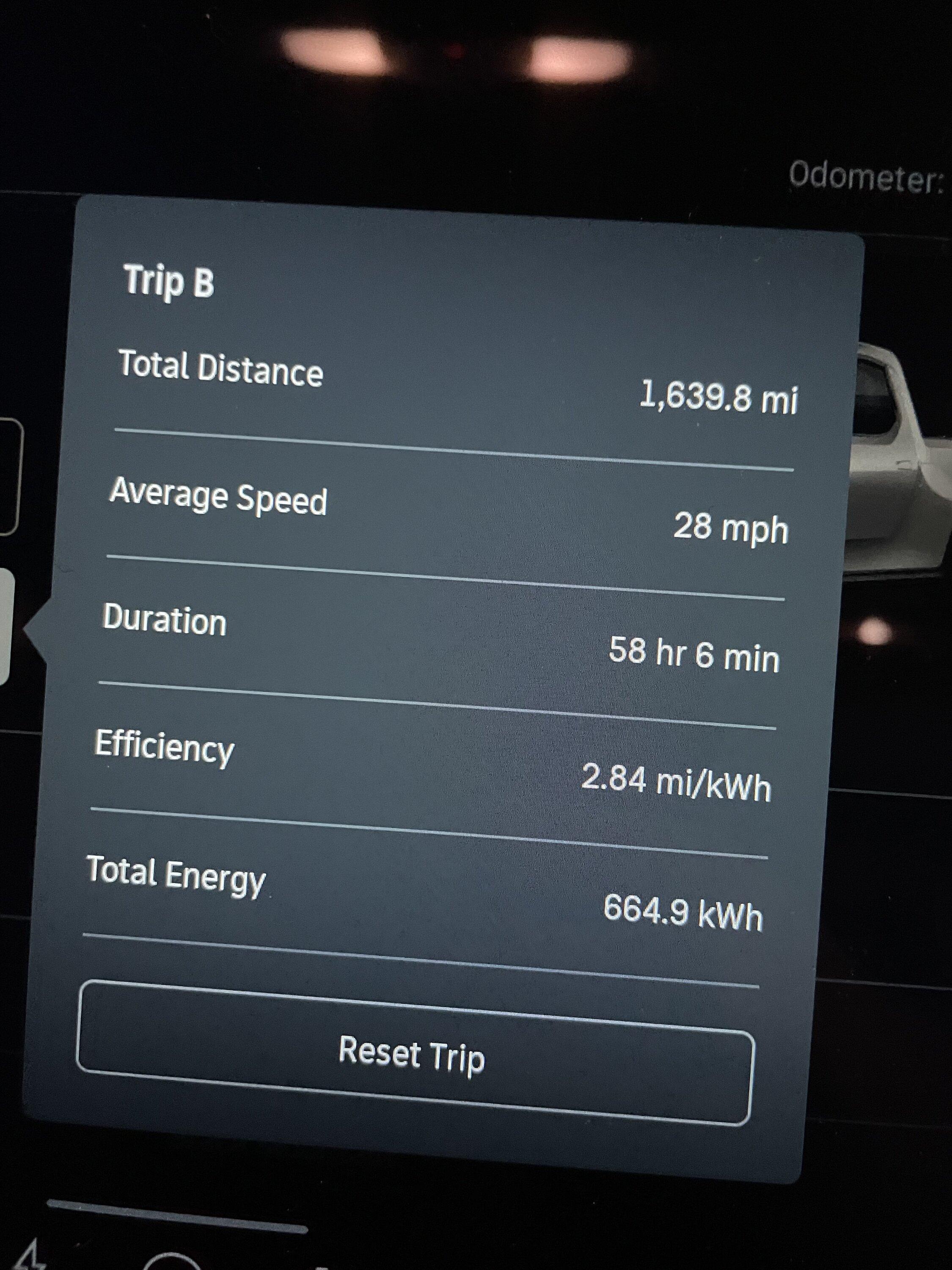

Here is a data point for a dual motor on 21s. Obv it will be a bit lower at high speeds but so far the real world high speed penalty has not been too bad.
Rivian R1T R1S Dual motor real life efficiency? IMG_6284
Zorg
Nov 1, 2022
1,020
1,242
SF bay area
22 R1T 25 R1S
Sweet. Go back and drive 100 miles at 75. :)
