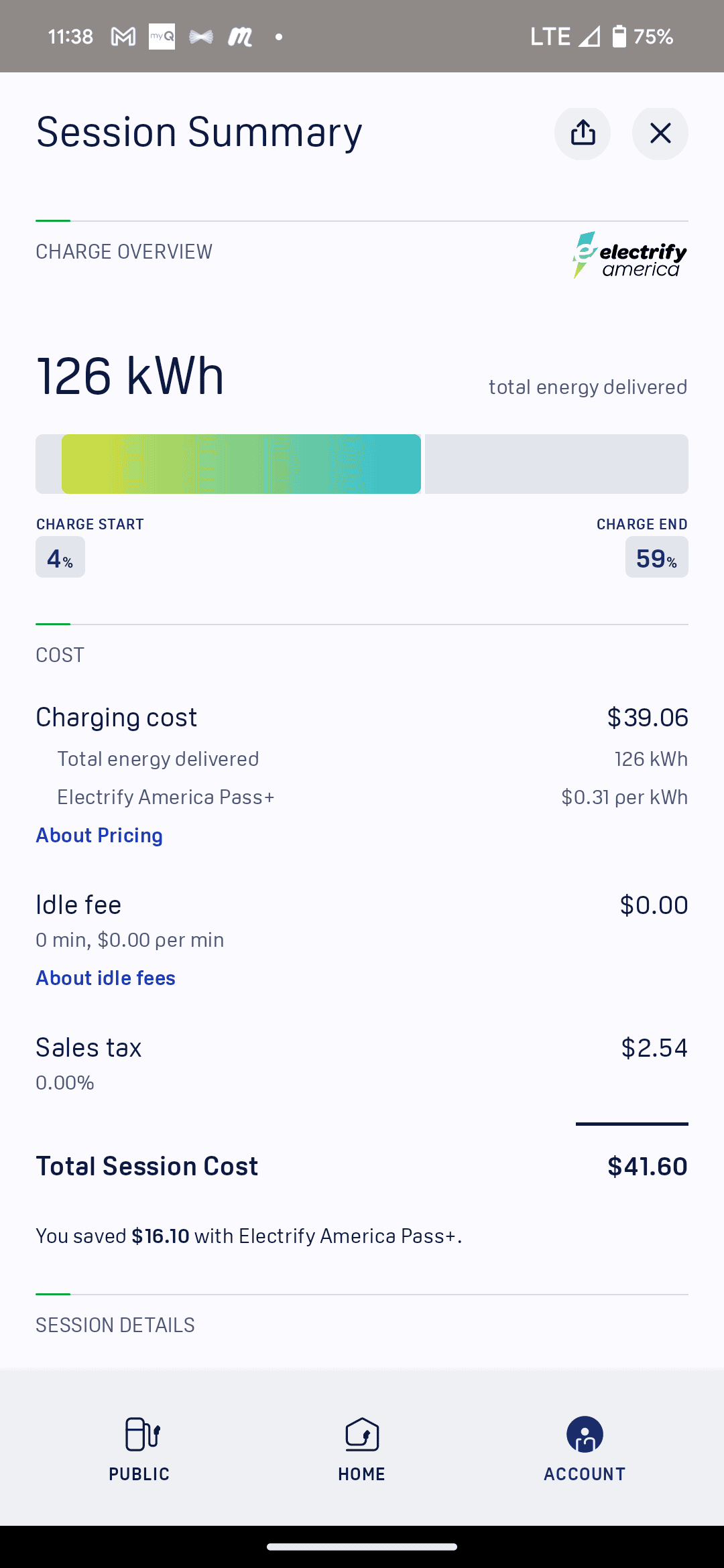

Absolutely the battery in the Hummer EV I owned at the time could take that, and did.
I knew it had to be the Hummer to take that much power that quickly. It is running the 800V (parallel 400V pack) system and can take full advantage of the 350 kw system on EA. Very cool.
And 129kwh got you, what, like 150 miles? (jk)

They don't know what vehicle you drive before you plug in. $50 hold isn't enough in some cases.
Disaster!
You mush have one of the 100 or so Hummers around. If you paid to go from 4% to 59% and received 55% soc and it took 126 kWh than your battery must be around 229 kWh. And you got the old pricing of $0.31 on top of that.
