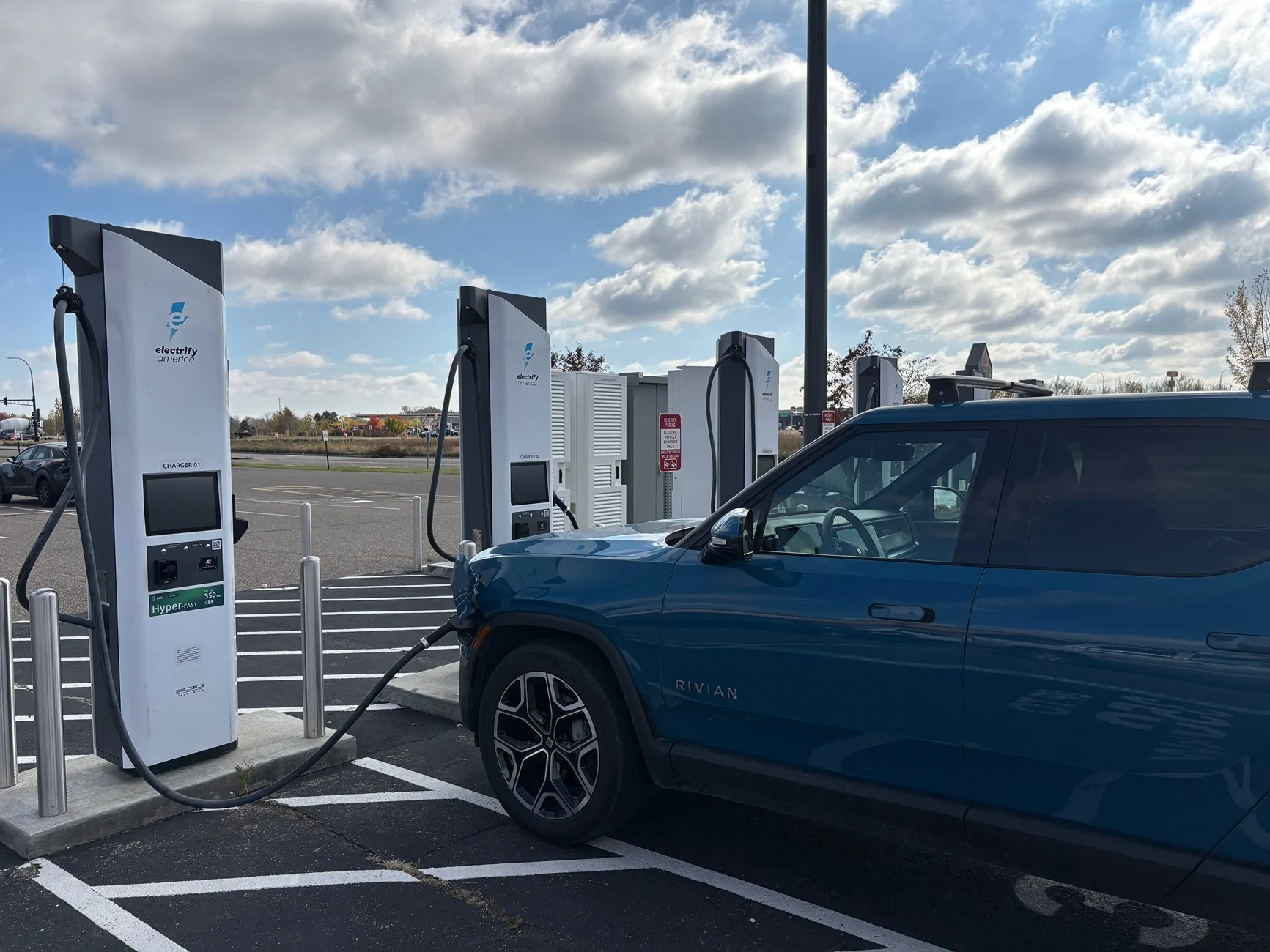

Ok. I am now currently charging at the EA station in Albertville, MN.
I first tried using the EA app to initiate a charge and get my membership rate. It worked. I opened the app, selected station 1, swiped to start, then plugged in. I got the membership rate of $0.48 per kWh
after onboarding 10 kWh I disconnected and moved down to station 5. I just plugged in and it initiated charging right away. I was charged the nonmember rate of $0.64 per kWh. After I stopped charging i immediately got an email from Rivian with my charging summary confirming the nonmember rate.
This location has the newest gen 4 chargers. Initiating in the app first works, at least for this generation of equipment.

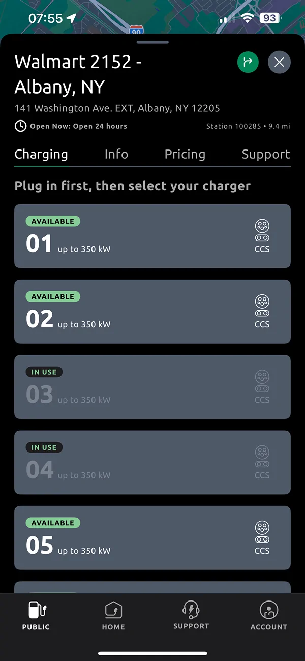

Before Plug & Charge update, you’re right, initiating in app like Tesla or EA is necessary. Now you don’t. Just plug it in and walk away. I tested couple times successfully at both V3 and V4 Tesla superchargers but not at EA yet. When I do, I’ll report here.
Today I drove my R1S gen2 to Electrify America charge station to test two scenarios: 1. Plug & Charge without touching any thing. 2. Using EA app in iPhone to initiate charging before plugging in so i can use membership discount. I’m happy to report here that both methods went without a hitch. First bill was charged through Rivian app account (without discount) and second through EA app built in wallet (with discount).

When you at charger, just select stall and swipe to charge. Then get out of car and plug in. It worked for me and I tested yesterday.
