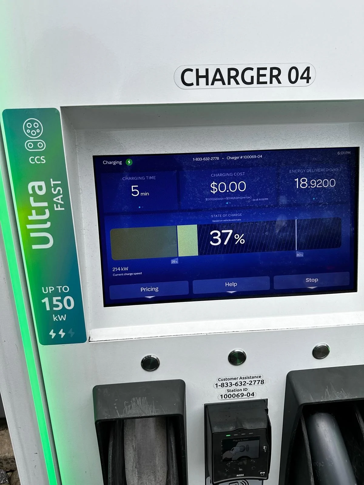

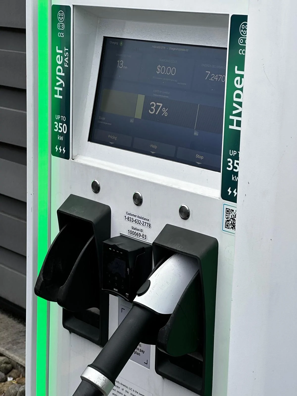

agreed on the other day my R1S clocked 200kw on 150kw EA and the BMW guy next to me on 350kw got very less charging rate not sure what’s going behind the scenes internally. Here are some pics I have taken for reference.
It was already explained what’s going on. Those 350kw charger cables get too hot and limit charging. Usually only happens on the old units with the two cables. New ones seem to be better.
