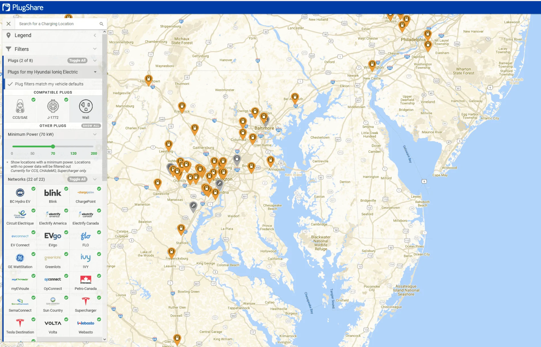

I was very surprised to see the lack of DCFC 70kw+ plugs (CCS) along the eastern shore. Heading to the beach there in a week and will have to slum it with 50kw charging which in practice has historically been not that fast maybe 40kw. My Ioniq charging curve is pretty great and hits about 64kw until 80%.
Rivian R1T R1S EV charging in the US is broken: Verge article 1623078002196

Yes, the Delmarva is a little thin. Not that many (7) SC over there either.
