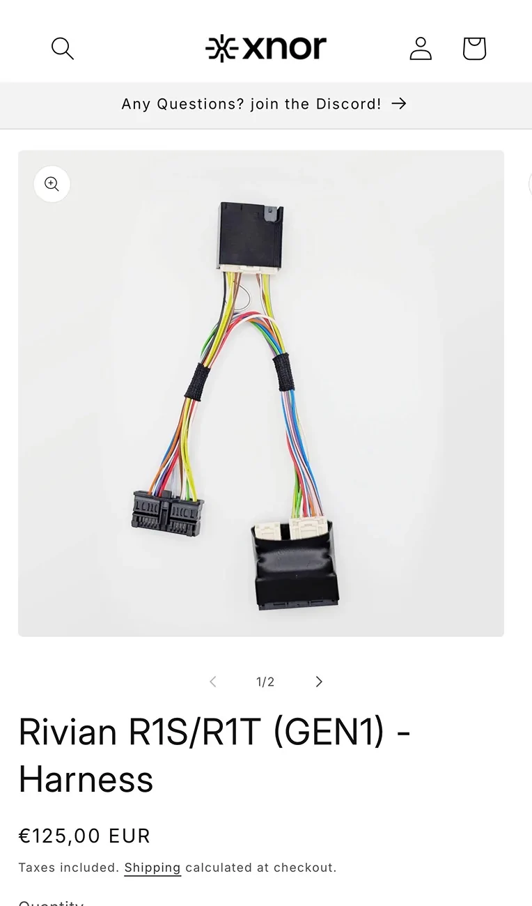

Right, so if I wasn’t worried about longitudinal control, the only benefit to Lukas harness would be that it’s easier to upgrade in the future? This is the harness I’m talking about.
Basically, but it also has the optional fuse tap for power, bypassing the AXM 12v supply.
And the Xnor harness is more expensive than the Comma harness (which is sometimes free).

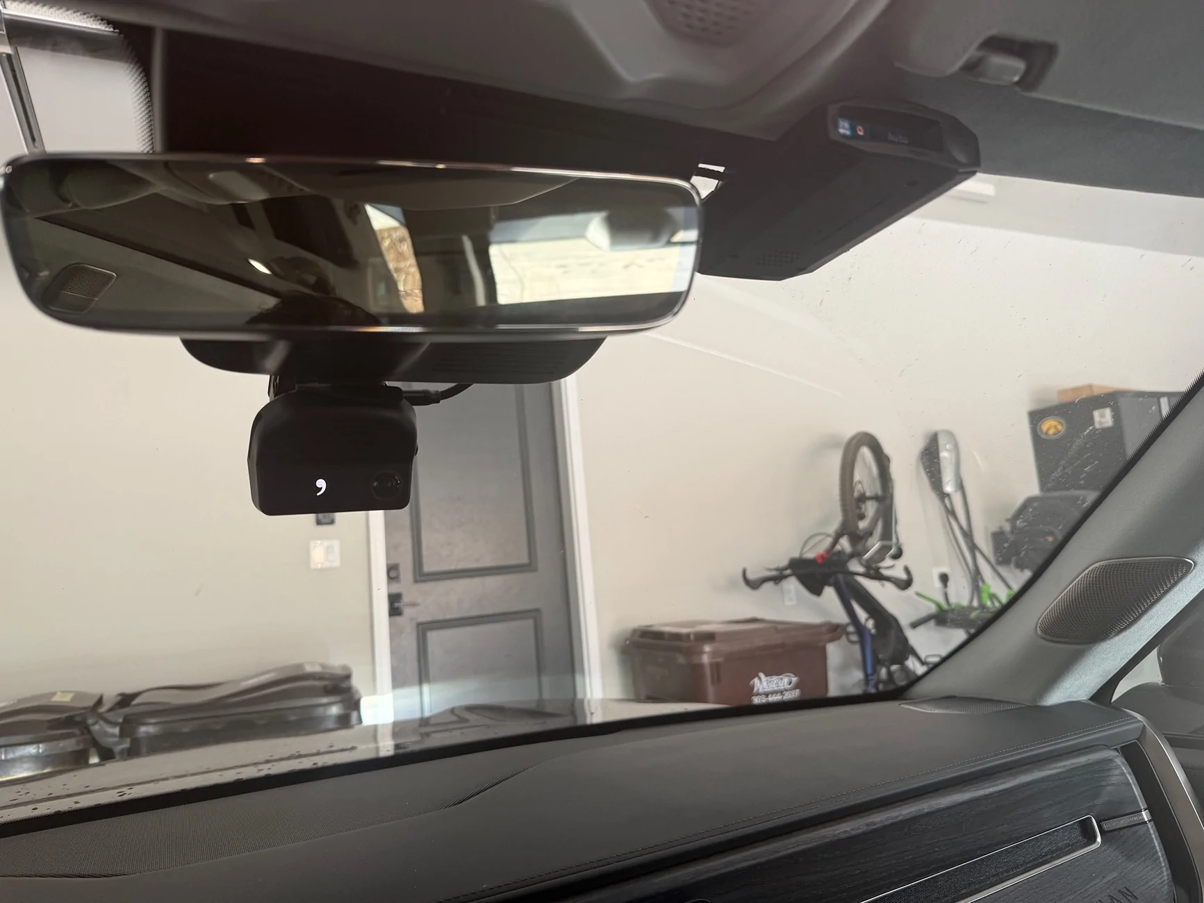

I’m just curious if any of you have ever used a Comma 4 with a mirror-tapped radar detector. It seems like they could go side-by-side under the mirror, but I don’t really have a sense of how much space that would take up.
If anyone has that set up and could snap a picture or two, that would be super swell & appreciated.
I have that setup but put my RD as high as possible to the right (passenger side) of the Mobileye cover. I then put the comma 4 as tight as possible to the bottom of the cover (using a Janska slide mount). Not near my car right now but can take a picture later if you want.
This sounds exactly like the set up I would be seeking. If you could post a picture or two, that would be great. Thank you!
