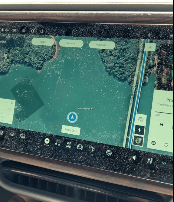

At one point, I was a beta tester for the new "Submarine" mode:
Did the telematics module fix the issue? I have the same thing going on in my R1S.
