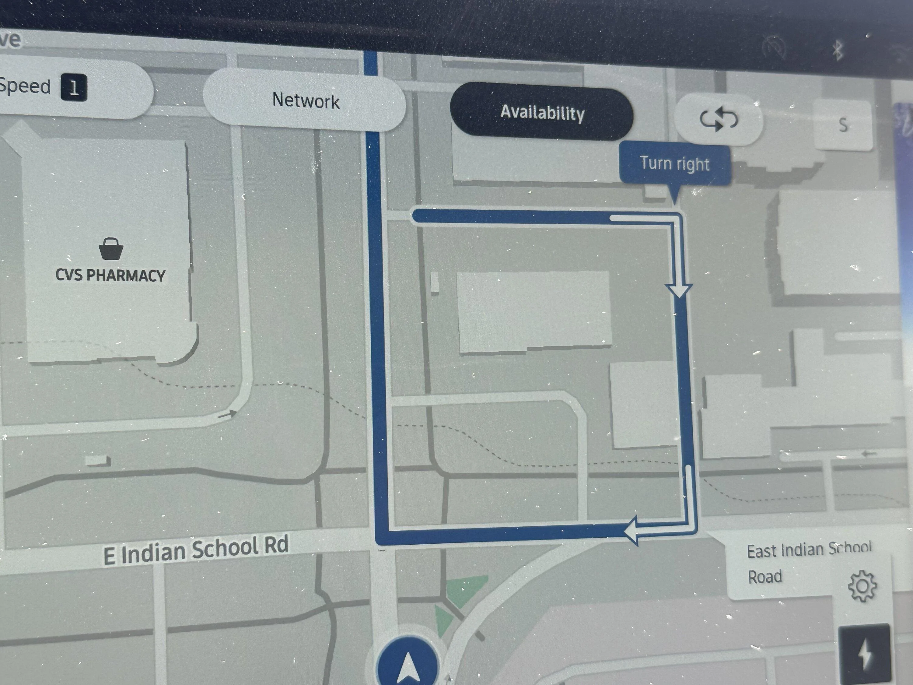

I posted this is in another thread but here is an egregious re-route caused by the GPS bounce/forward lurch or whatever you want to call it:
Rivian R1T R1S GPS position "jumping" around... 1694062908893
This was in a large, busy urban area amidst city traffic. This is a 5 lane major street. The middle lane is a turn lane most of the day, but in the mornings it’s one way south and in the afternoons it’s one way north. I remember being in the left lane, slowed due to traffic, and then was starting to accelerate for the green light. Nav is suddenly telling me to turn right for no reason. This is confusing. A driver not familiar with the area relying on Nav might try to change lanes in traffic to make that right not wanting to get lost in an unfamiliar city.
Nav and inaccurate GPS should not make things confusing for a driver.
You don’t have to agree it’s dangerous. That’s fine. Like I said, glad you don’t have the problem. Others with this bug may disagree. We can disagree cantankerous-free. ???

Maybe it's just me, but (assuming the arrow at the bottom is the actual position and direction of the car) it's obvious to me, at least, that you just want to continue traveling straight ahead. I mean it's strange and ought to be reported to Rivian but I personally don't think it's that confusing.
If the car's position doesn't match what shown on the Nav screen, well that's a different kettle of fish!
