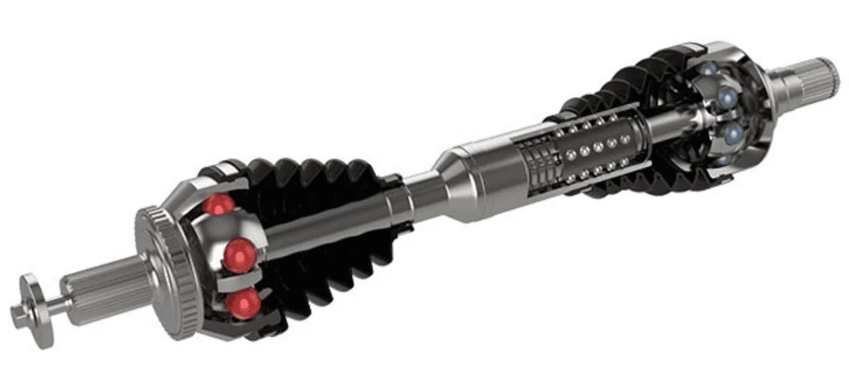

Rivian will hopefully not take any half-measures, and will replace these half shafts with full shafts.
They are called half shafts because they replace the traditional full width axle. Half on one side, half on the other side - "Half Shaft". It's not feasible to replace it with a full shaft axle for a ton of reasons.
What's different on a Rivian from the tens of millions of other vehicles with half shafts? Due to the suspension travel, the half shaft needs to change length, which does not need to happen on many cars out there. Rivian uses a "Ball Spline" half shaft which allows it to change length as the suspension height is adjusted. Think of it like a telescoping shaft on a collapsible umbrella, but obviously much stronger and complex. Other vehicles do use this tech from the factory, such as Volvo XC, but it's not all that common. It's offered as an off-road performance upgrade for many ICE pickups, used in race cars, etc.
In this picture, the shaft telescopes on the right center where you see the rows of ball bearings.
