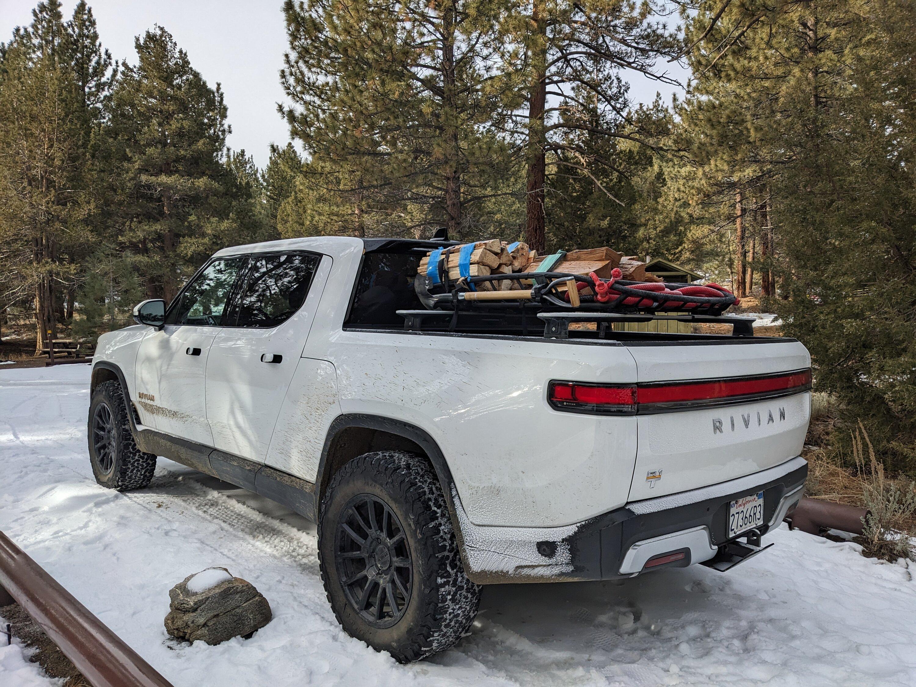

I've used this Sheridan hitch skid for probably 5 years of offroading with my ZR2 before the Rivian came along, and its transferred over nicely. I like that the wider plate helps protect the chain rings and electrical plug, but it looks like some other cool options have hit the market since then:
- Sheridan Hitch skids – WarFabInc (warfabarmor.com) Good bevelling on the eye, suitable for both hard and soft shackles. Can confirm it will survive years of abuse and many many hard pulls.
- Torq Hitch Skid Plate — 4Runner Lifestyle I really like this one too, but I'd definitely want to round the eye before using this with soft shackles.
- Hitch Slider - 41.22 Inc. (41twentytwo.com) I'm a fan of the minimalist look but from my experience (and scratches on my sheridan) you may end up with some bent chain tabs.
- Universal Hitch Skid | DRT Fabrication (drt-fabrication.com) looks fancy
Here's a pic of the sheridan on the truck: (ASR 7/8" x 30' recovery rope for reference, 7/8" Ultimate Kinetic Recovery Rope (28,300 lb MTS, 9,000 lb WLL) - ASR Offroad )

Thanks for sharing. I noticed the Sheridan comes in two sizes, standard and short. Is the one on your truck standard? If so, do you think the short one would fit or would the ring hit the license plate?
