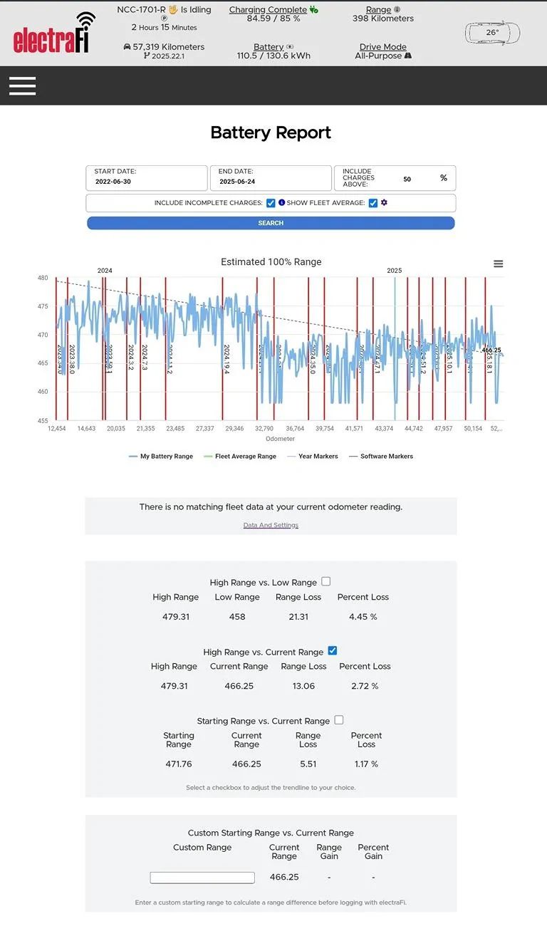

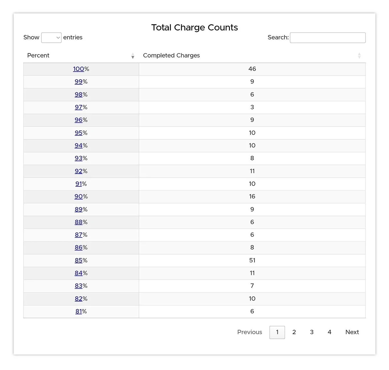

Kevin
MountainBikeDude
Jun 20, 2019
56
3,389
7,241
Vancouver
First 6 months or so, I was a full charge kinda guy. First EV, and love to drive, so always wanted full range.
As time went by toned that down to 85% normally, unless going somewhere on a weekend, then 100% twice a month.
Now, I typically maintain charge between 45-70% saves me time, there's also a DCFC station close that charges by the minute instead of kWh, so minimizing cost, and time spent charging while also preserving the pack within that 25% discharge window.
If I road trip, I still use the full capacity of the battery, it's there to use.
Worst case according to Electrifi is I've lost just over 4% overall capacity in 2.5 years, and 58,000kms. Pretty happy with that overall.
Edit * just to add, I primarily DCFC 9/10 charges.
