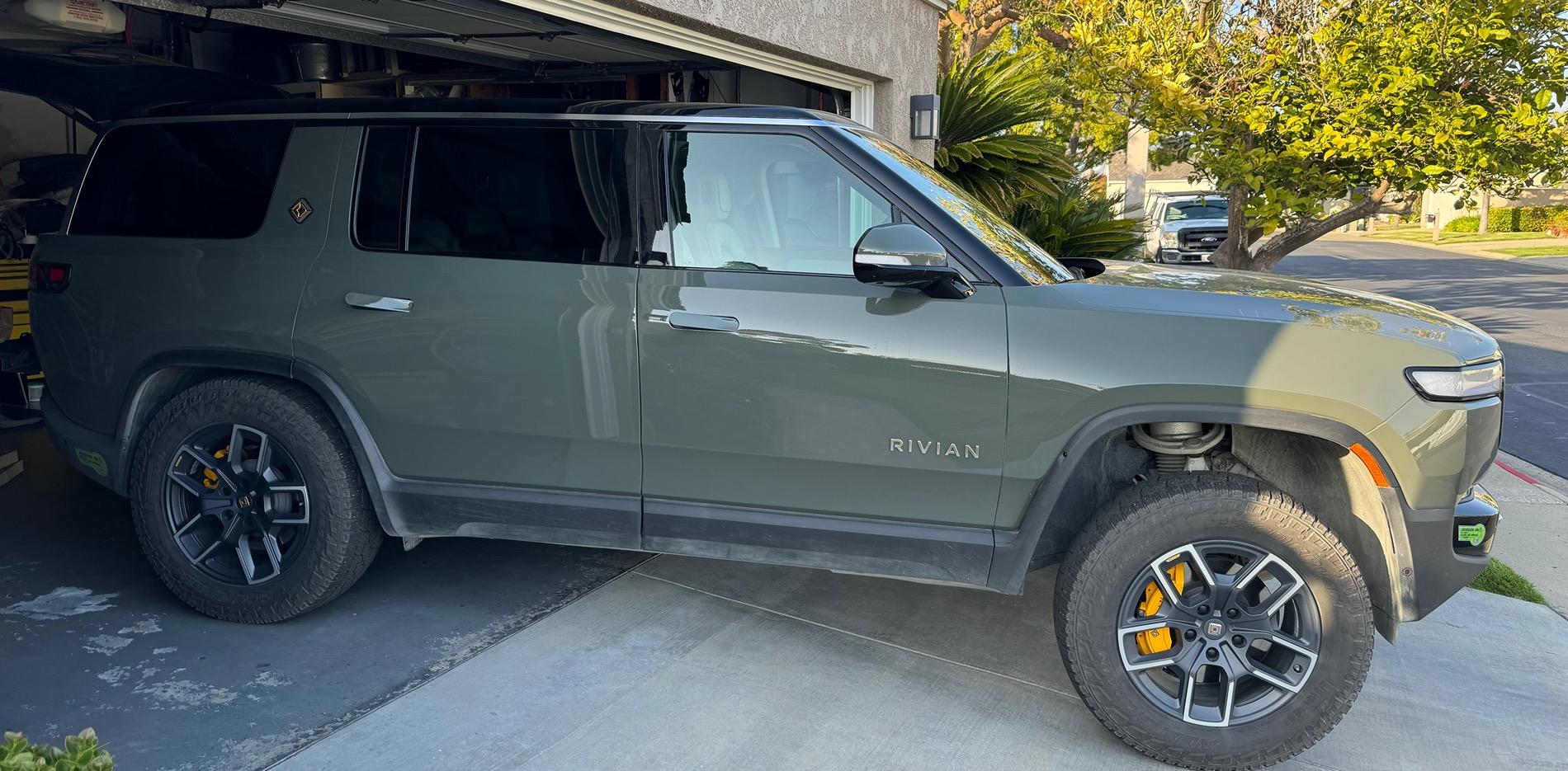

No, but camp level sure comes in handy when loading stuff in our sloped driveway!
