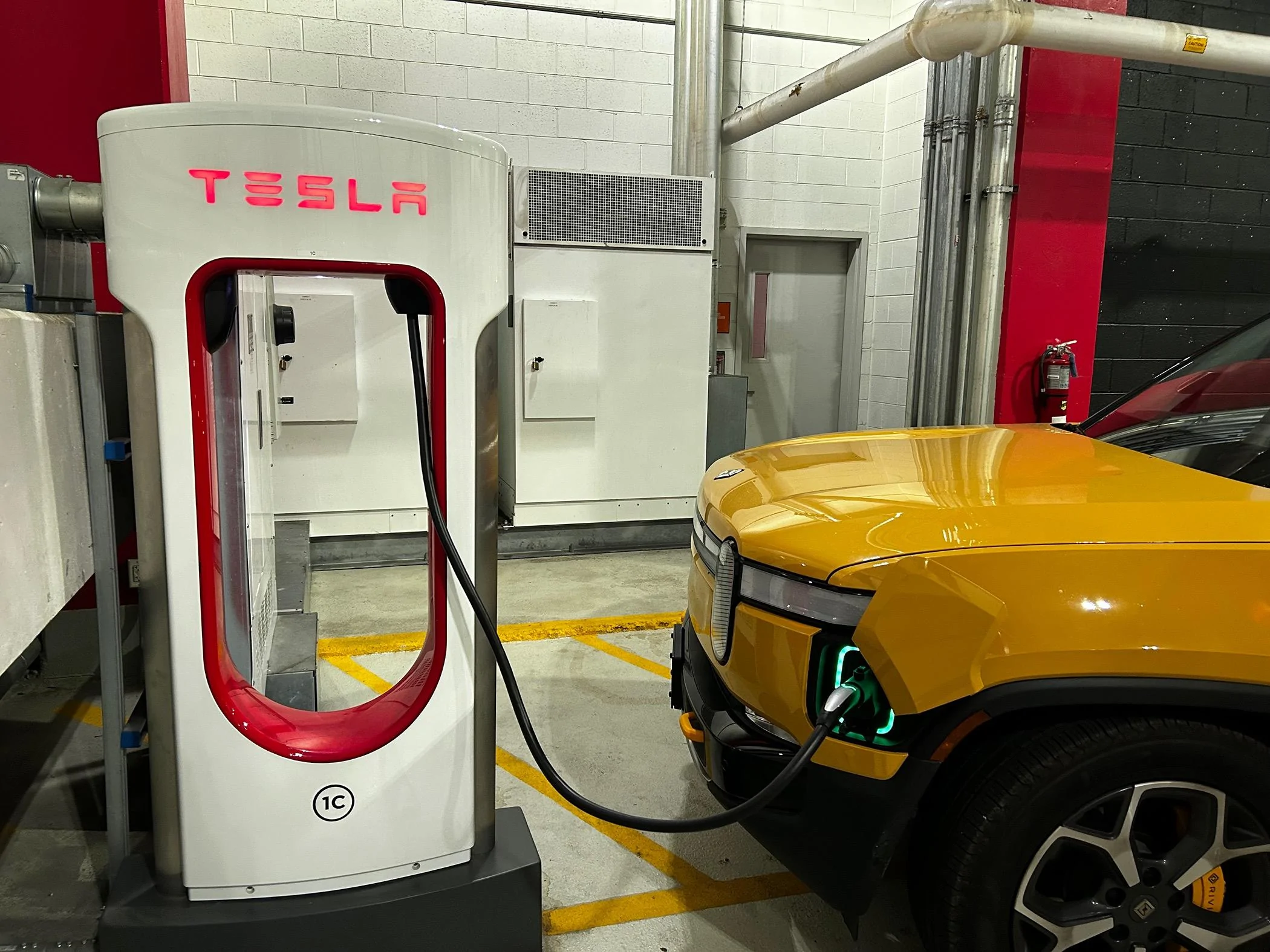

It's not so much the slider lock, it's the tight tolerance of the adapter until it's broken in with use. If the Supercharger plug isn't fully seated in the adapter, the slide lock will not be free to slide to the locked position—because the notch in the plug isn't lined up with the locking tab. Once the plug is fully seated, and notched lined up with locking tab, the switch is so easy to move that you'll be second guessing whether it move at all or moved enough. Furthermore, this slide lock is essentially a on/off switch. Without it being switched on (locked), it will not pass charge or comms between car and Supercharger (A2Z have said as much). This adapter is so precisely made (a hair too large than necessary) that even the CCS1 side puts up a small fight. You have to align and apply force in just the right direction... or wiggle it. The NACS side, by second and third use, it only took me one determined try to get the plug to seat fully. I've used it 4 times now.
Here's what I recommend to A2Z newbies:
  • Before you head out, look at the slider switch itself. Because the lock/open letterings are not color-filled, it can be difficult to see where the switch sits in either extremes. When fully engaged in either direction, the switch itself should cover up the words.
  • Take a small rubber mallet with you. Because, believe me, using a [malleable] tapping tool is a lot less painful than hitting the edges of the CCS1 end with your flesh and bone.
  • Upon arrival at the Supercharger, take a look at the plug. Observe the wear mark on it. You should see a clear line between warn and untarnished surface. This line will provide visual reference on whether the plug is seated.
  • If inserting NACS to adapter by hand and without aid of a mallet, slow and smooth is not the technique. A burst of force is the way.
  • At times, if enough force is used to tap/pop the adapter into place, that momentum will cause the slide lock to engage on its own. So if you go to slide the lock and it doesn't budge, and you can see the plug is fully seated, don't panic. This could be the reason and you're actually good-to-go.
  • Alternatively, instead of a mallet, you can try installing the adapter on the Rivian first. Then, the NACS plug into the A2Z. This will make your adapter a stationary target, and the Rivian a 7k+ lb bench vice, giving you better phyiscial/mechanical leverage on manipulating the NACS plug. If this is what you decide to do, reverse the steps once charging is complete. Coincidentally, this is the method Lectron recommends for their adapter. Their adapter will still pass charge even if the mechanical lock isn't engaged, but plug fully seated. That's what their recall was about. The A2Z lock is more than a mechanical lock, it's also a electronic fail-safe. If you slide to unlock during charging, charging will stop (but don't do it).
Thanks soooo much for this excellent explanation! JB
8,729
11,968
Well it worked but it took some muscle to get the adapter connected
Congrats. Subsequent attempts will get easier. Prior to my first attempt, I bought s00nish's 3D printed cap (CCS1 end) for sake of drop protection. While having difficulties getting the plug to seat, I realized the cap's larger flat surface area would hurt less and transfer force better. It did. So subsequent sessions, I kept the cap on when I give it a slap. I over-compensated on second session, slapped it hard enough where the slide lock engaged from momentum. Third session I dialed back the force, but forgot to check the slide lock. It wasn't locked, but started charging as soon as I moved it to the locked position (while still attached).
