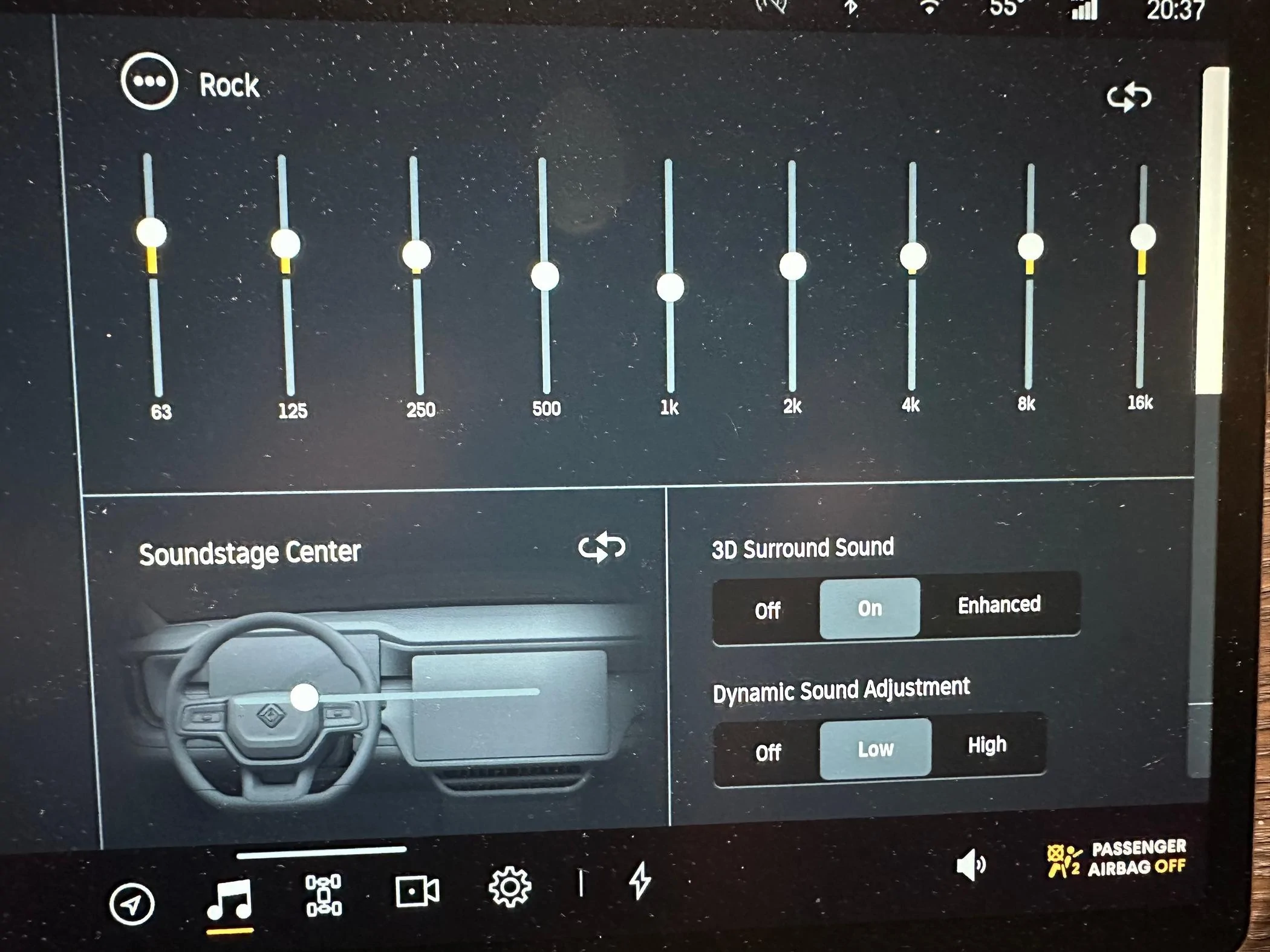

Interesting. I'll certainly give these a try, but I had to laugh since the tweaks are almost exactly opposite to what I've been using for the past year. I don't think I've noticed any of the rattles you mention in the doors, but I have an early 2023 build.
