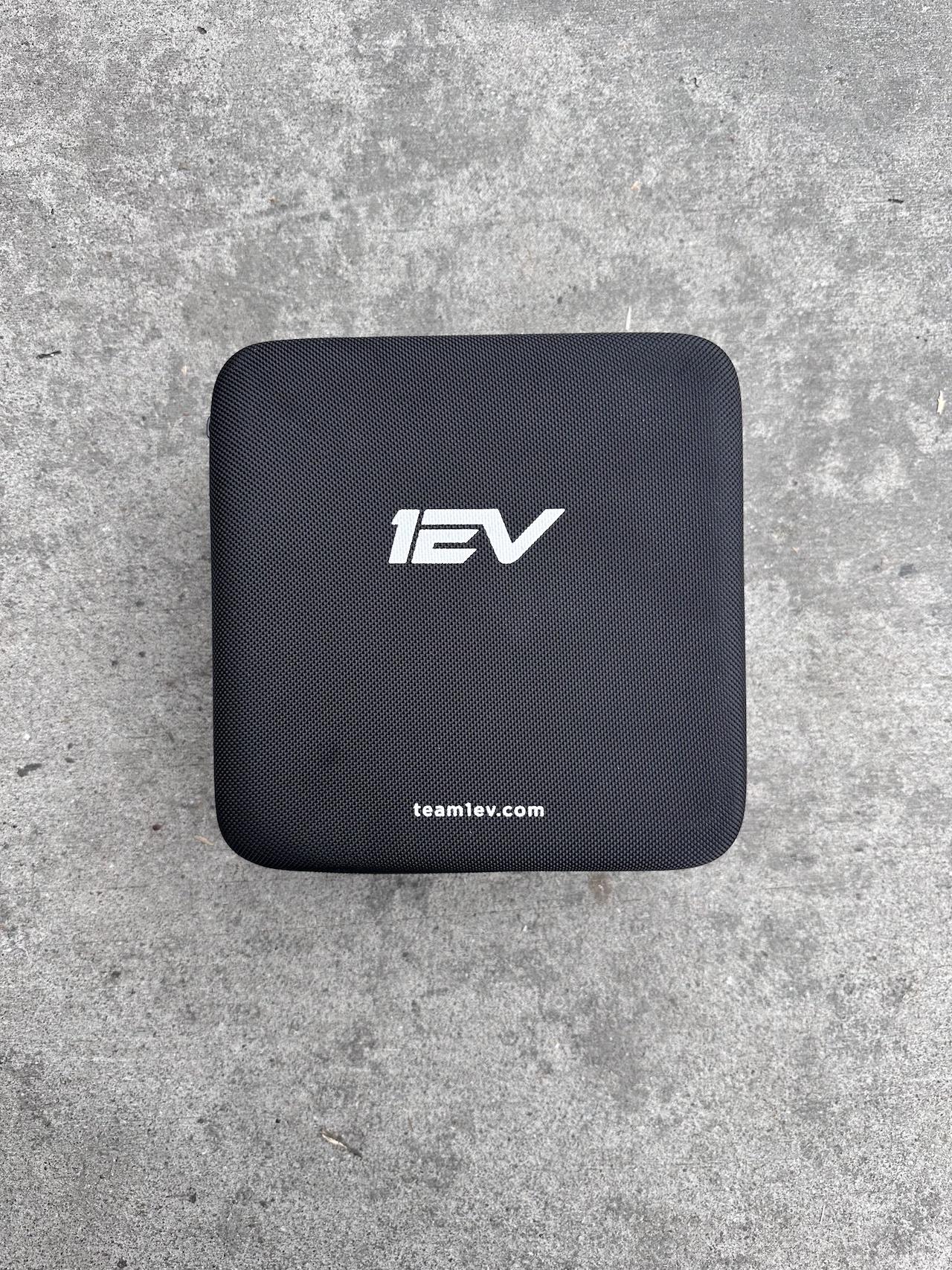

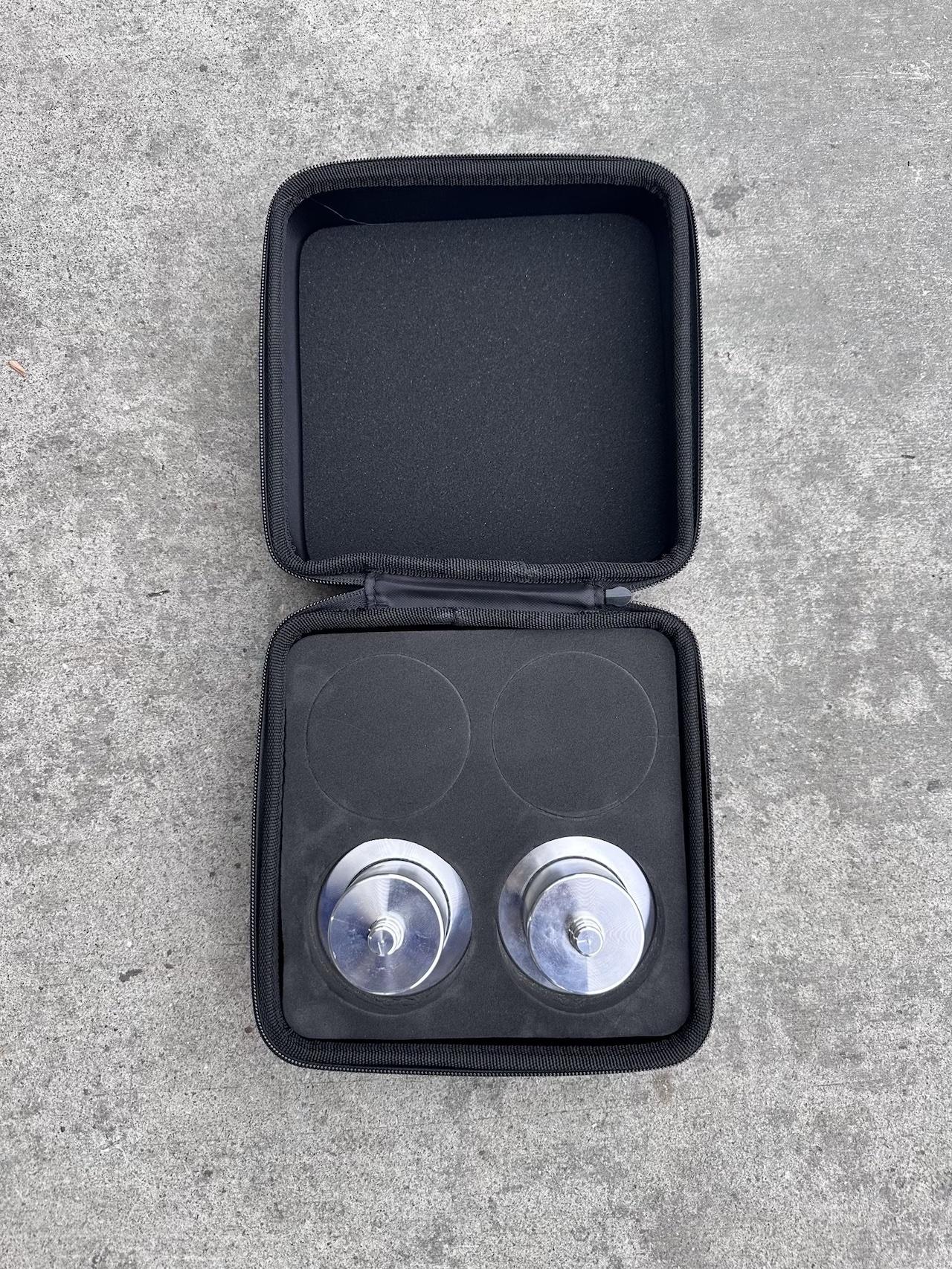

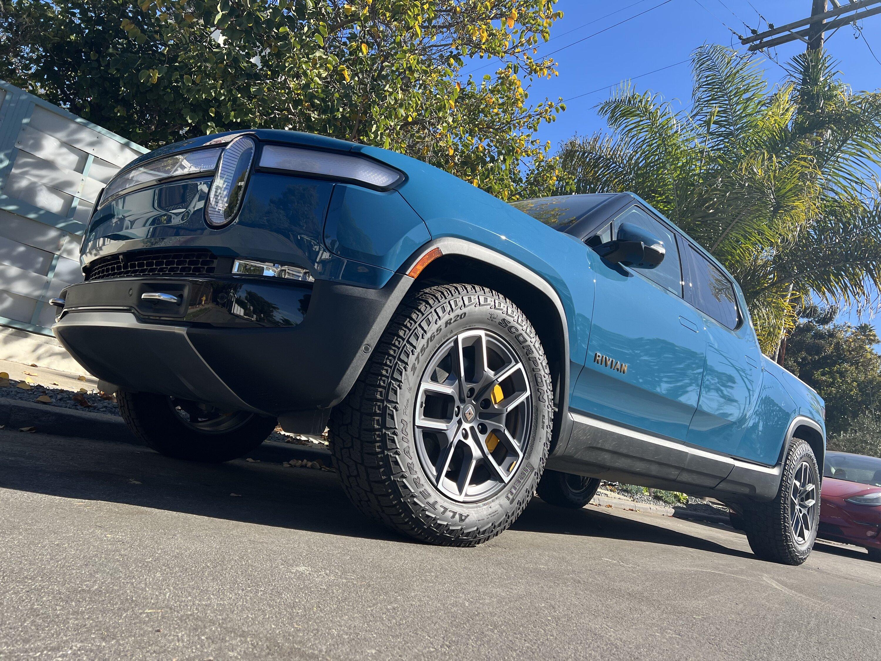

Got the 1EV pucks before I my wheels. Look solid. Should have bought a set of 4 for ease. ?‍♂?‍♂ Guess I gotta trade up!
@EV Sportline where are my 20" forged beadlocks?

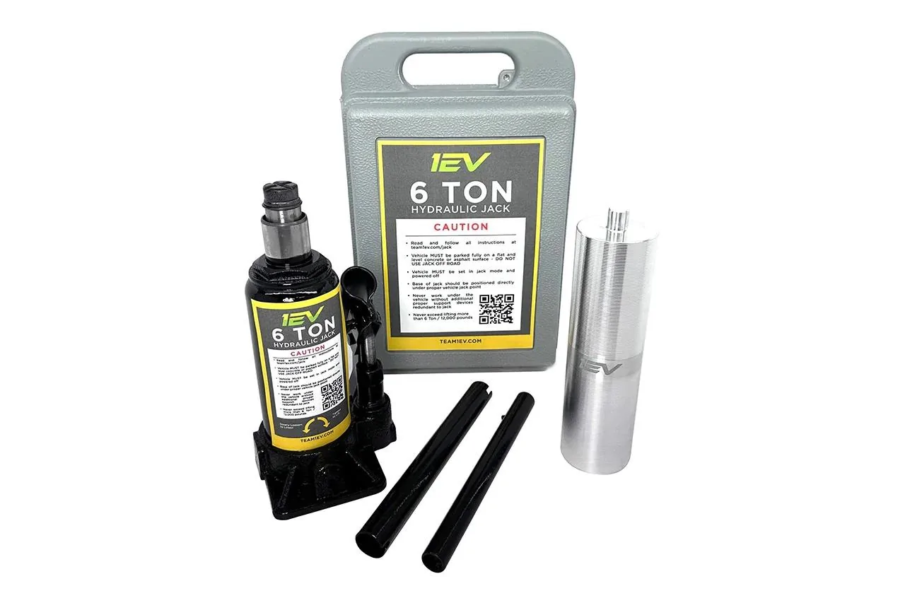

For those that need a complete jack solution, we created this Rivian Bottle Jack kit as well. Perfect for at home tire swaps, or to carry with you at all times for flat tires - it only weighs a little under 10lbs:
https://evsportline.com/collections...-aluminum-heavy-duty-lifting-jack-by-team-1ev
@EV Sportline ... are the bottle Jack kits shipping soon? I placed my order shortly after you announced the product... but nothing on when it's going to ship?
My R1T is coming s00n and I'd like to have the jack kit onboard from day 1.
Thanks....

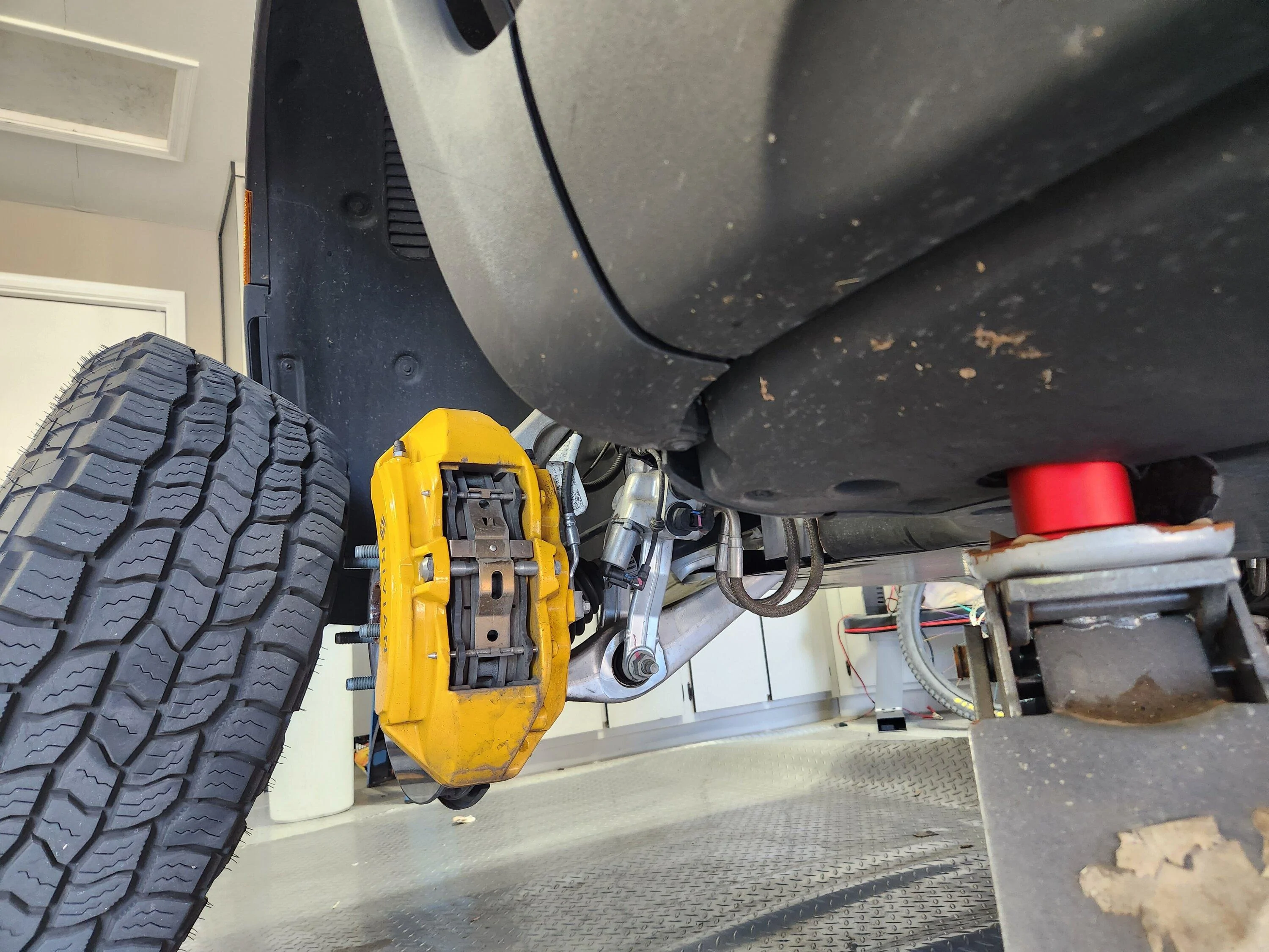

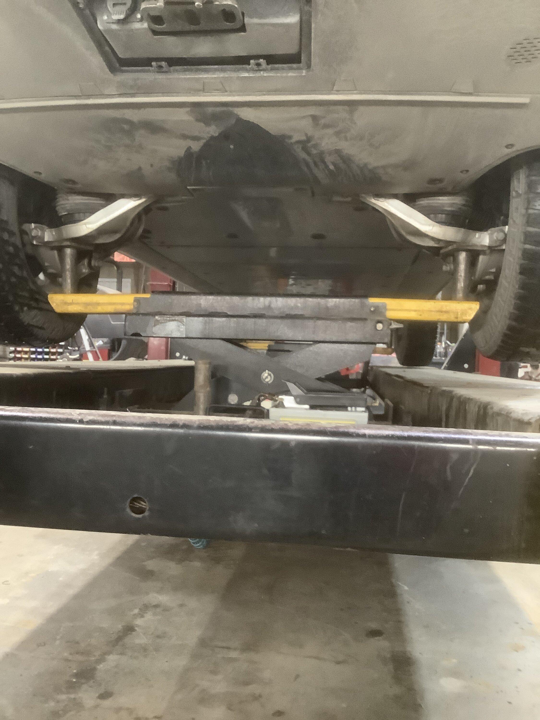

My tire changer lifted my car by the control arms.
Very stable.
That’s definitely an option. I’m not going to say I haven’t done it to get my truck onto jack stands. That said, the steep angle of the control arms and the proximity of the shock mount to the wheel makes it difficult for the home user to get a floor jack under there.
Thanks....
About that...well, we planned to air the jacks in, and you'd have the kit now...but you can't air a jack because the hydraulic oil is a no-no for cargo planes. So...? inbound! Should late Feb for ship. Thanks again!
Thanks gemmisa!
That's going to look amazing with the R800 Beadlocks - expecting yours to be done this week!
