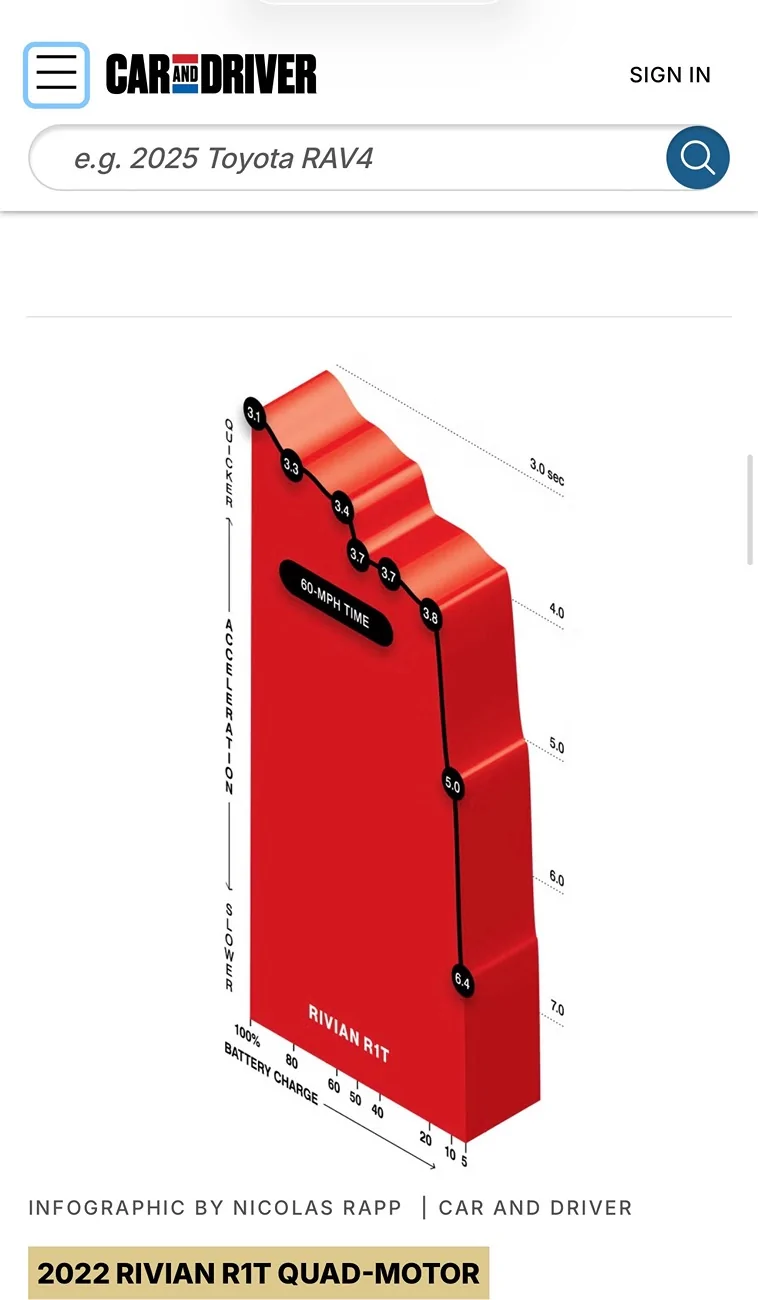

You guys should also post your SOC - from this car and driver article it makes a difference if you are anything less than 100%… maybe launch control negates that but would
be good to find out.

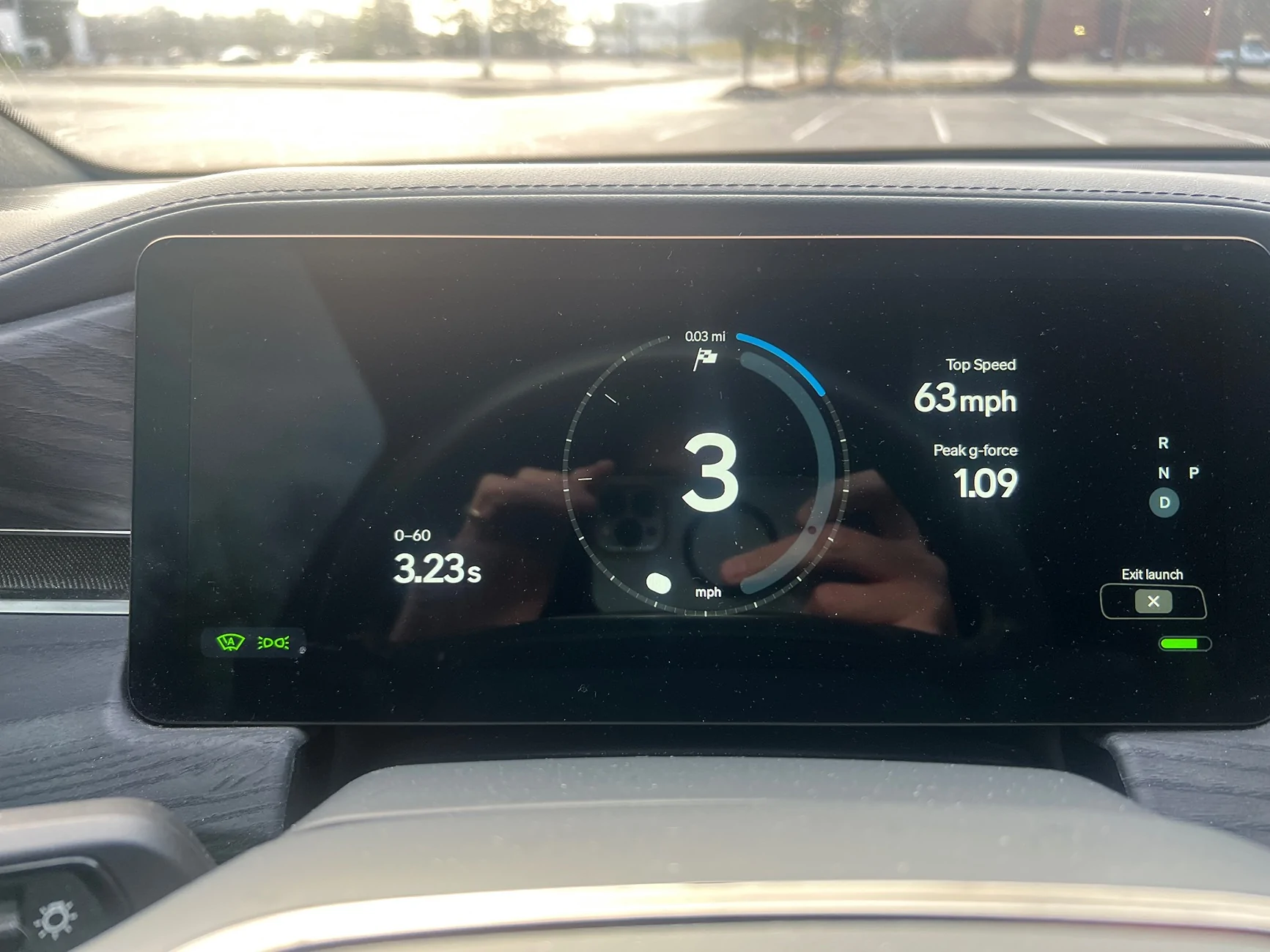

2023 R1S quad
SOC: 73%
Tires: 22” Continental terrain contact AT
Flat ground. Temp in the 40’s and no warm up if battery or motors.
0-60: 3.23
Max G: 1.09
Rivian R1T R1S Launch Mode - Times IMG_6450

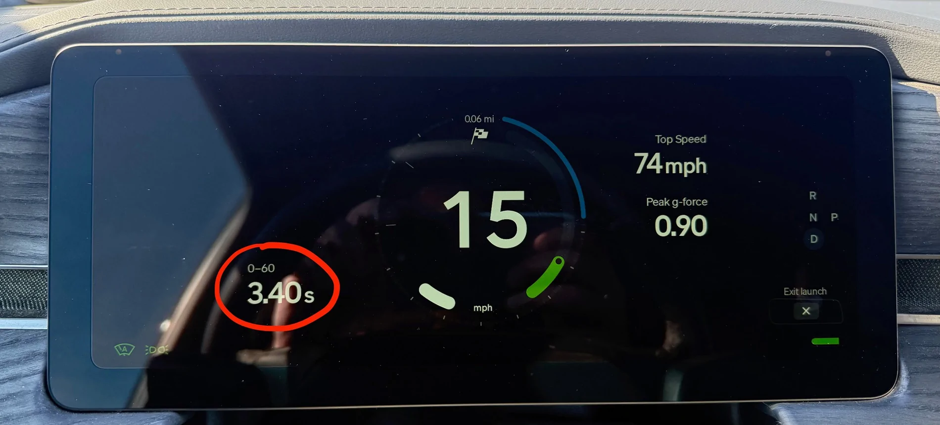

I got to play with Launch Mode for the first time today in my Gen 1 R1S quad... 3.40 seconds to 60 was the best time (got it twice) out of 11 runs. Gawd, I love this truck so freakin' much.
Edit: FWIW my OEM Pirelli Scorpion A/T tires on 20” rims have 8,619 miles.

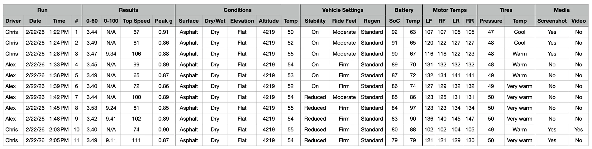

Rivian R1T R1S Launch Mode - Times Launch Mode data 2026-02-22
Rivian R1T R1S Launch Mode - Times 3.40 seconds to 60

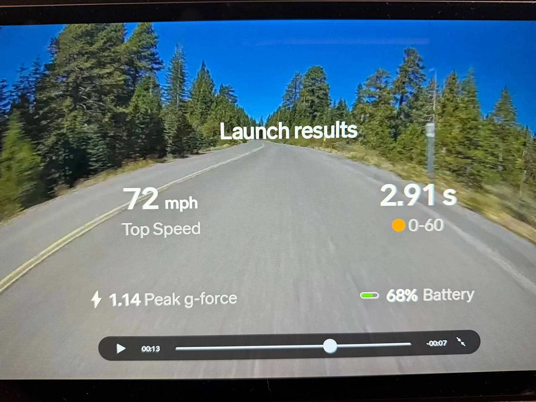

557
2023 R1T Quad
SOC: 85%
Tires: 20-inch G/Y Territory, 47-48 psi
Battery: 77F
Motors: 80-90F
Outside temp: 46F
Drive Mode: Low w/ traction control off
Road: Good asphalt, flat, no wind or slight tailwind given the time
Edit to add: This was my first attempt, gave it a go about a mile after leaving home on my way to the office, so tires were probably still relatively cold.
