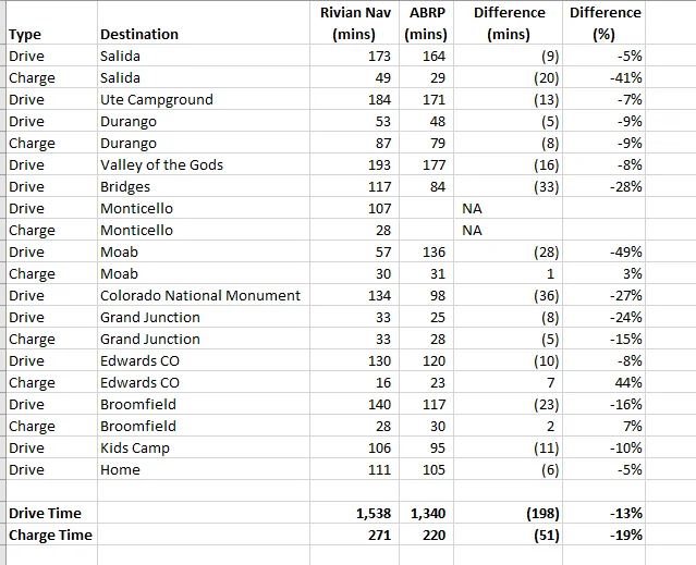

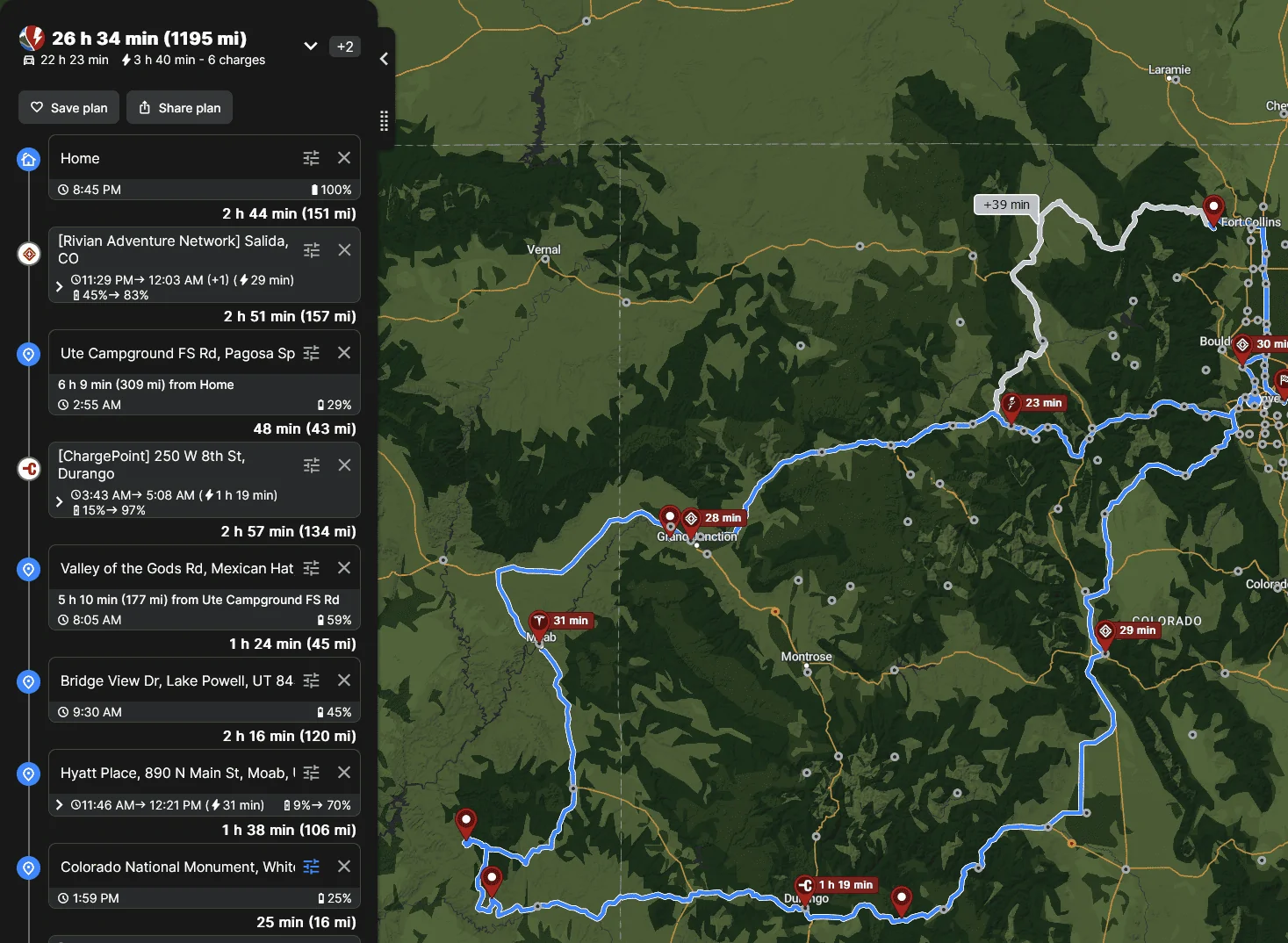

I'm planning out a multi-day camping trip this summer. I've mapped it out in both ABRP and Rivian Nav. I've done a enough trips that I have more confidence in the ABRP trip times. My trips in Rivian Nav do seem 10%-20% more conservative than my driving experience.
My quick-and-dirty spreadsheet shows that ABRP's time estimates are 13% faster for driving and 19% faster for charging. Rivian thinks I need a 28 minute stop in Monticello that ABRP thinks I can completely avoid.
I do appreciate a slightly conservative number in my nav, as it's better than the other way around. But I'm finding the conservatism to be more limiting than helpful on longer trips. I end up planning for more charging stops than needed.
Does anyone else think better charging time predictions should be on the Rivian roadmap?

*Rivian Nav numbers are calculated in Conserve mode, as the planning stops more closely resembled the ABRP stops.

What do you have your preferred arrival state of charge set for charging stops? I think the default in the Rivian is set fairly high which is going to waste a lot more time at charging stations. Lower it should fall in line.
The other issue is Rivian often has some charger speeds underrated
Good call to check. I have them set consistently between the apps.
Some differences I would understand. For example, chargers that split power between two pedestals could have some different assumptions.
But I don’t get the major difference in RAN performance assumptions. Rivian had me charging to 80% in Salida and ABRP has me charging to 83%. This is the first leg of the trip, so starting assumptions are all the same. ABRP thinks it will take 29 minutes and Rivian thinks it will take 49. That’s a pretty massive gap.
